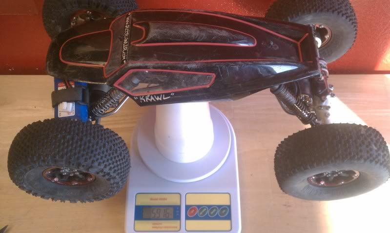

My mistake. I thought your scale in this pic was reading 5.9 lbs but it must be 5lbs 9oz.
Still... your build is inspiring to the rest of us who just can't seem to get sub 5 pound trucks to work worth a darn. "thumbsup"
Re: Krawl's "SECRET AGENT"
after checking again
you are right and I was mistaken...this scale reads different than my large scale.
5.9lbs
That picture has an slw and a Dh on it.
6lbs with the Dh combo and 5lbs 11 oz with my slw setup.

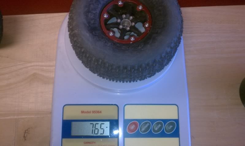

How much per side 1 or 2 oz?
What's your total wheel, tire, foam, weight on the rear with weights included?
I am at 6.7 oz with my Khaos setup, so I guess I will just add 1 oz to mine and be at 7.7 oz
