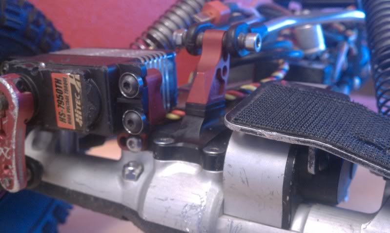

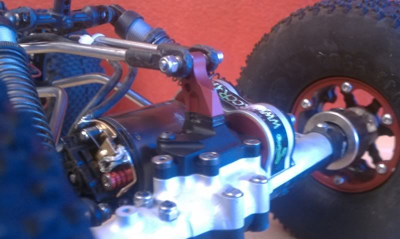

Looks like two pieces of 1/16" delrin stacked to make a 1/8" spacer. Al would be nice. "thumbsup"
Re: Krawl's "SECRET AGENT"
Spacers look good! Looking forward to seeing your servo mount, unless it really is only for scrap . . . Do it . . . you know you want to.

correct
....it really is scrap:mrgreen:

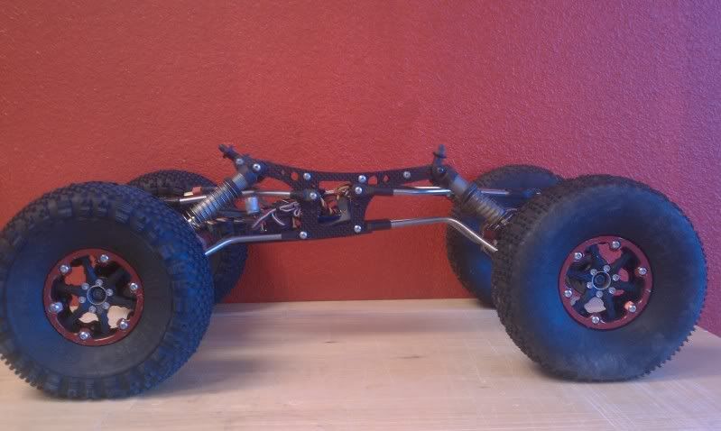

nice upper links angles at 3.25"
Rear uppers don't hit the rear body mount when compressed?
What do you think about moving the 2 center cross braces down to where the upper links mount to the chassis for strength?
they will touch at the very end of the downward travel but that is not a concern... there is enough travel for driving and articulation without getting close.
if it was an issue for you a slight rotation of the bent upper links would eliminate it"thumbsup"
you could move them to the upper link mounts but i dont think it would add any more rigidity than it has now.
Cool, I was'nt really concerned with the chassis rigidity as much as the material around the link hole, not saying it's an issue just curious that's all.

there have been no issues with any of the carbon fiber chassis as far as the holes. that goes for the mini,2.2,and the supers.
originally all the holes wer slightly undersized but i have opened up the tolerances to be a little easier to build"thumbsup"

Good to know. I never had any issues with my 4.2, but I ran cross braces at all the links and shocks.
Now go ahead and tell us about the foams and slw weights. :mrgreen:
there are the 3 braces in the middle, and the other two run between your shocks.
I will probably run XR body mounts between the shocks like you did, move the 2 center ones down to the links to lower COG :mrgreen:, and leave the fifth one out unless it feels needed.
the one in the rear before the shocks is needed..
you guys are killin me with the cog crap
you are gonna move a gram down 1/4 inch?:lmao:
just f'in with ya! make sure you have at least (5) spans across the chassis"thumbsup"

Yeah I was kidding about the cog stuff, hence the :mrgreen:.
I will put them all in, are you using alum hardware anywhere?
Are you having good luck with the XR body mounts? I noticed they will have to be cut down a bit to be the same length as the other braces. I got the Gunnar posts for the XR mounts because I hate losing body pins.

everything in the chassis is aluminum.
the xr mounts need a slight trim to fit.
Cool, I put alum hardware in my BJ, but not any of the load bearing spots like links and shocks for fear of bending or breaking, may give it a go this time.

I know you have always said you care more about where the weight is on a rig than what the rig weighs. It's good to see you haven't turned this into a "weight weenie" build.
Your videos prove that a (near) 6lb truck can still outperform most. "thumbsup" Nicely done.
Thanks harvo.
The truck is 5 lbs 11oz with my slw setup rtr with a 900 battery.
I could very easily drop the truck down to 5 lb range but I just can't bring myself to do it.
The fact is every light setup has had the same issue for me...
They are very finiky in situations where they shouldn't be.
They make some of the easier lines for a "heavy" truck very time consuming
And they have yet to undoubtedly prove they can out perform a heavier truck in more than
Just one very specific instance that will most likely never be in a comp. And if you think there are more than one you need a better driver.:lmao:
We spend all this time and money to build/buy the most indestructible parts we can and then are afraid of a little weight. (usually less than half a pound)
It just doesn't make sence to me.
