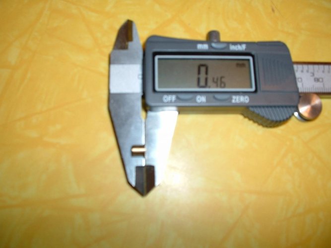

I purchased another set of 0 degree knuckles from RC4WD to have a back up set up for worlds.
The bushings are way too short.
The ear on the knuckle is 5mm.
The boss on the bushing is only 4.75mm.
Interference.
They responded quickly to my email and asked for some pics.
I hope they go measure their stock.
I know of one other set purchased and the bushings were the same.

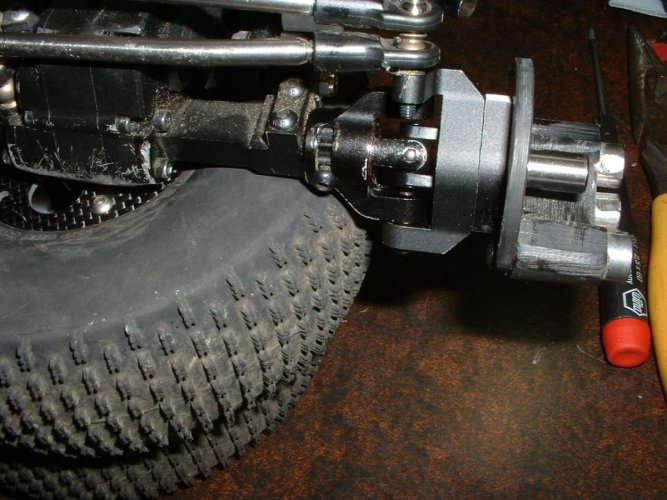

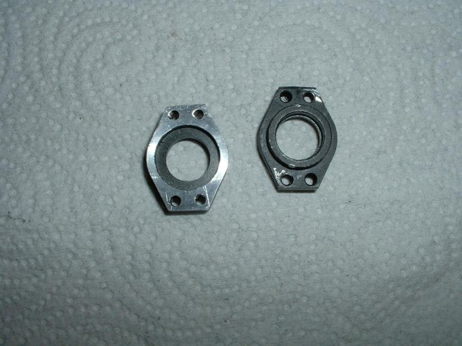

Their is not any front replacement CVD's in stock so I had to come up with something else quick.
My friend Bob come up with a great idea to move the outer bearing out to make room inside for the truggy axles.
Cut down some knuckles to bolt to another set. Drilled out the C's and removed the bearings behind them.
Also I plunge milled the inside of the knuckle down 1.1 mm for the bearing to move in. Made a bushing to use the smaller outside bearing on the inside. 16 od 12 id 2.4 thick. This got the u joint pins lined up with the king pin.

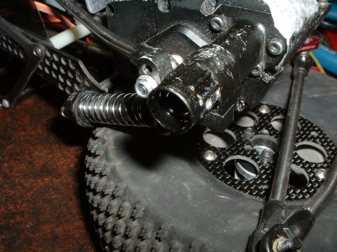

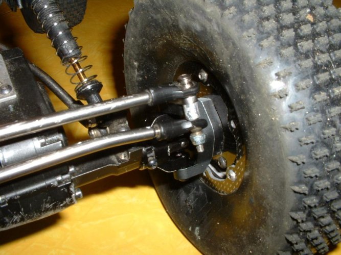

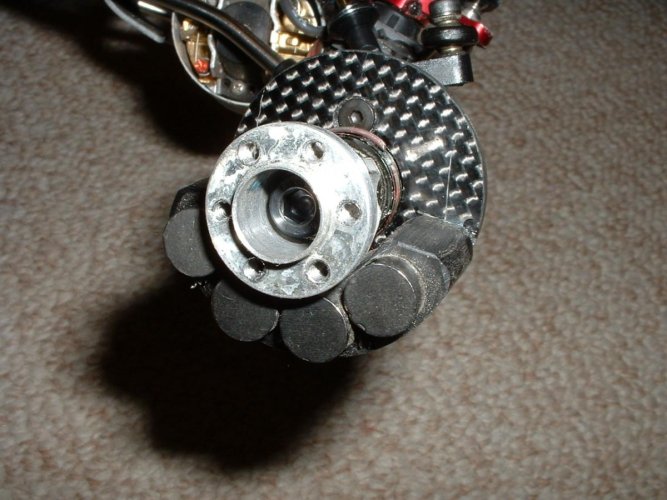

Got the hubs figured out.
Used bully 1 hexes and Vanquish .725 hubs.
I don't like the Orings that retain the pins.
Clipped Tmaxx springs to make a snap ring.
5mm cap screws to hold the wheels on like the bully 1 V6 axles.

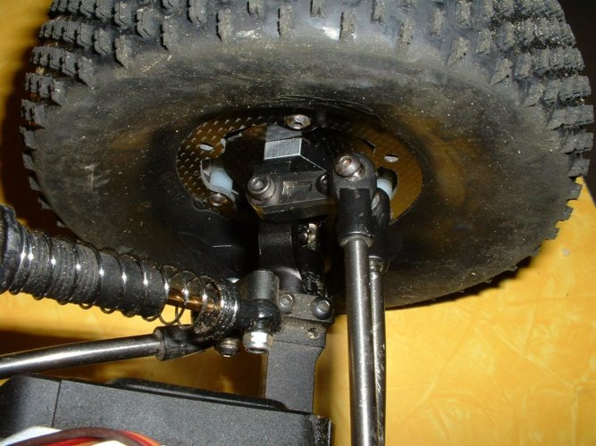

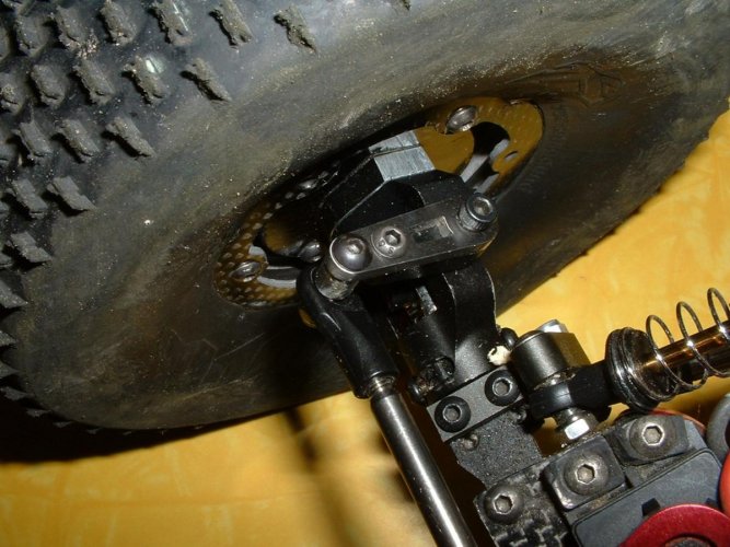

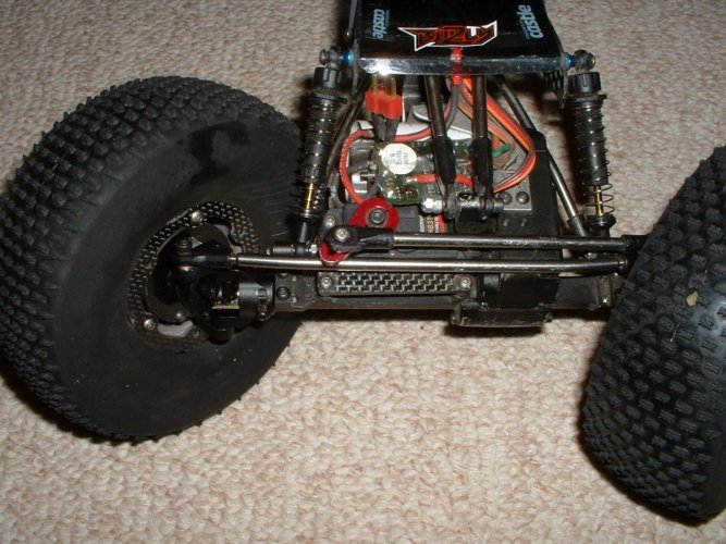

The steering is a little stronger now even though the new axles took care of the stalling. Added some arm extensions that Rowdy sent me. Thanks Chris.
