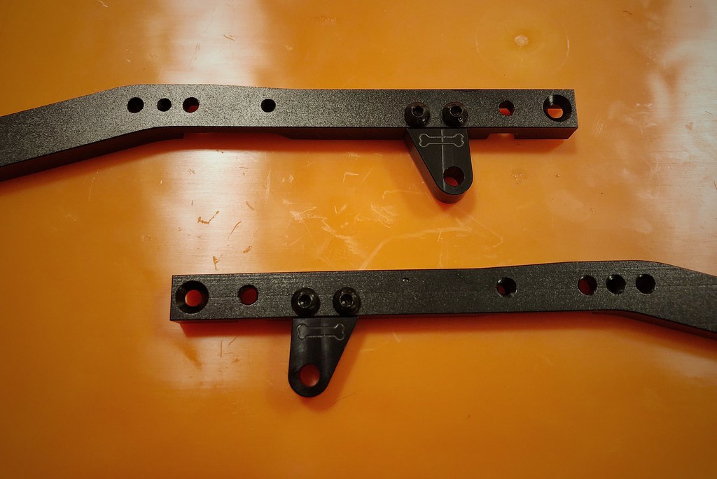

That research I mentioned before also brought the rear leaf shackle mount issue to my attention. Being the attentive fellow that I am, I picked up (and installed!) the BowHouse RC rear leaf shackle mounts. While I was in a shackle state of mind, I also picked up (and installed!) the RC4WD reverse mount spring hanger for the front leafs. Why? Because it's my tiny truck and I get to pick which scale details drive me crazy.
RC4WD Trail Finder 2 Hilux Build by johnny anguish, on Flickr

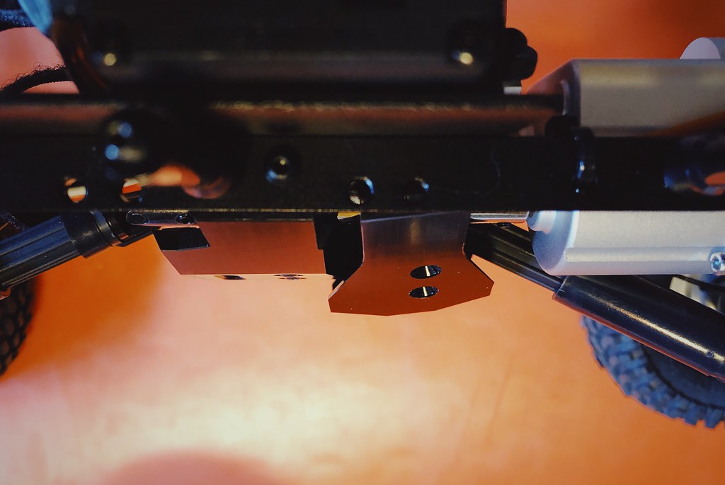

The next thing to address (based on research!) was the land anchor... err skidplate. I know there are a bunch of alternatives out there. In this case I went with the RC4WD Low Profile Delrin Skid Plate, and boy am I glad I did. Just look how happy it is!

Here's a picture of Happy Skidface all nestled into the frame rails. Nice and snug. So cozy. Wait, how does the transfer case mount? Two screws through where? I'll spare you the picture from below...

The new happy face high clearance skidplate would be a lot nicer and stronger if the tcase mounting holes were countersunk instead of counter bored, wth?
