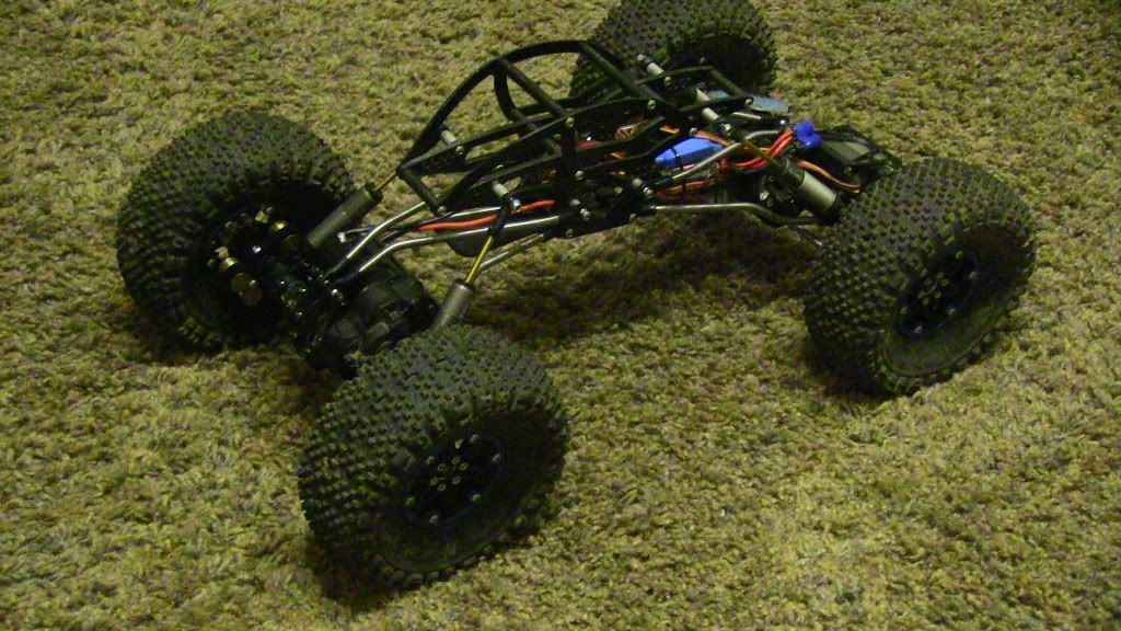

Gotcha...I'd definitely add a cross brace between those...this chassis flexes quite bit where the rear shocks mount. Axial makes a spacer that fits...I added one to Limited77's rig a while back and it took most of the flex out.
Just pick your rig up and twist the rear axle to full compression in either direction and watch the chassis plates flex...
That is a really good idea... I will have to try that thanks "thumbsup"
