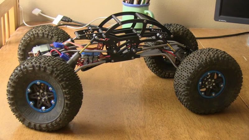

cant figure out which code to use on here so i hope this works, feel free to give feedback if theres anything you would do to make this a better setup thanks Jeremy :mrgreen:
- Brood 45T Limited Edition Motors
- Dual Mamba Micro Pros
- CC 10A BEC
- Thunder Power 730 mah 25C 3s Lipo x2
- Turnigy 959 MG servo
- VP SLW V6 wheels all around
- Losi Boss Claws
- VP Blue Aluminum Knuckles
- VP Knuckle Weights
- VP Servo Armor
- BWD "The Thing" chassis
- Chaotic Crawlers custom Titanium links
- Stock Axial Shocks
- RC4WD Internal Springs
- BWD Motor Savers
- Rowdy Racing Battery Mount
- Chaotic Crawlers Steering Tierod
- Sven Rear Lockout weight Holders
- VP .5 bullets for the lockout holders
- Axial Machined gears in the rear
- Axial Machined Top and Final gear up front
- Full Force RC Bearings

Looks great, could use some deans plugs and body panels tho :mrgreen:
I recommend that you outboard the rear shocks at the chassis, it helps with sidehillin and overall stability. "thumbsup"

They are outboard of the chassis...not sure what you're talking about...
Sorry should have been more clear :oops:. By outboarding the shocks I meant adding an additional spacer where the shock attaches to the chassis.
I used a traxxas ball end which is about 7mm wide, in doing this you will also need a longer screws i used a 3x30mm button head
Not the best picture, but you get the idea
Re: my first xr10
Gotcha...I'd definitely add a cross brace between those...this chassis flexes quite bit where the rear shocks mount. Axial makes a spacer that fits...I added one to Limited77's rig a while back and it took most of the flex out.
Just pick your rig up and twist the rear axle to full compression in either direction and watch the chassis plates flex...
