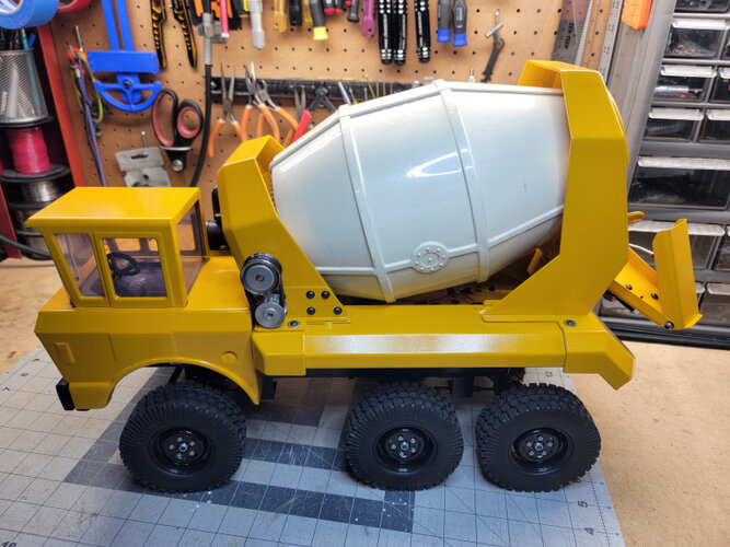

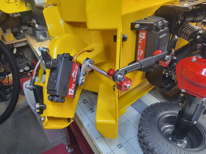

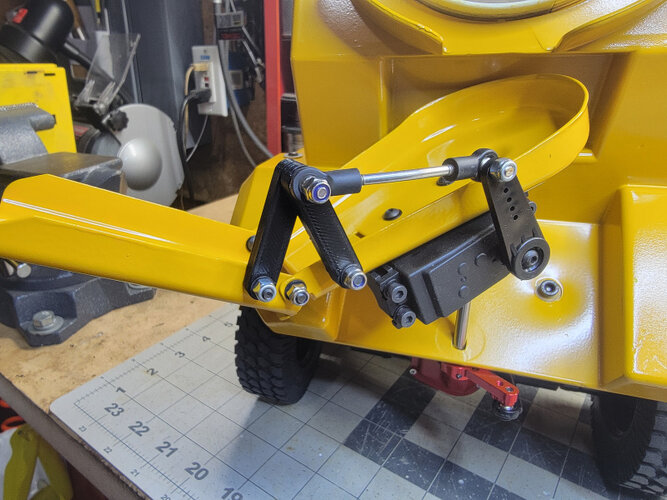

Finished another conversion. The mighty mixer. This one was pretty straightforward with the exception of the drivetrain. Given the very short wheelbase I couldn't fit a standard central transmission with outputs to the front and middle axles. So I attached a small transmission directly to the middle axle. It is working fine. And the suspension is a crazy setup that works OK but I wouldn't do this on anything that needs consistent flex.

That's awesome does the transfer case provide overdrive for the front axle?
change the pinion gears.

The axles I used are some cheap scx10 knockoffs I found on ebay. Width was about right. The transmission was also a cheap lcg one from ebay: LCG Chassis Transmission Gearbox W/ Steel Gear For 1/10 SCX10 Rc Crawler | eBay
To do the body I have a media cabinet from Harbor freight I use. Not sure about the media but it is a fine grain aluminum oxide.

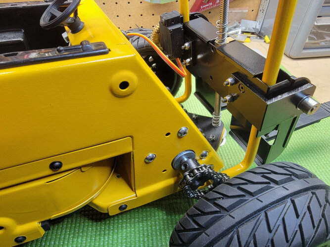

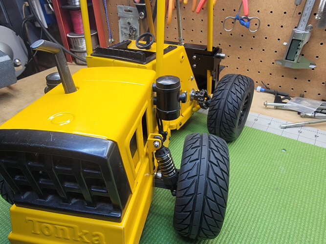

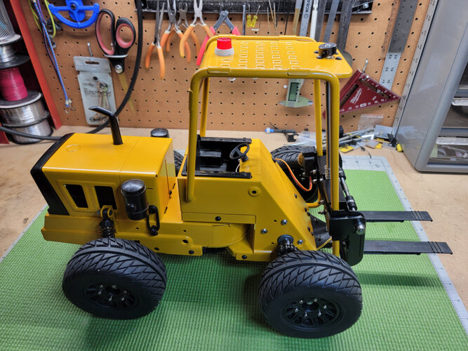

Had another conversion I was working in the background. A forklift. This one was a challenge because I needed to fit a lot of electronics in a pretty small space. Everything fit with some room to spare.
it came out fine with one regret. The forks at the lowest setting aren't quite flat to the ground. I may look at options to make that happen but for now I'm happy with the overall result.

Yo! That's awesome! I'm not so fond of the forklift tires and wheel howeverz. Opinions, I know, like buttholes.

I just watched the video of the forklift, and it's awesome that the tines can spread and come together!

As for the tire/wheel combo on the forklift I'm not really a fan so they will do for now.
