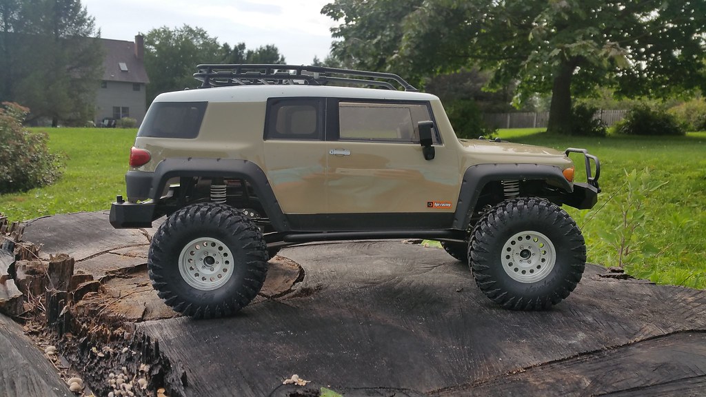

The Berserkers next to the stockers. Hmm I didn't gain much if any height with these like I had wanted. But they look damn good IMO.

The only thing I don't like about these tires is I guess the foam they come with. It seems like it is too big. When mounted up they look like ATV tires. Way too rounded across the tread. If you look at the pic you took of the unmounted tire the tread is more square to the sidewall and flat across the tread surface, much more like a truck tire. This also is what turns me off the VS4-10 tires. They do the same thing. I had the same issue with my Braven Ironsides. Foam was way too big for the tire and ballooned it out when mounted.
Well they are UTV tires so...
I understand what you're saying, but the only way to get a flat tire profile is to make the foams too small or too soft or too use closed cell in which case they're rock hard.
