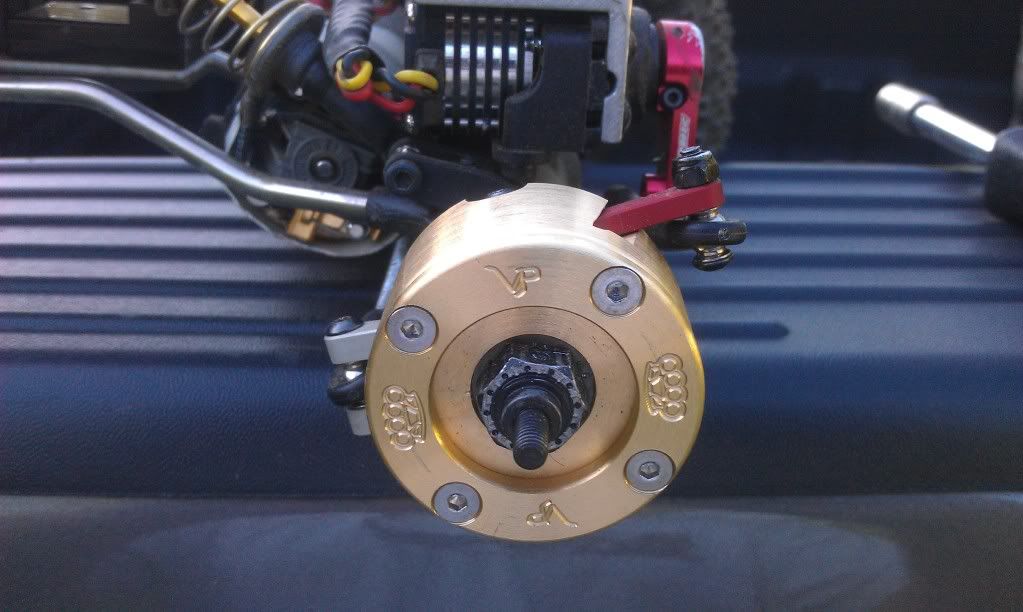

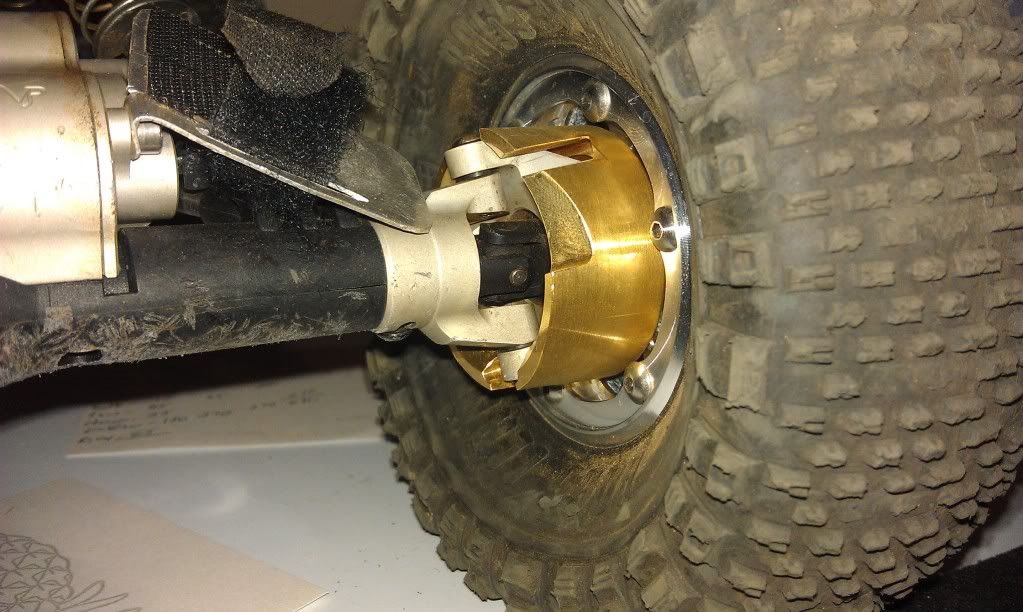

Just a quick edit...I picked up the VP knuckle weights along with some 585 hubs. I also got one set of additional rings, but since they don't fit with the 585's I'll be ordering some of rob_b's half size spacers with hopes that they will provide the spacing I need to be able to run the extra rings with the DH2's. I have also been busy building another rig (berg) for the fun of it and for my wife to comp with as well as a "loaner" rig for when we have guests at our comps. The last rig I picked up in the process of gathering the parts I wanted was from jeepindoug. It had all sorts of goodies on it that he makes. I really like these titanium ferrules he made so I pulled the 4 from the axle ends on the berg and put them at the chassis ends of the lowers on my XR...now the transition is nice and smooth!
I have also picked up a set of the Ti shafts for the front and rear gears as well as a VP upper link mount for the front axle and a VP servo guard and even a pair of aluminum shock caps. I've been beating on the RC4WD gears for a while now and haven't had any issues. While I had it apart to put the shafts and the upper link mount on I checked all of the gears and found that none of them showed any excessive wear.
I'll be screwing around with the front upper link mount to see where I want my links mounted, but other than that I'm really happy with where this rig is at. I'm also gonna try to make some discs for the SLW's similar to what CI offers for the DH2's and I am currently running in the front. If I can pull off what I'm thinking I'll switch over to SLW's all the way around and probably move all of the weight out of the wheels and onto the knuckle weights.

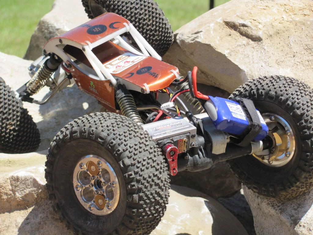

Since we all like pictures...here's a recent one...but without the VP upper link mount or the servo guard...
Thanks! "thumbsup" The BJV4 is definitely a good chassis...it has always been really stable for me. The biggest downsides I fight with are the breakover and rollover recovery it provides. The lower links are further apart front to back than chassis like the T1E. I'll admit I do run a Rockshow SS on my berg...I wanted to compare the two side by side...although I know it's not a great comparison being that one is an XR and one is a berg, but I can say that the SS does take care of the breakover and rollover problems. I'm still working on getting it to be as stable as my BJV4 is though...
