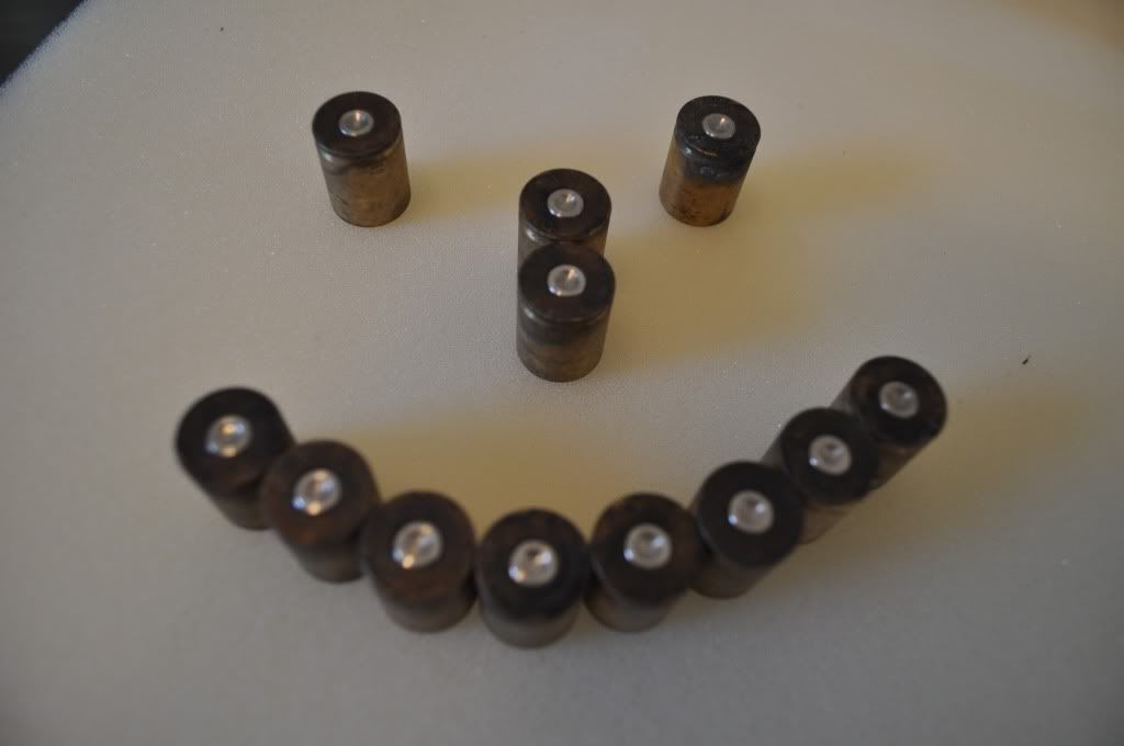

The slugs were a little dirty when I got em...

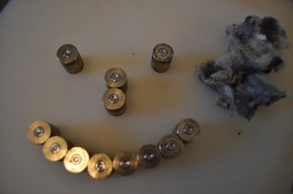

After a little Nevr Dull and some elbow grease...

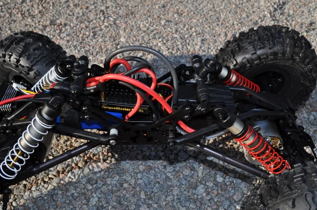

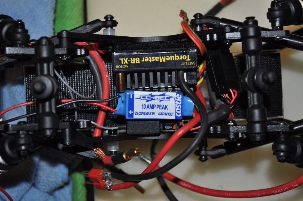

Then the last couple days I've been working on cleaning things up a bit. I removed the stock electronics tray and made up a polycarbonate tray to hold everything and also allowed me to remove the battery holder too.
Excuse the wiring...I've got things cobbled up for the time being since I'm short one ESC and still wanna crawl. I've been running without dig for the last week.

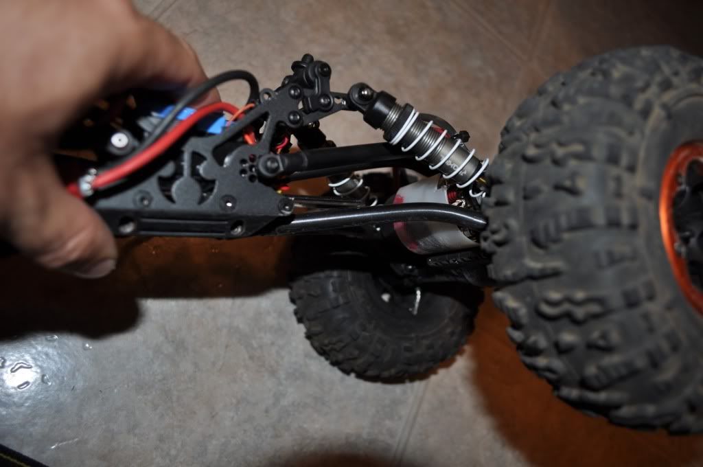

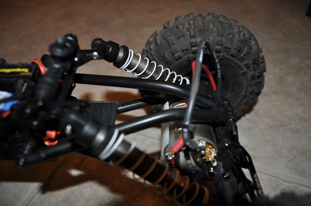

I think you got your chassis backwards....... It's not symmetrical...
No, it's backwards, the short side is the front of the chassis, he has it backwards, on his truck the delrin links are on the rear, and that is the short (front) of the chassis
WOW...never noticed that...I'll get busy swapping it around. Thanks and for those of you that didn't believe it either check this out:
"Now it’s time to start assembling the chassis. Open Bag “H” and grab the required chassis components for this step. Build your front shock ears per the instructions and set them aside for now. Meanwhile, assemble the rear shock ears and attach them to the chassis plates. Take note that the chassis is not symmetrical."
That's taken directly from the axial site (http://axialracing.com/wordpress/2010/08/30/xr10-build-part-4-chassis-assembly/). You can see that they have mounted the battery tray on what is the front of the chassis and if you compare the areas that the shock mounts attach to front and rear there is most certainly a difference!
THANKS DRAGRCR!!!
Cool, at least it will be right now lol, I was looking at your pics, and I knew something was wrong but it literally took 5 min. For me to catch it.
Now I'm just curious to see what difference it will make...just waiting on my esc to show up...hopefully today!
Well the second ESC came back and set things straight...everything is back to working correctly. I had a visit from the brown truck today too...

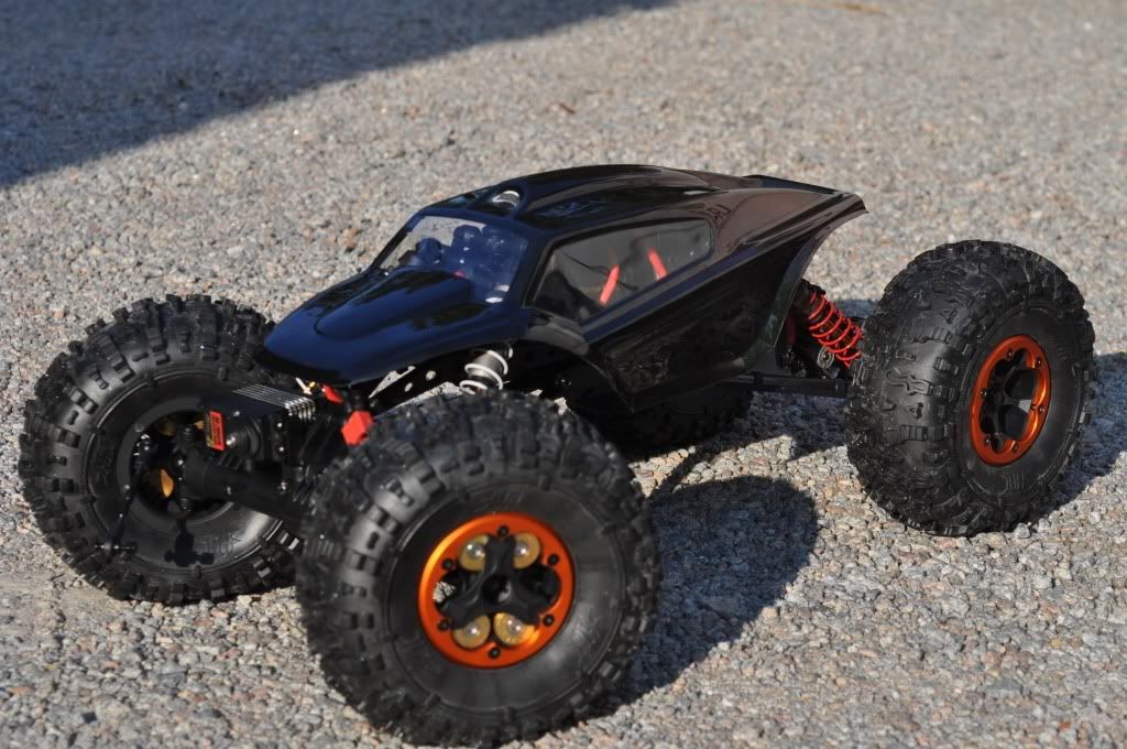

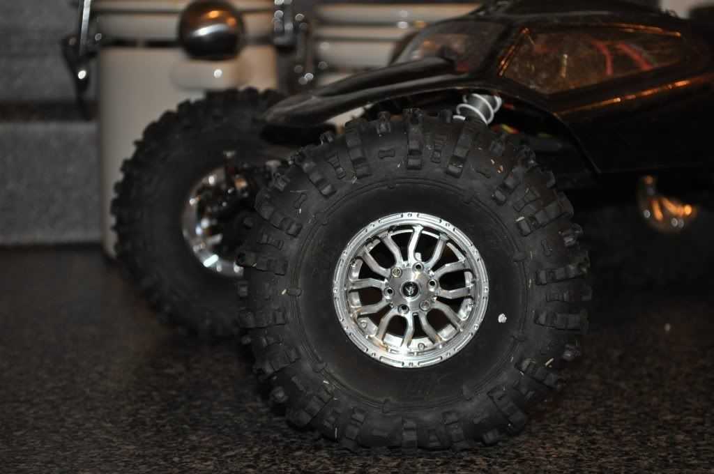

I'm really impressed and happy with the wheels. Now I'll be able to spend more time tuning the rig and messing with foams and weight. I was holding off on messing with the foams until I settled on which wheels I wanted. What you see are the SSZ-11 in raw finish with 350 hubs all around. Currently I have the full 5.5 Nova DD with firm inners and soft outers on the front and soft inners and memory outers in the rear. I also picked up a racers edge servo horn and some servo clamps

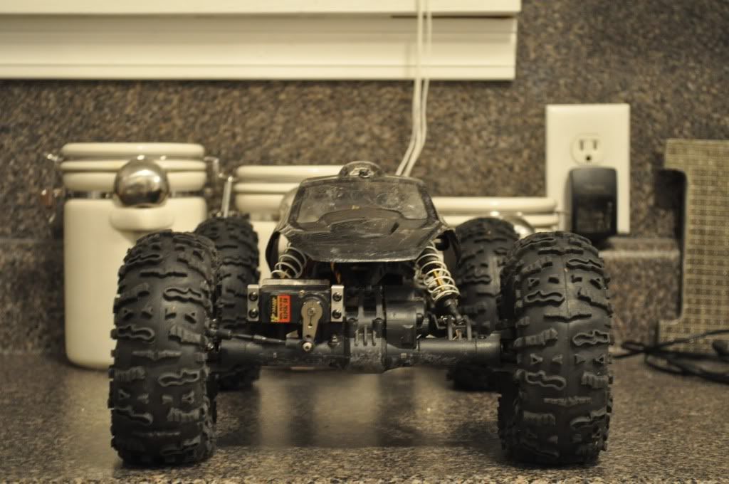

I measured the width with the new wheels and as it sits now the front is right at 10 7/8" and the rear is right around 10 1/4" maybe a little less
I also realized I got in a hurry and threw the drag link on the outside of the servo horn and need to change it back around.
I'm also moving the rear shocks out on the axle mounts using a spare rod end ball and a M3 x 25mm button head screws...the ball will just take the place of the shock between the tabs on the axle.
while I had things apart assembling the wheels I removed the rear axle and tore it down to check the bearings and gears. All of the bearings are in good shape (i used Avid bearings in the tranny) and the gears are not showing any signs of wear. I cleaned everything up and applied another coat of grease before sealing it back up.
Yeah turning the chassis back around helped the rear upper links clear the electronics box and fixed the problem I was having trying to get the rear of the chassis to be higher than the front...those are just the two most obvious changes.
