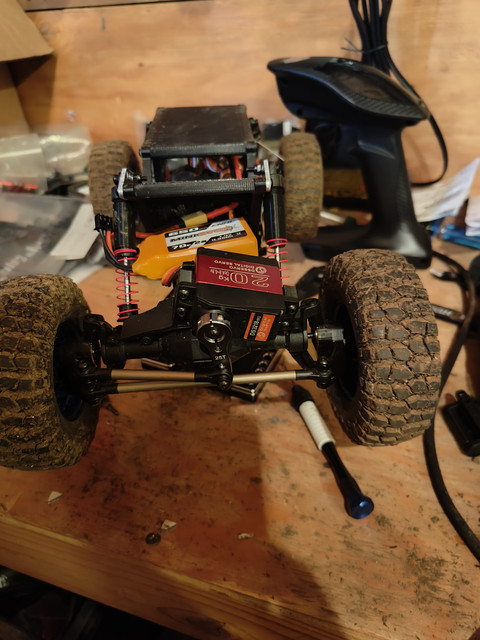

Yes finished tossing this rig together earlier in the week.
Axial steering link kit
Two tie rods for lower rear links and factory rear lower links as rear upper links
Cheap brass knuckles and rear portal boxes
Etsy conversion kit to use mini T springs on stock shocks
Class 0 BFG krawlers
Treal adjustable link raiser
Amazon red 20kg servo
Axial OD gears
That's about it so far. I have a couple other plans for it. Want to add dlux UD gears make some body panels and install the new fusion mini 16 motor.
Motor is marketed for the utb18, tires are a tad bigger than stock at 3.85" believe stock are 3.65" if anything I would be more worried about the transmission gears.
