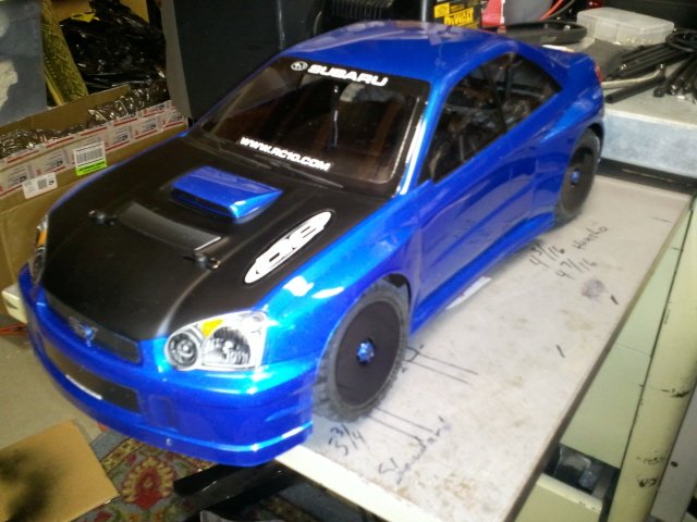

Quick shot from last nights paint session. Nothing special since I hear they get pretty worked. Oh, and thanks a ton Ty I'll get ya Saturday, and also Rodney for being USPS for me."thumbsup" Also took a cue from Van with his overshell, I dug out my old comp Stagekilla body and works perfect.
