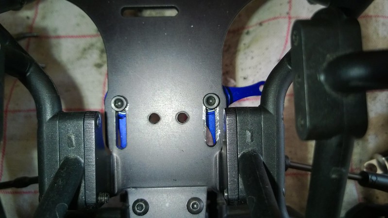

I have a trouble with your new holes for the TRA3743A.
Yes we can adjust but the screw slide in the hole... If I lock it harder It will not be totally free to turn, and with vibrations it's will not stay locked
sorry for my poor english I don't know if you see what i mean ...
I'll make a picture if need and try to find an solution
IMO : At start you have only a tiny hole so head screw cannot slide along the plate, but now you have long hole, i think the best is to make many holes to keep allowing different setup

cool i will take another look at the multi-hole setup option. however you should be able to tighten everything down very well with the slots...:???::???::???: and the slot will give you more adjustability.
What do you means by slots ?
I use the black washer (i have only 2 of them and you have 4 on your pictures)
There some pics of the issue :
My solution (idk yet if it's good in long time)
I try to tigh but nearly destroy a ball bearing :shock: (not good quality ball bearing btw...)
