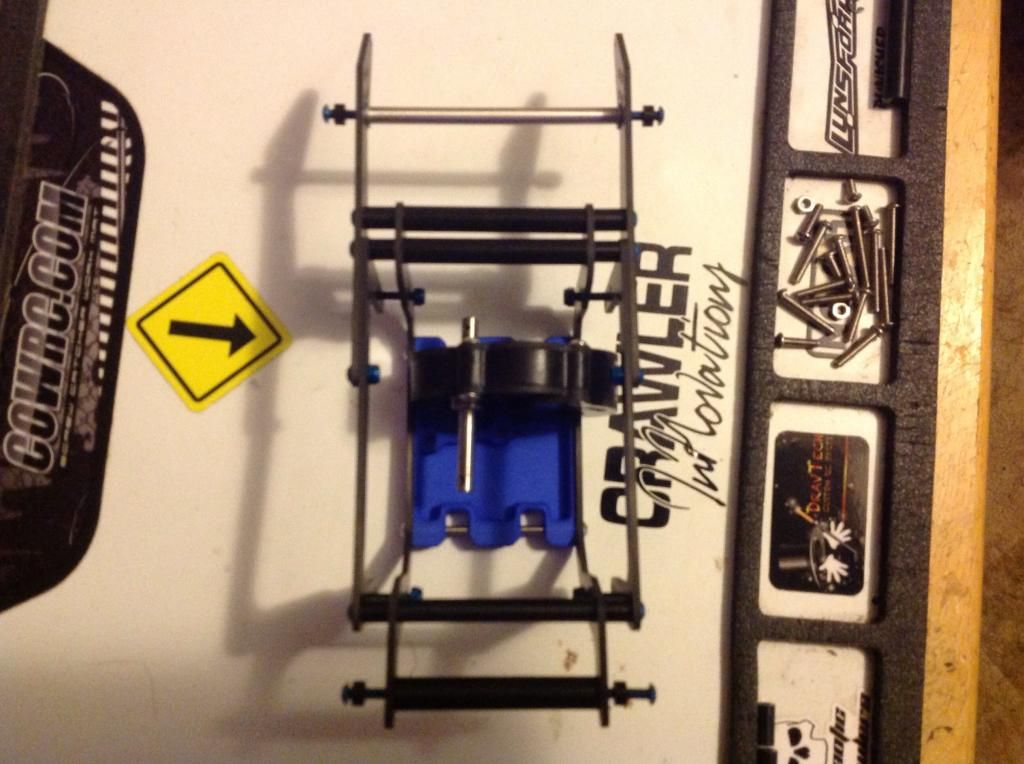

The Sudu-One Fl is very professionally packaged. I mention it, only because I feel it's something companies over look sometimes. The chassis comes in a nice ziplock bag with a label. All the cf parts, skid, braces, screws, and body mounts are all in separate packages. This chassis even comes with instructions! The chassis was very easy to assemble, although the instructions were nice to refer to.
Here is how the chassis looks all built up
Nice that the option to run the dlux sway bar is built right into the chassis!
This skid is nice. This is the first 3d printed item I have ever held. It is very very sturdy for how minimal it is. It feels quite slick too. Definitely more slick than delrin. Gonna have to do some testing to see if it gets my Teflon treatment.:mrgreen: And this blue,, very rich. I love it!

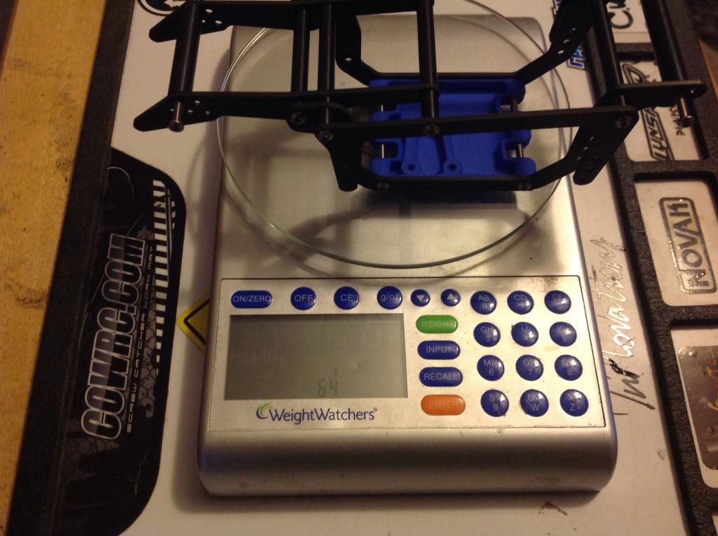

Surprisingly lght considering it has all steel screws"thumbsup"

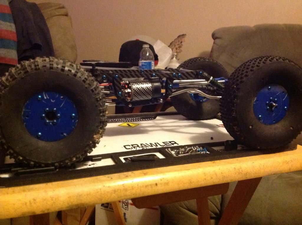

And here is how it looked after I spent some time with the chassis8)
This chassis has a very modular design, much like the double agent. And I really like that about it. I run my shocks really wide at the rear axle, so some chassis widening was needed. It is nice to run the rear shocks as wide as I do and not worry about running long screws with huge standoffs.
Next came the transmission fitting. Was able to use one of the existing holes in the boxer trans, and drill a new one. Mounted without any adapter plate, everything sits nice and low. The brood Sisu fits a little snug, the puller 400 should clear perfectly.
Very easy chasis to assemble and disassemble. Very high quality fit and finish. I couldn't be happier"thumbsup"
Very happy with how this turned out.
Rear shock mounts worked out perfect!
Nice and low cg.. Much like the boxer.
You even got the thick spacers from Gunnar mounts mounted + the other "heavy" delrin spacers ;-)
Do I want to mention this carbon fiber. It is different than what I am used to. It has a different finish and slightly different texture. But, I really like it. It seems lighter than regular cf.. And possibly a tad bit stiffer? Dunno.. All I can say is it is amazing. Fit and finish is very nice. The crossbraces are all super high quality. Just an amazing chassis kit!

shotty pics dont matter ....build looks good and the weight watchers scale is still in full effect :flipoff::flipoff::flipoff::flipoff:
