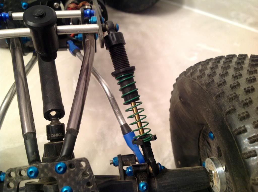

Shocks-
Front - plastic scx, losi mrc silver spring, AlexG cf spring cups, 9mm internal limiters, 2mm external limiters, 25wt oil
Rear - plastic scx, losi mini-t rear green spring, AlexG cf spring cups, 6mm external limiters, 25wt oil

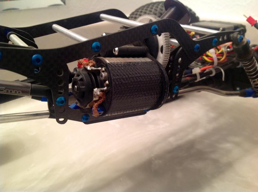

Custom fiber motor guard

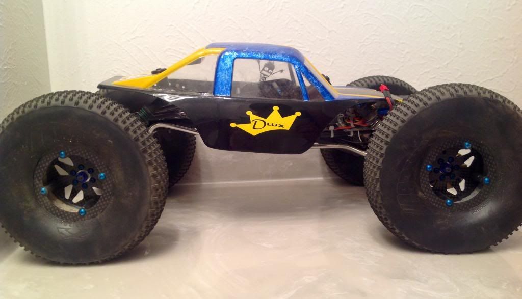

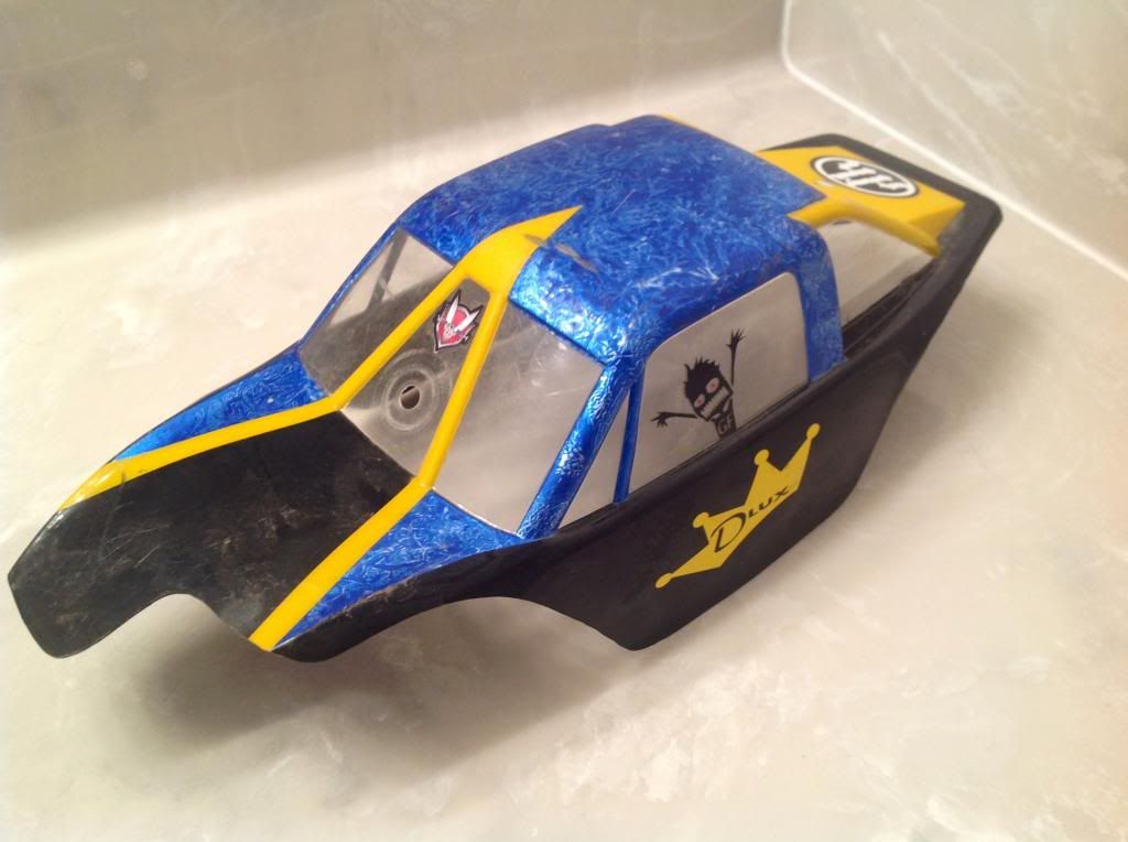

My fancy body I painted:mrgreen:

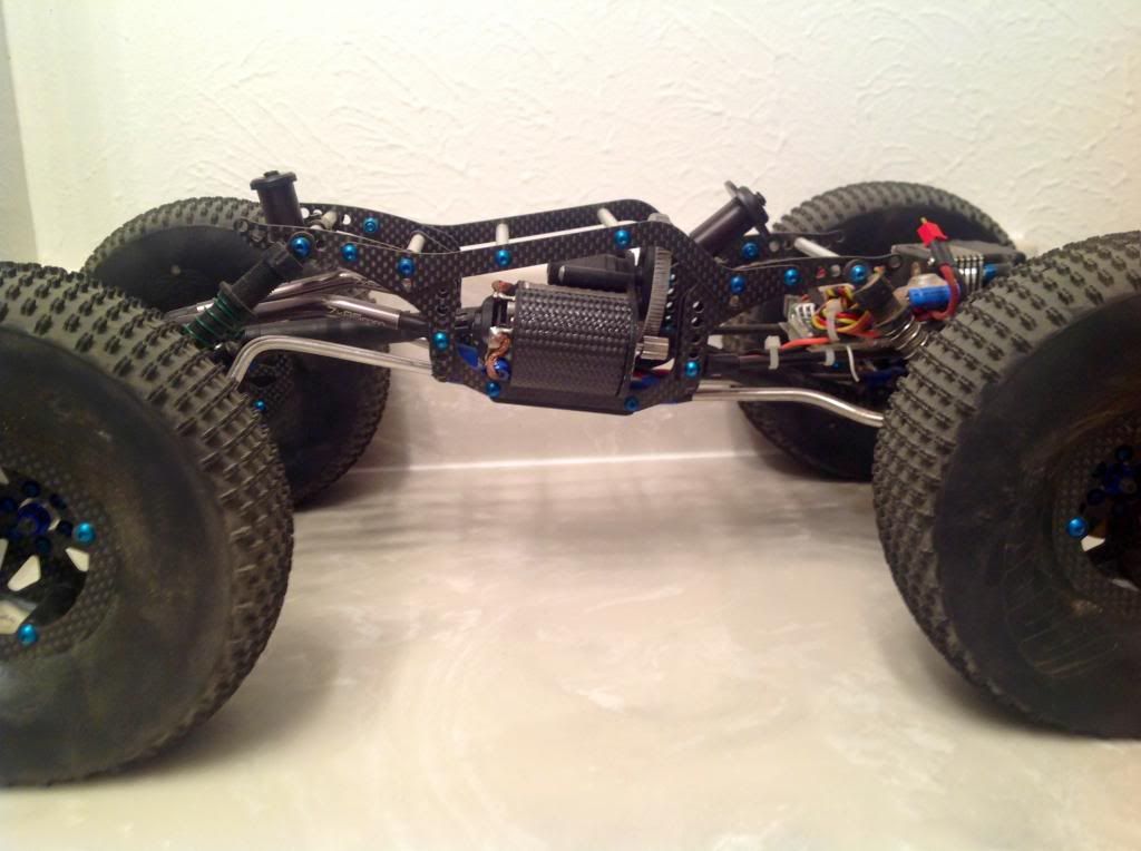

Front shot
Body off

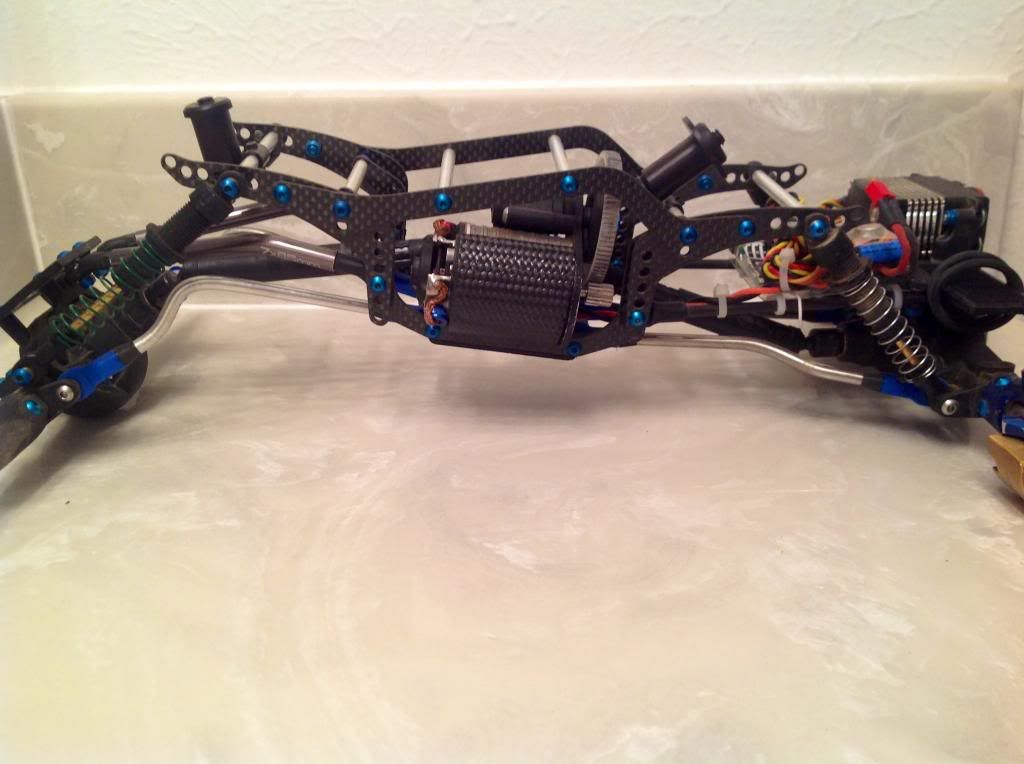

Bottom shot
Custom Fiber Motor guard

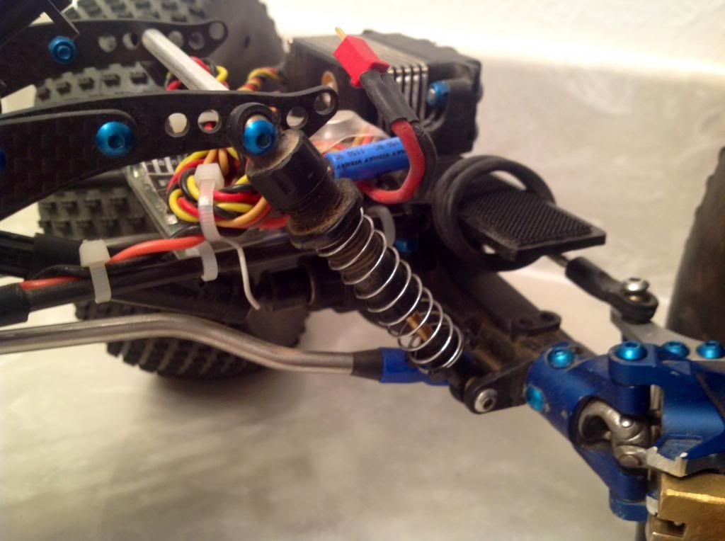

Overall side shot showing links and placement

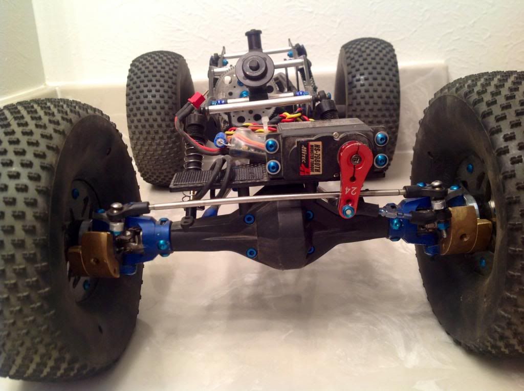

Steering set up

Front shocks
Rear shocks

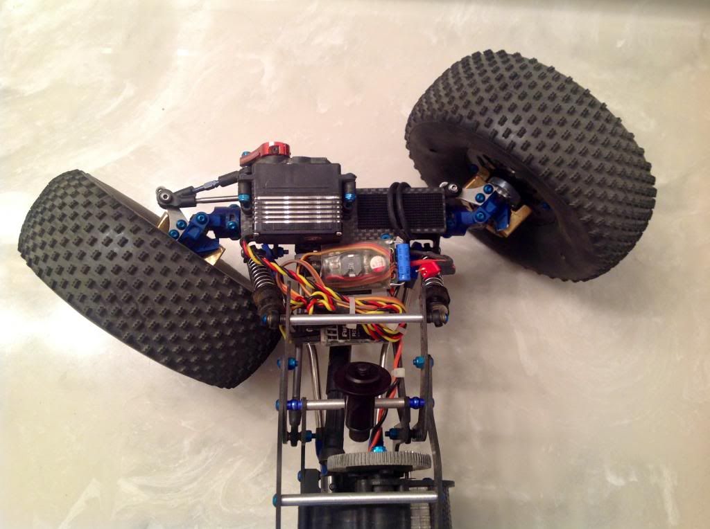

Steering shot

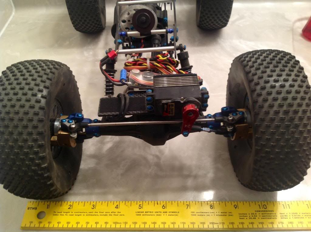

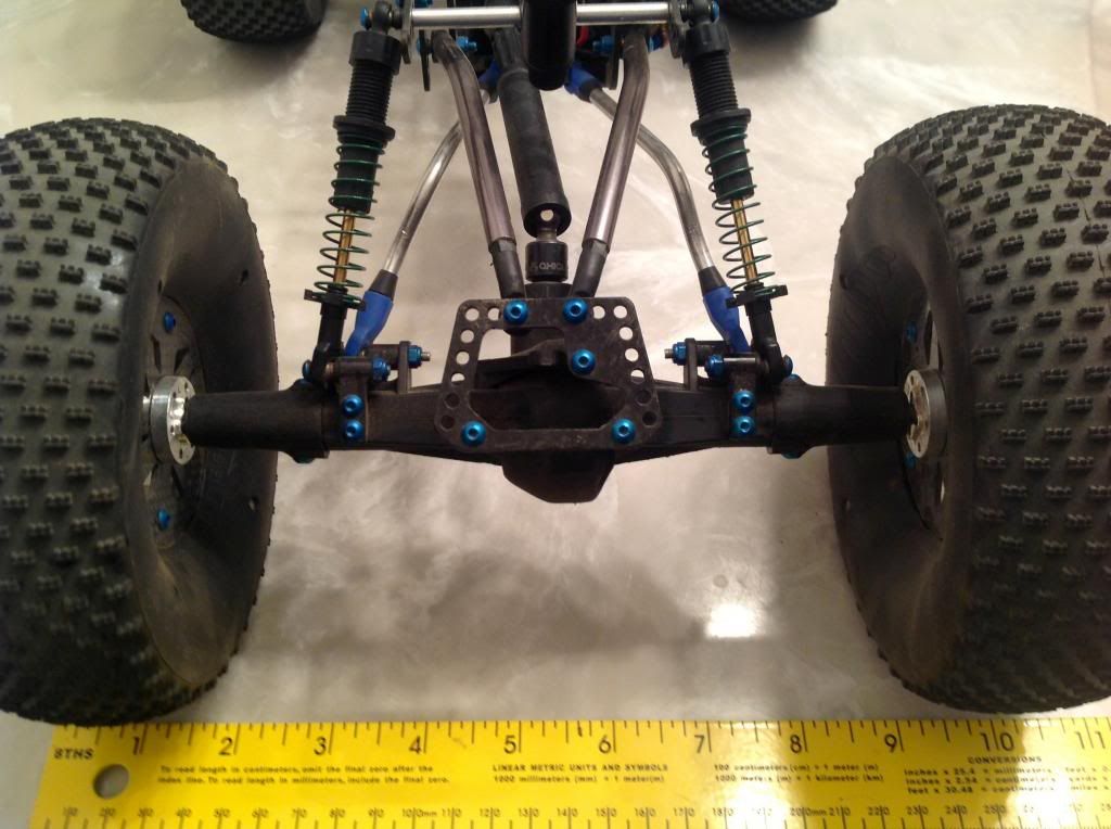

Front width - 11 1/16"
Rear width - 10 7-8"

Don't like the drag link. Do like the rear lowers.
And I shaved off all the upturn tips of the shock mounts as I broke one and it's not really needed.
Looks good"thumbsup"
Yeah me either.. But I works. And thanks.. They were a bitch to bend.. And the clearance they give is just stupid.
Good idea. I hadn't thought of that but I can see what you are sayin. Thank ya"thumbsup"

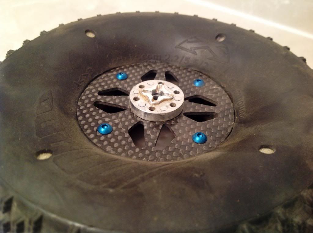

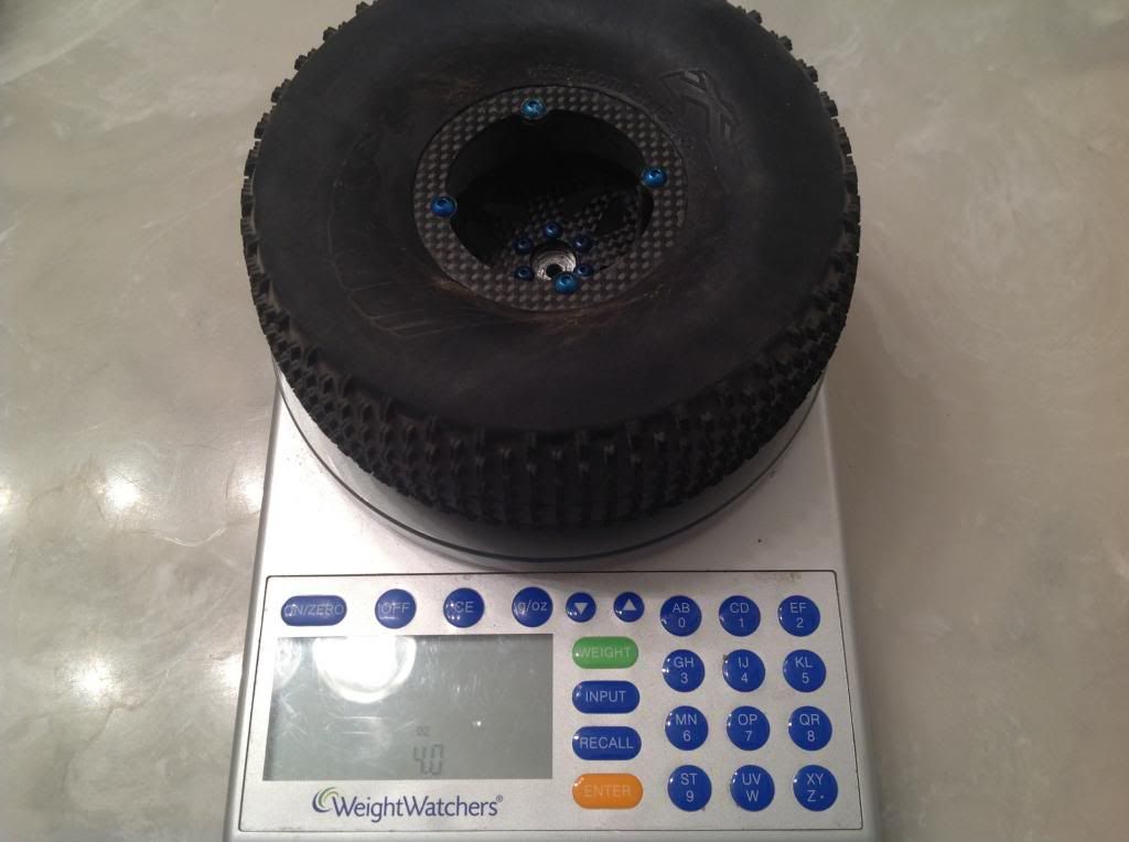

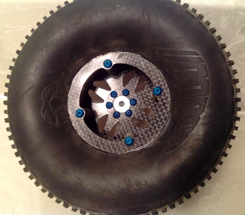

New wheels!

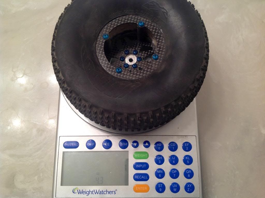

These are Dlux g10 wheels. They are light and the quality is second to none. I chose to get the wheels with 7/8" cross braces. A little narrower than I am used to but it isn't a huge difference so I should be fine. And yes, I am running three cross braces. I am sure Erik would highly advise against it but I think it's fine. There is very little flex in the wheel only using three braces.
With all six braces and aluminum hardware, each wheel weighs in at 18g.
My wheels with three cross braces and aluminum hardware weigh in at 14g.
Not a huge loss, but if there arnt strength issues, it is worth it in my eyes.

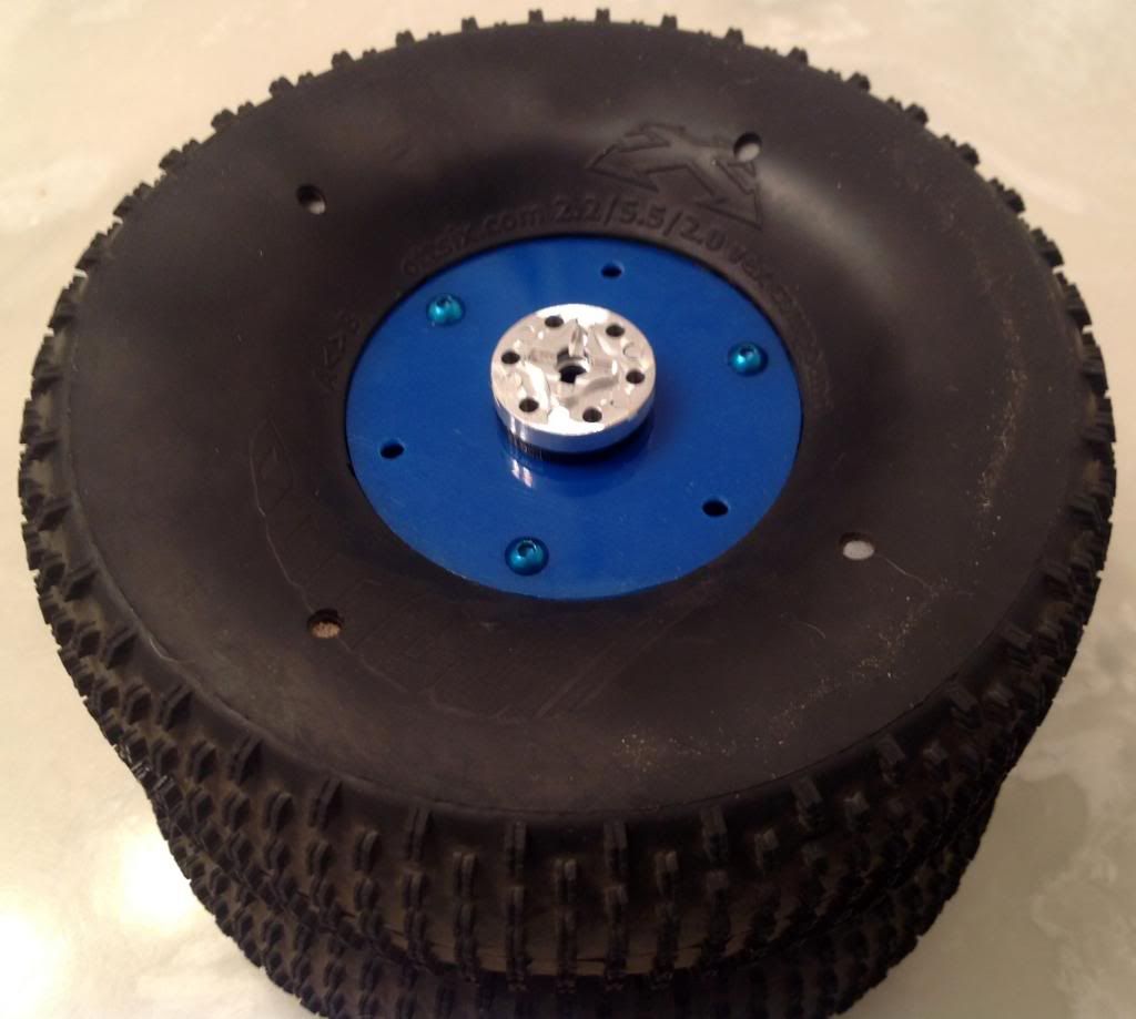

Backside

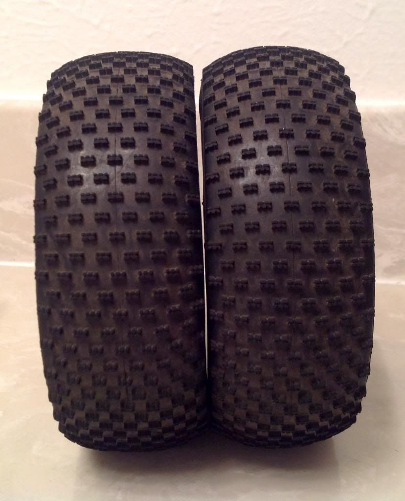

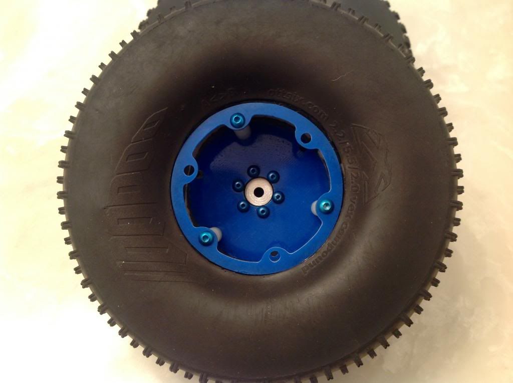

New tire shape. The front stayed the same, but the rears rounded out a little. This is with the same foam setup as before.
Front on left, rear on right.
I am unsure of the mounted up weight. I will get that, and a few pics of them on the rig tomorrow"thumbsup"
