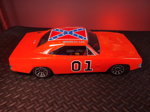

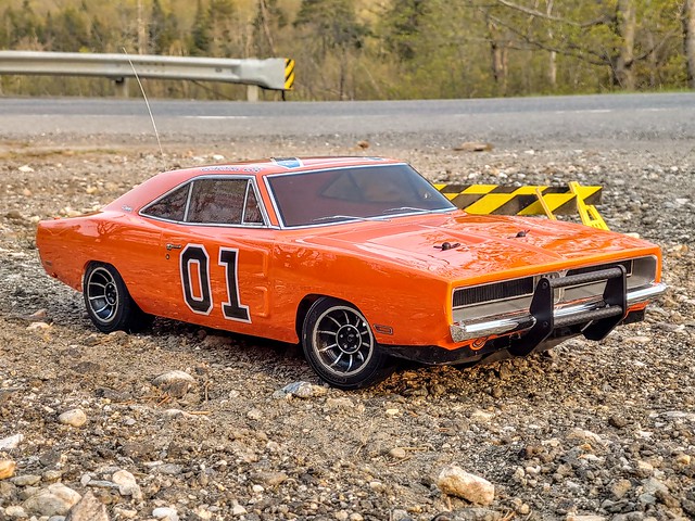

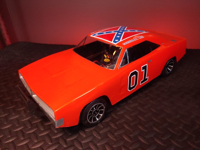

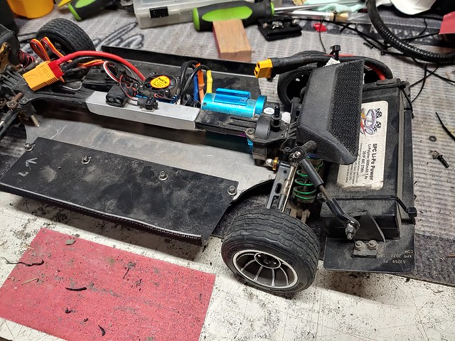

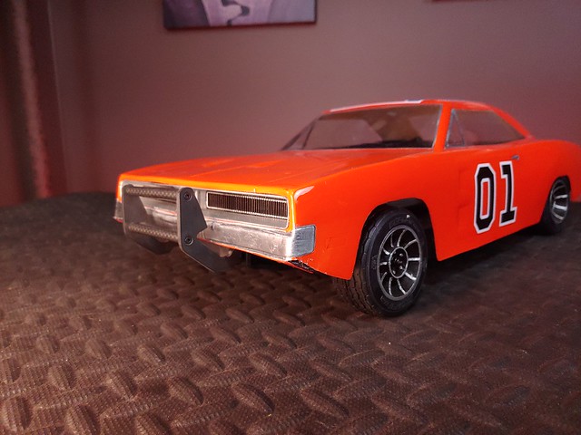

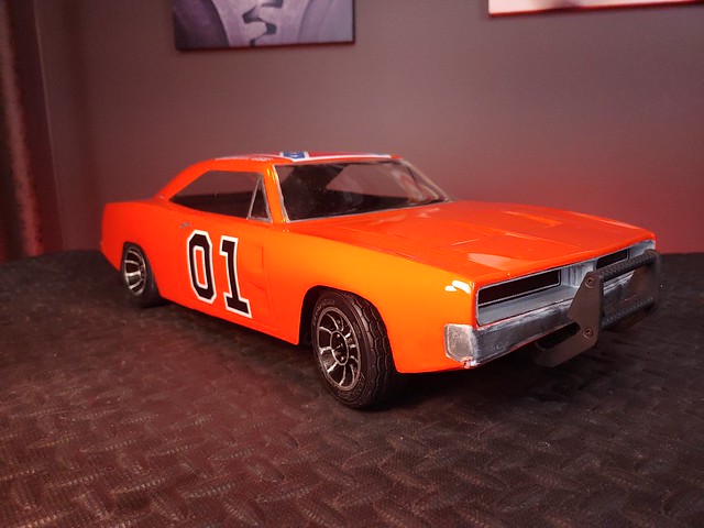

The RJ Speed General is done. It definitely doesn't look as good as the Kyosho, but considering how boxy and flat this body was, I'm pretty happy with the result. This should make a great jump car.

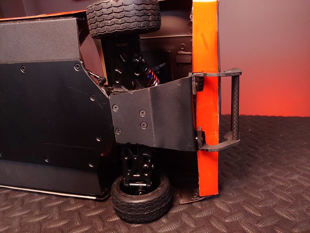

I built chassis wings from Kydex that the body velcros to in order to help pull it in and give it a more rounded profile. You can also see the push bar mount and a rear filler panel. I also painted the inside of the body black to make the underside look better when it jumps.

As you can see from the jump at the end, it didn't fly very far and landed nose-down. I had the esc plugged into the wrong port on the receiver, so I was at half speed. As for the nose down landing, I'd hoped that sliding the battery back would fix it, but it didn't, so I had to resort to more drastic measures. I reinforced the rear panel behind the axle so it could hold the battery. That did the trick and now it lands flat, so I should be able to adjust how it lands with different size batteries.

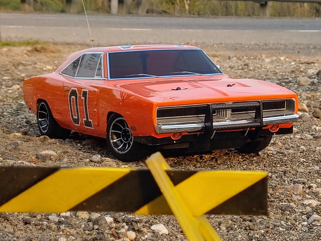

Lastly, I decided to take some pics of the Kyosho with some scale road barriers that I printed.

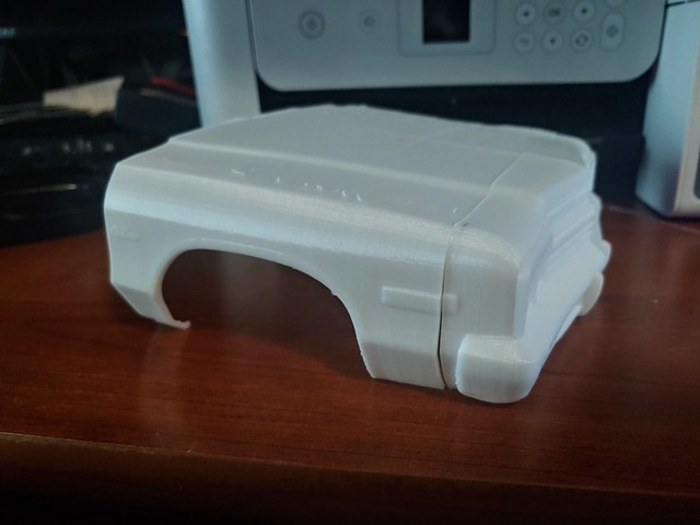

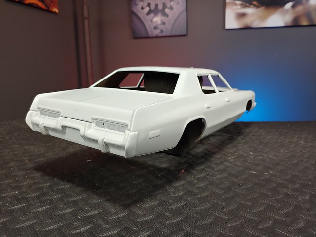

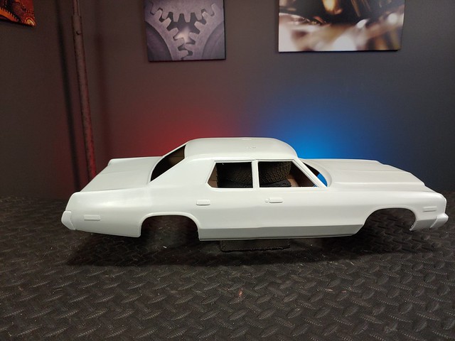

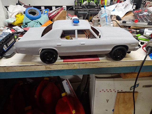

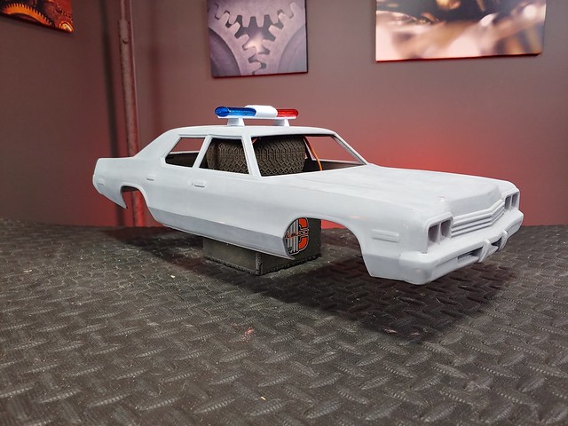

Got back to work on Rosco's car. Used putty to smooth things out, then primed, more putty, more primer.

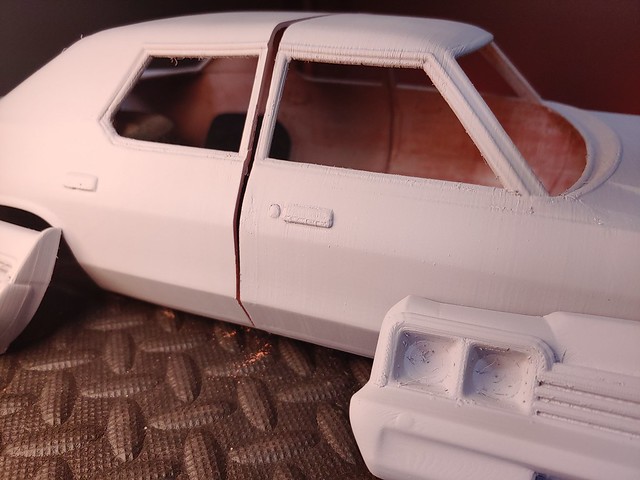

Glued the front and rear fascias on, putty, primer, putty, primer...

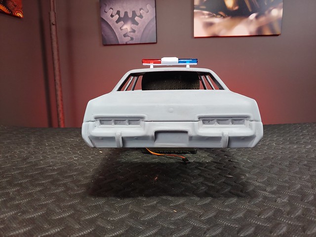

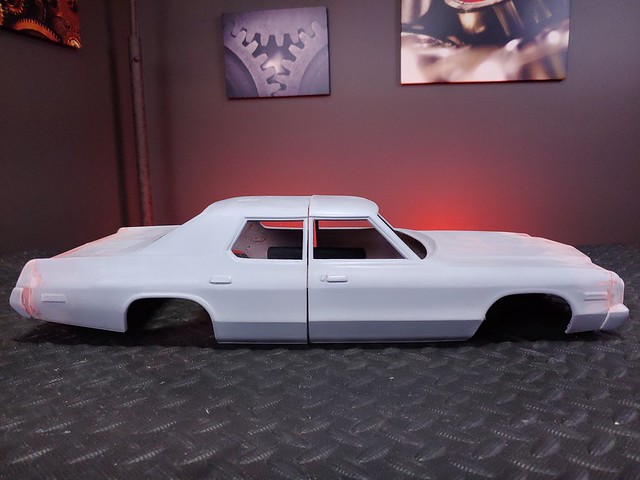

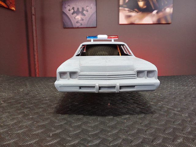

Glued the front & rear halves together then you guessed it: putty, primer, putty primer. I also mounted the mockup light bar.
Next I worked on moving body posts around to get the body to sit how I want on the chassis.
Next I need to work up the courage to paint the body. After how that went last time, it's definitely not something that I'm looking forward to.

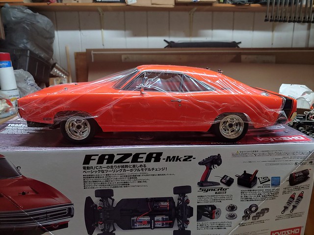

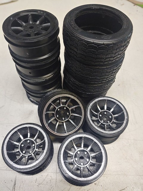

For the first issue, I'm trying out a few options. I picked up a Kyosho Fazer with the 70 Charger body. The front end looks totally wrong, but if you remove the chrome piece, the lexan seems to be the right shape to accommodate an inset 69-style grill assembly. Once I swapped my 3d printed Vector wheels and took off the front grill, it already started looking way better.
Right out of the box:
The printed wheels:
Wheels on, front grill/bumper off:

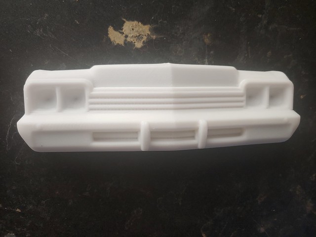

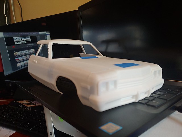

So, that leaves #2. This one required a completely different approach. Nobody offers a 1/10 scale sedan body, especially anything that was on the show. I started digging into 3d printable options and I found a guy on Cult3d.com with a TON of body options, including a lot of 70s junk. He didn't have any late 70s Monacos or Furys, but he did have a 74 Monaco, which is virtually identical to the 75 Monaco that was used a little bit in Season One, so I grabbed it. It turned out to be a really nice model that I could easily pull apart in Mesh Maker. I'm about 1/2 done printing the body, and I've got a ton of work ahead, but I'm really excited about how this looks!

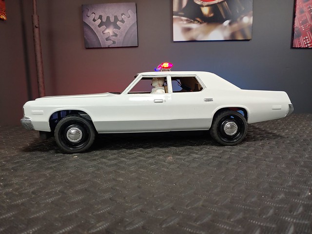

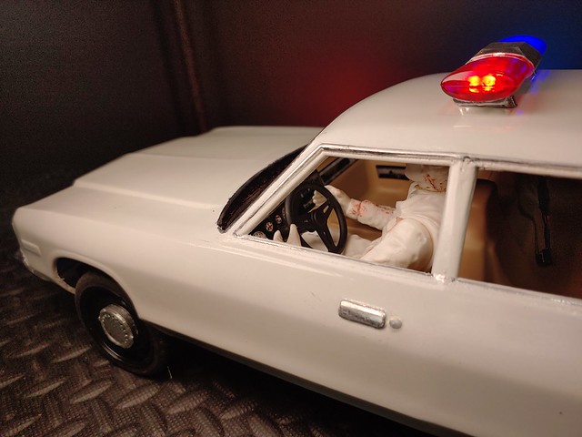

Lots of progress on Rosco's car.* The magnetic body mounts are installed, although I think I need to tweak the body height a bit. The chrome trim is painted, the light bar is installed, the LED headlights and taillights are in, and the taillight lenses are installed.* I still need to install the headlight lenses, but I'm waiting for now because I want to swap the cool white LEDs for more realistic looking warm white headlights.
I've also been working on an interior for the car.* It is a lexan interior intended for a crawler, but with a little work it fits decently.* The driver and steering wheel are from Tamiya.* In this pic the driver was sitting way too high, which tweaked the interior.* I'm working on cutting him down to fit into the car, and hopefully leave enough room for a cowboy hat that I 3d printed.**
Coming up I need to paint the side marker lights, install the decals and then come up with a solution for the front & rear windshields.
I almost had a heart attack right after I took these pictures.* I grabbed the transmitter and must have squeezed the throttle. The car shot into the wall so hard that it dented the wall.* I originally thought the car was unscathed, but I discovered a crack in the front fender above the wheel well.* I glued that up and will need to reinforce that area to strengthen it.
