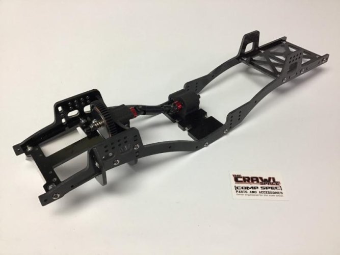

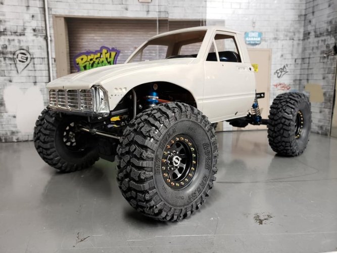

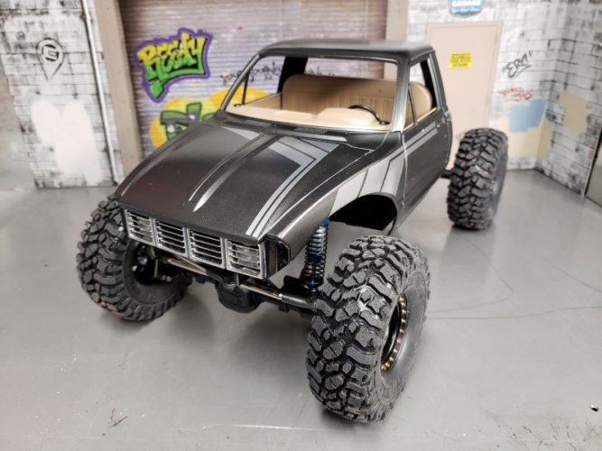

Now on to my version.....which seemed to address the challenges I mentioned before by basically doing away with or affording a different approach. The GC4.2 stage 2 kit comes with a forward mount low COG trans and t-case set up they call Double-T that takes care of that space killer stock trans. As for ride height, I was able to bring it down to a level I like, but it still cost me the BTA due to having to move the shocks to the link mount location. So with that, I clocked the axle up to fix the drive line angle and adjust the chubs to rotate the tie rod up out of the way."thumbsup"

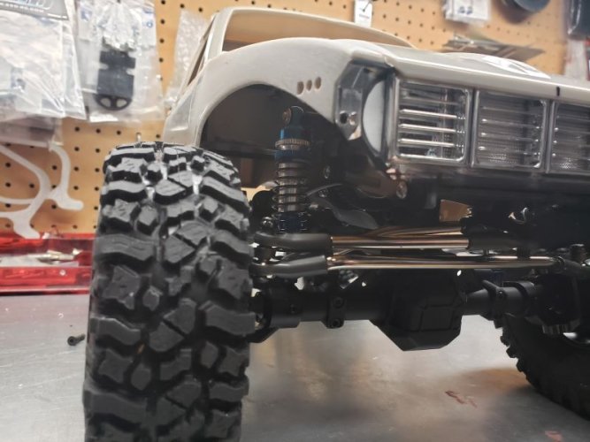

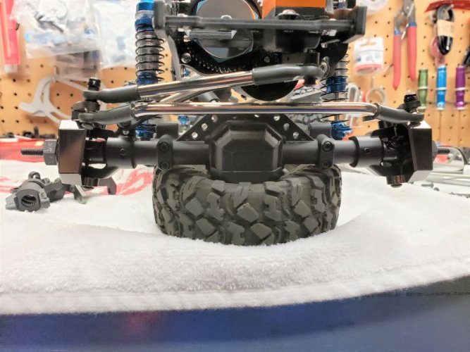

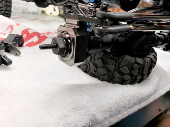

Had a bit of time last night to get the SSD brass knuckles and aluminum chubs installed. There must be something wrong with the factory plastic set because it did have some very noticeable negative chamber before, and now with the SSD parts it is right on neutral. I have seen a few posts about it, but didn't think much of it, plus I also am running positive caster for steering and to get the tie rod up higher.
http://www.rccrawler.com/forum/element-rc-1-10-enduro-trail-truck-sendero/612976-little-help.html
Few cab off shots thrown in too."thumbsup"

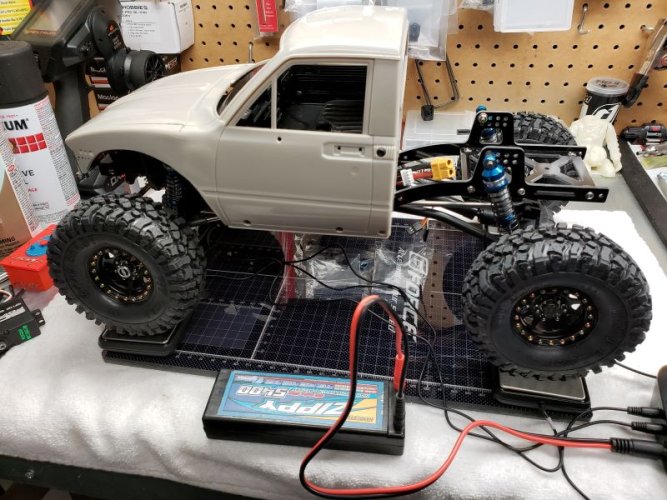

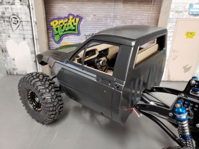

Some more progress made over the Holiday weekend....
Finished up the RC4WD interior, awesome detail and fit! It comes with metal details that go around the radio and heater controls, air vents, door trim, that I didn't use, and around the gauge cluster that I also didn't use. Floor mats are some Velcro cut to fit.

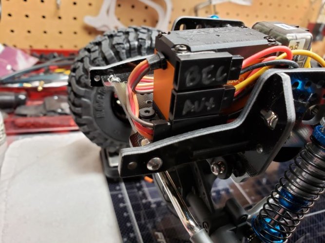

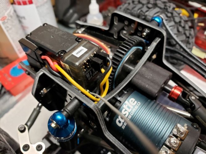

Electronics placement. Mounted the receiver behind the steering servo with the plugs on the side. I always use the Holmes Hobbies "Y" to hook the servos to the BEC. BEC will be mounted between the steering and winch servos. Battery is on the skid and the Mamba MicroX on the slider.

Needed to clearance the front fenders and the corners of the grill for the tires.

Broke out the scale to see how it is shaking out so far. 60/40 and weighing in at 5.4lbs. so far, but thinking it will end up closer to 6 or a touch over.

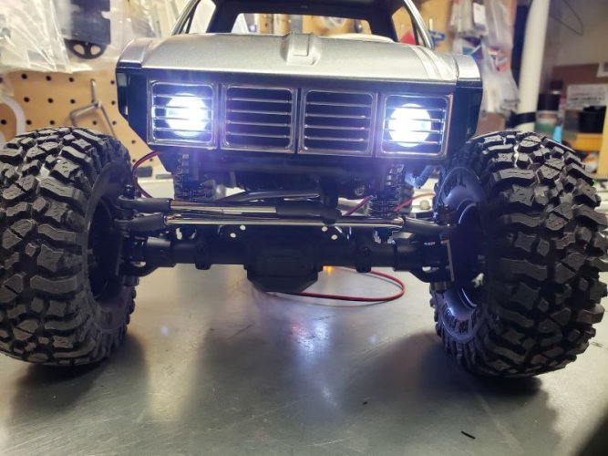

Man does that look good!"thumbsup"
I like the way you hid the lights behind the grill! Interior looks great too!
