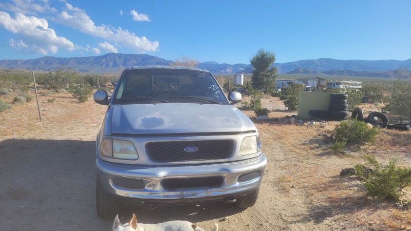

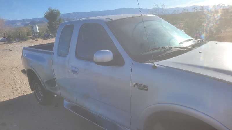

this kinda showed up at my house back story as I know it

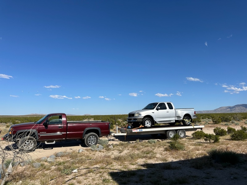

my friend is addicted to buying cars from cars for kids actions well he's on his 7th or 8th rig by now lol well he bid on this one and I took a liking to it and well here it is
more pics
it turned out it had no keys so a quick visit with the lock Smith and whalla keys
put a battery in it and that damb thing fired up but wouldn't idle but I was able to drive it off the trailer

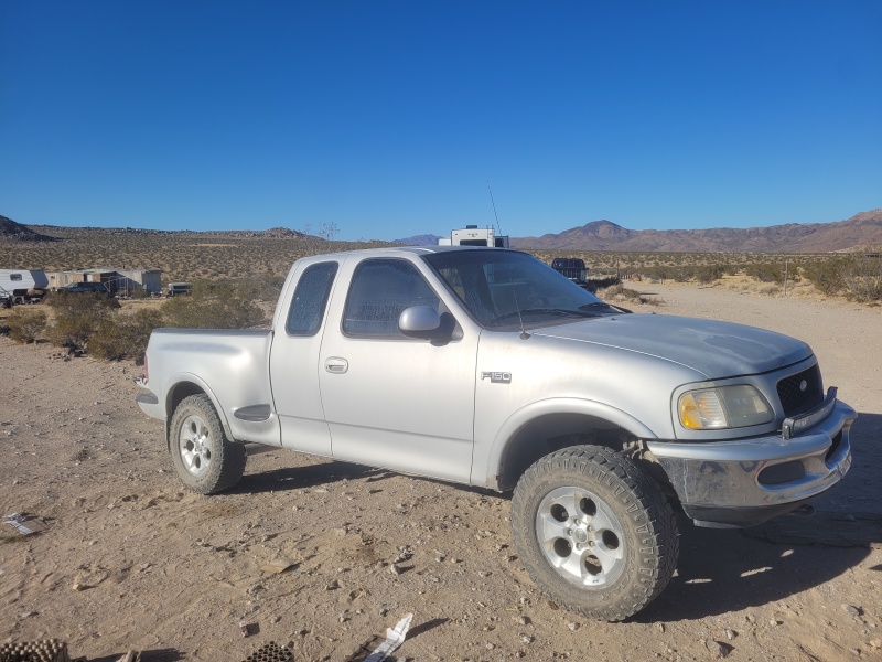

after a bit of tinkering I got it to idle and run it longenuff to though a code
cloged EGR valve and sure enuff the intake and EGR was plugged solid and the EGR had a heat shield that covered the part were it connected to the exhaust and it wasn't even connected and probably why it tossed the code I'm guessing that's why they parked it and donated it
anyway I'm waiting for new intake gaskets to put it back together and should be ready to smog
I'm sure there are some problems I haven't figured out yet and I'm sure the DMV is gonna kick my teeth out when it comes time to register it lol

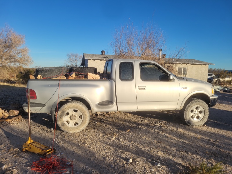

anyway truck runs good now and is drivable the damb tires were shot and I had 2 blow outs driving around the property it turns out the wheels and tires I bought for my roo project fit nicely on it so I'm running them for now maybe a better fit than the Subaru

anyway got some new 33x11 tires on it and found out the rear axle leaked like a sive oil leaked out as fast as i poured it in lol so reseal the rear diff cover and a new front pinion seal and its leak free new rear breaks and shes drivable i might be doing a axle swap sooner than later but for now its drivable lol
i bought a 3/2 lift kit for it but not sure if im gonna install it or not the 33s fit nicely with just a crank of the tortion keys

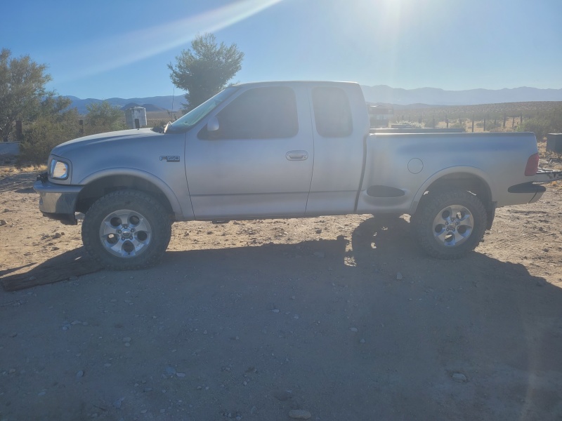

Looks sweet with the newer Ford wheels! Are those 5 on 5 1/2?
thanks yo
there 5x5 jeep wheels that i stole off of my Subaru lol but i might have to swap out the rear end here pretty quick and my other axle is a 8 lug so the roo will most likly get its wheels back soon and ill get some 8 lug wheels then adapt the front from 5 lug to 8 lug
not ideal its only as strong as the 5 lug adaptor but hay its only a 1/2 ton
8 lug conversion would be awesome, and the used aftermarket wheel selection is way more plentiful (around here at least)

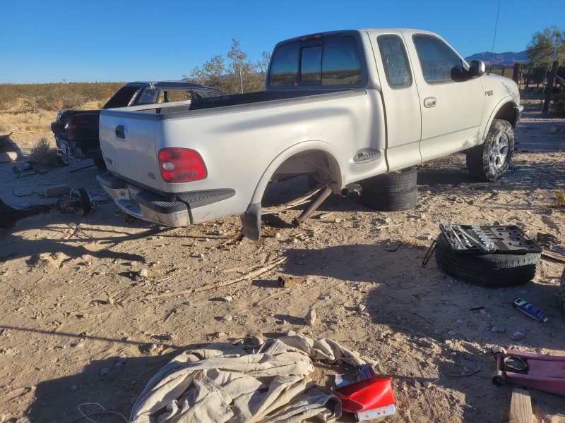

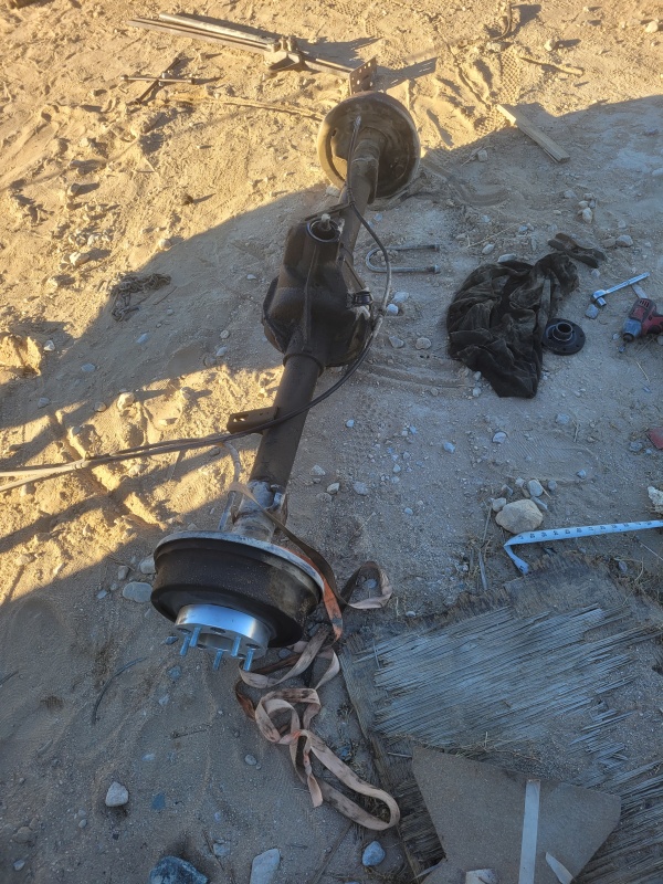

on the way home the rear axle decided it had enuff and locked up i was able to get it to free up and creept it home in 4wd at about 25-30 mph for 40 miles though the desert lol anyway axle swap is happening sooner than i had wanted but it happens
it looks like the only bad juju wasthe shock mounts so i cut them off once the axle is in place ill bolt it up and tack the brackets back in in the right place then pull it out again and weld the piss out of them
damb spring purches are off so im gonna have to cut them off next ah the joys of a axle swap also the joint is slightly off so im gonna need to track down the right ujoint lol
the good news i guess is the gear ratio matches the front so im not going to have to buy a new front end of change gears down side is i wanted the lower gears oh well good for now since i dont have the money to do this swap
it turns out the new axle had a much longer pinion shaft so when i went to put the driveshaft back in um well it was a no go
so i had to shorten it since i dont have to tools to do it right i sent it out i know kinda lame but it is what it is anyway took 2 inches off the shaft and added 2 inches of lift and the shaft is just right yay
