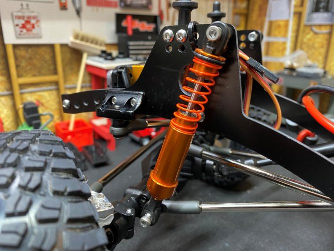

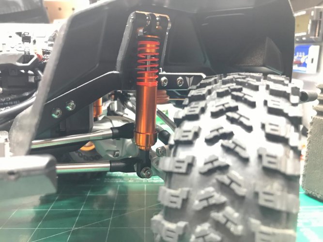

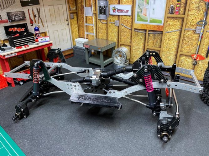

I too run them upside down. They fit better on the PRO if they are upside down. No trimming needed on the stock plastic shock towers and they fit better at the axle.
I did have the Dravtechs on my PRO at first, but ended up switching them out to a set of Traxxas GTS shocks. IMO the Dravtechs work better on lighter rigs. My PRO is a heavy pig!:ror:
Now my orange Dravtechs that were on my PRO now live on my GSpeed V3 build. They feel and work so much better on this lighter rig.
Also have a set of Dravtechs on my GSpeed V1-C1.
