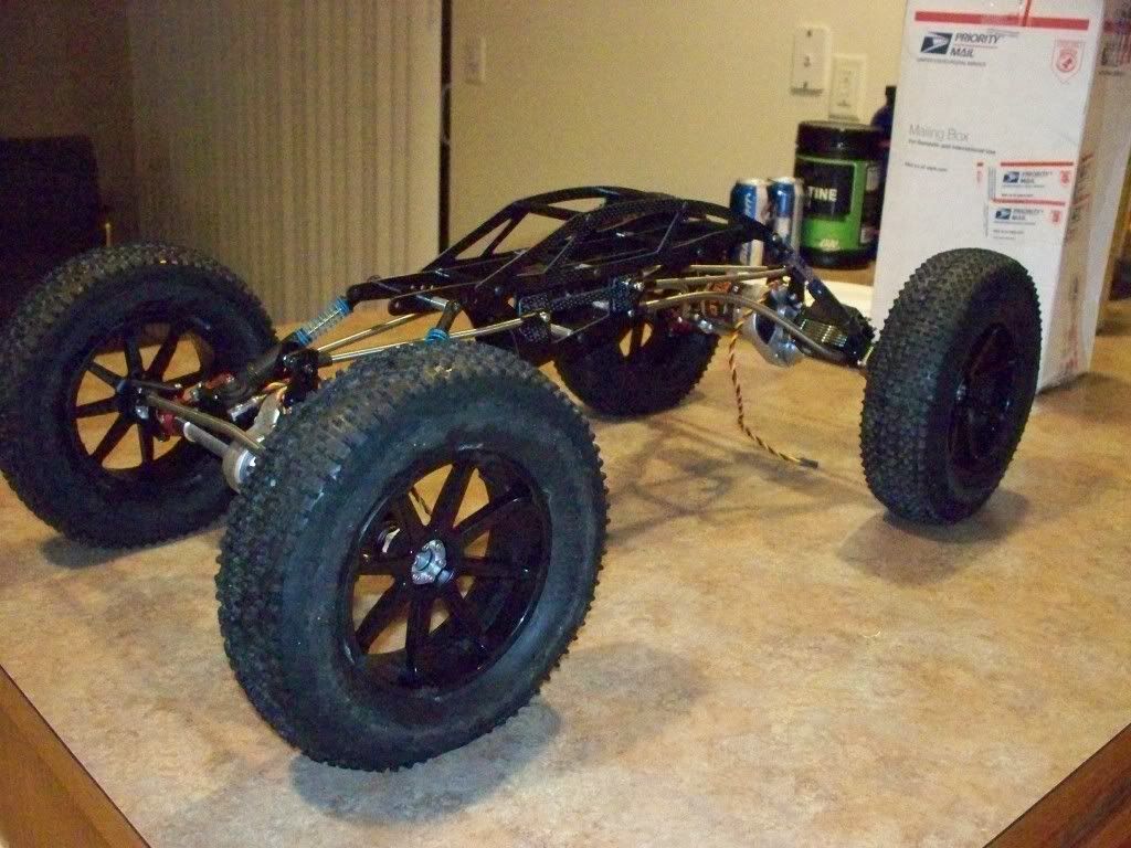

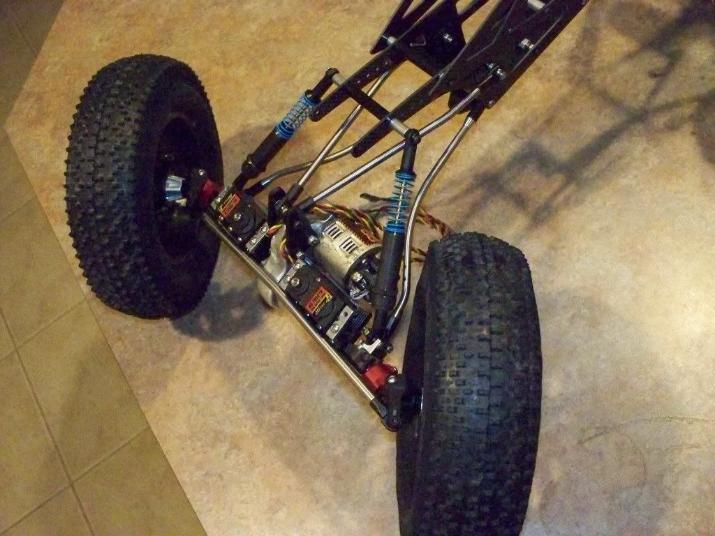

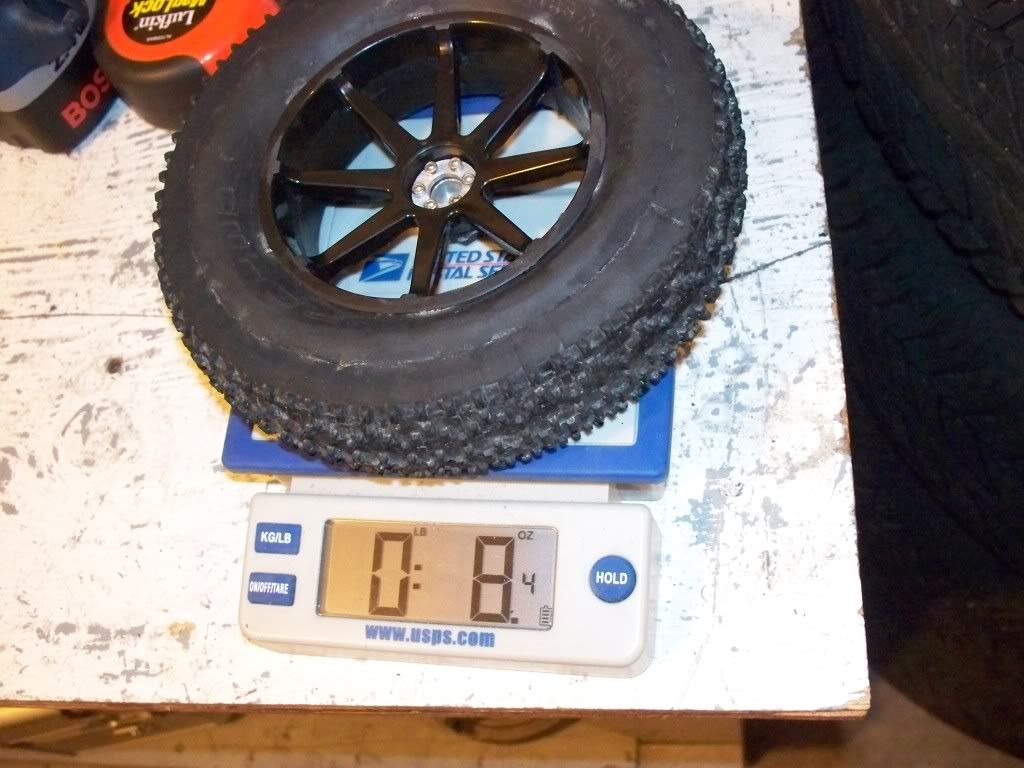

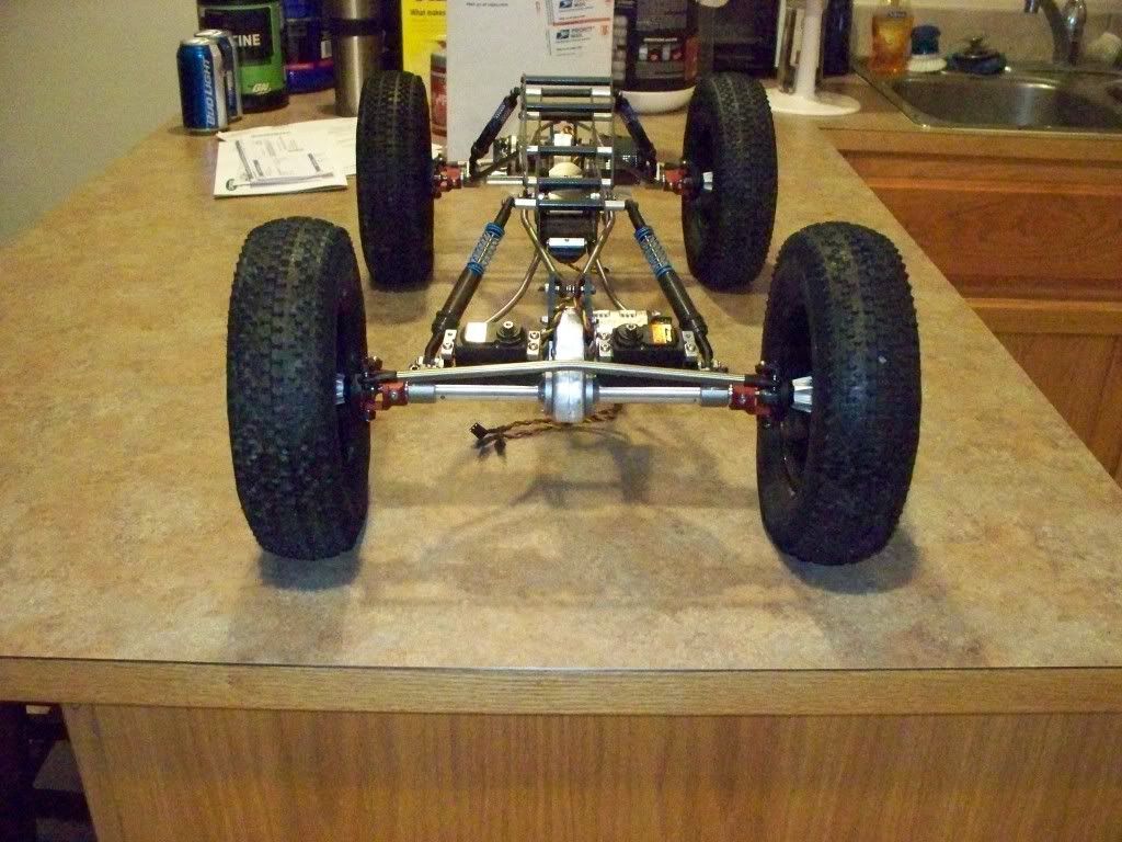

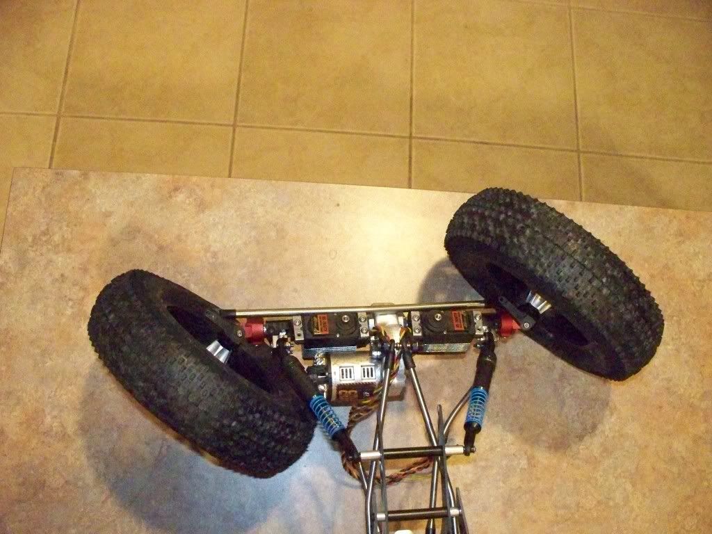

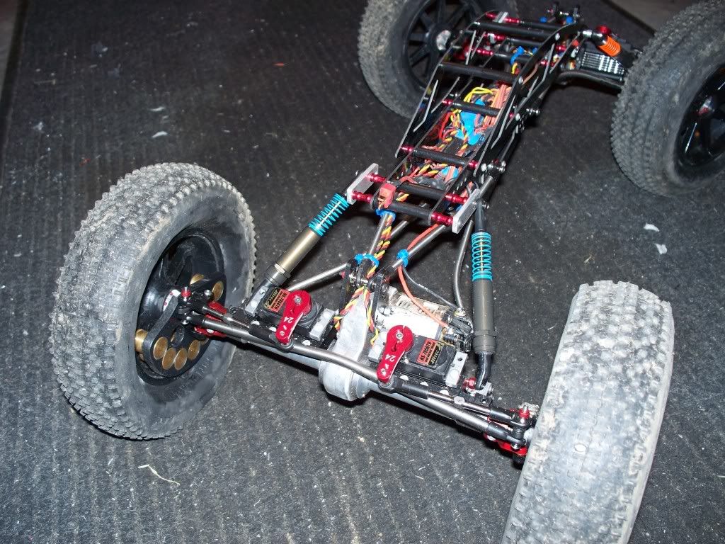

So I got my new closed cell CI foams today and also shaved the sidewalls down on the BC's. I got the wheel and tire and foam and hub combo down to 8.4oz. The tires are at 7.5" tall, oh and the tires clear with no rubbing on the links. I still have some aluminum screws coming for the hubs but that aint gonna change it alot. Over all pretty happy with how light I was able to get them. Now I just need to see if the wheels will hold up. So as the truck sits right now. No electronics etc. Its sitting at 5lbs 9oz. Still need to make the bracing for the shock mounts on the chassis and make the weight system and of course electronics.
I see you were able to get the front shocks relocated. That should work out much better. Have you tried flexing it out yet? Im curious what kind of articulation it has at this point. It looks like that rear is going to need limited up a bunch.
I hate to admit it but your super is pretty much exactly like the one I have been picturing in my head. Makes me not even want to drive my super bully anymore. Thanks a lot Dave. :cry:

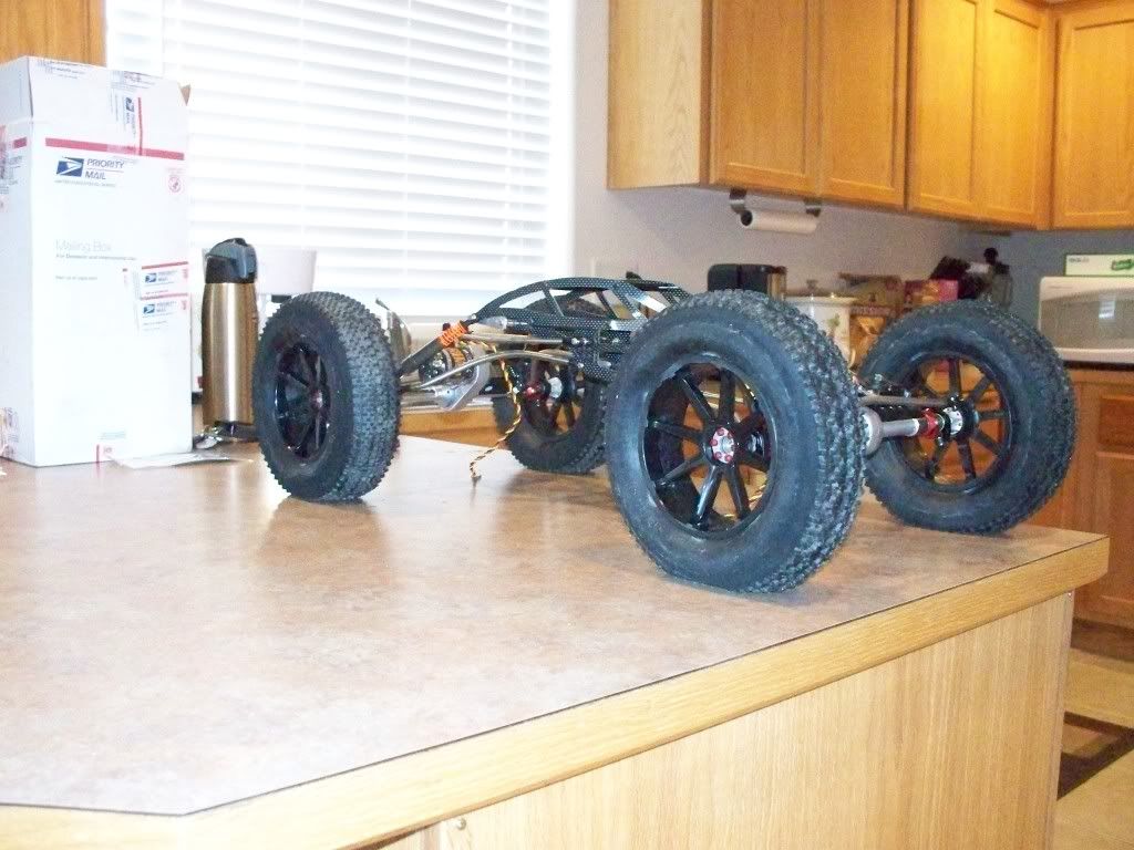

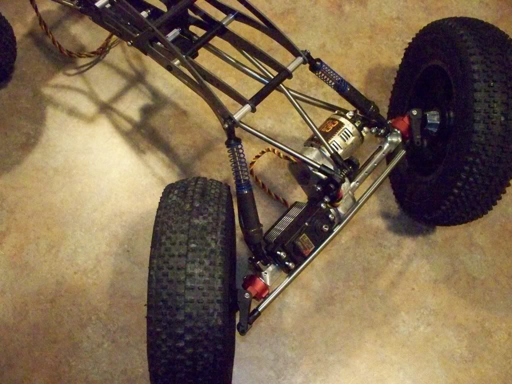

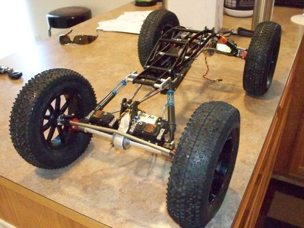

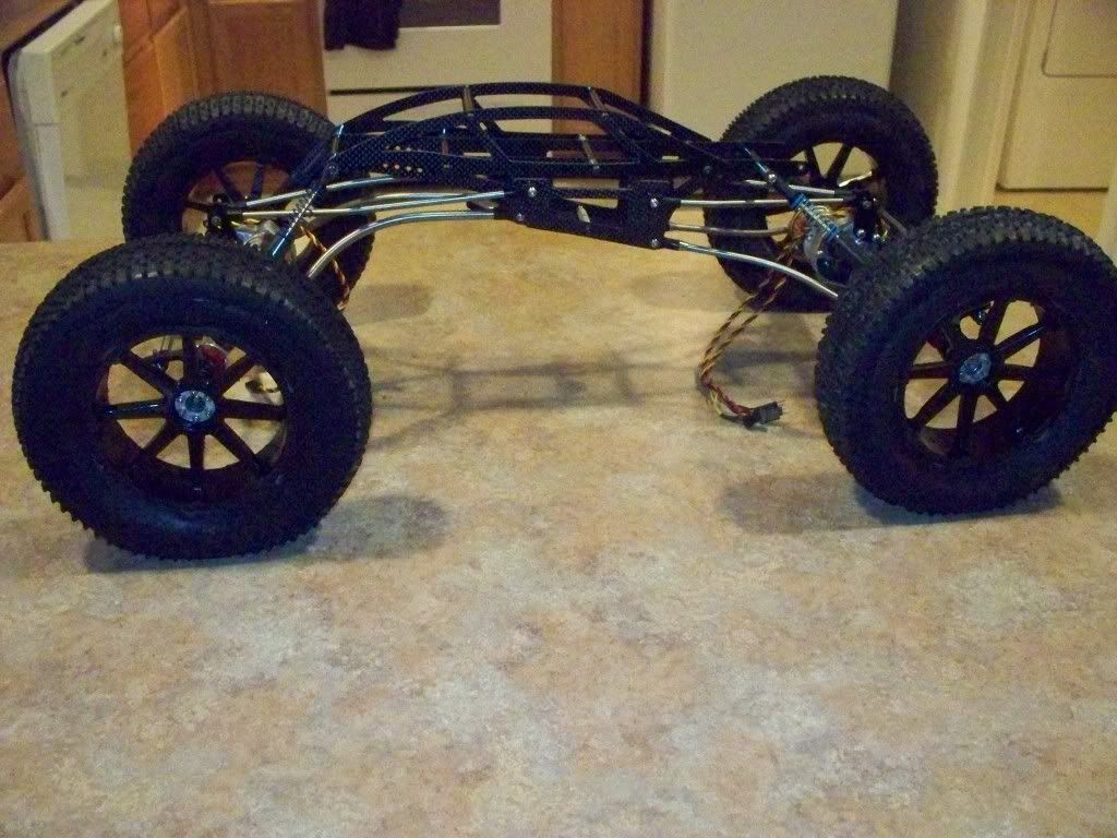

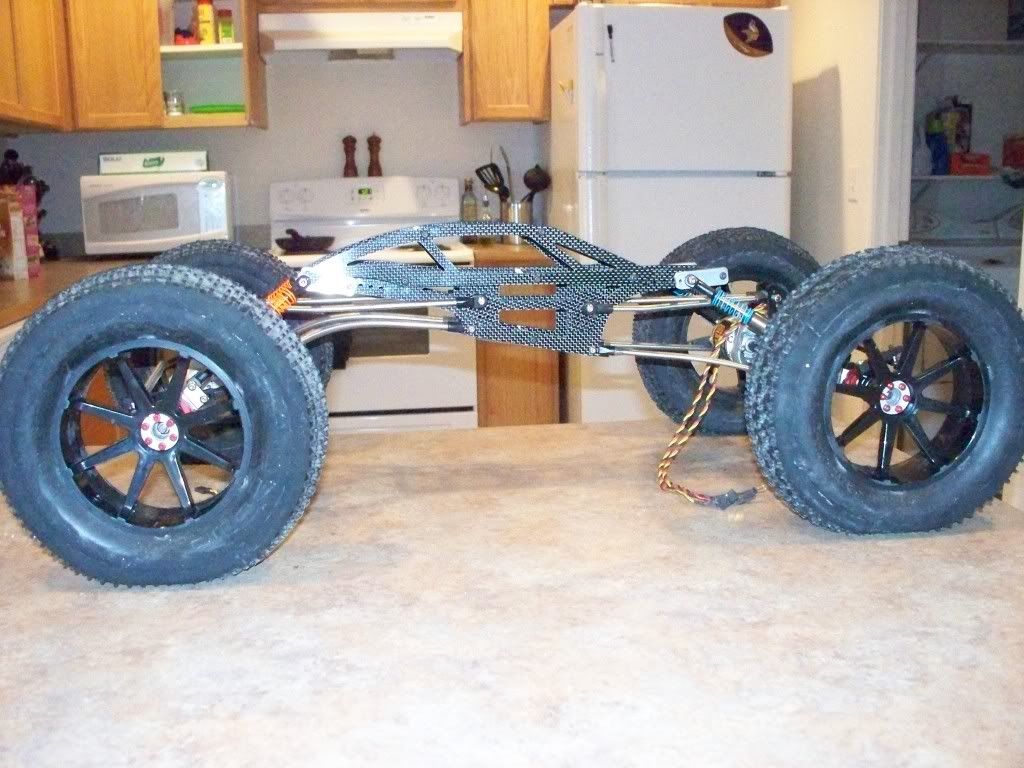

So I got some more time to mess with it this morning. I limited the shocks a bit and also made some really ugly braces for the chassis because of how far the shocks stuck out, I felt they needed a little more support. So the mounts will prob be temporary, but they will work for now. Here are a couple flex shots. I'm really not sure how much flex I should have with a super. I'm sure everybody has their preference. For me I like the ride height its at right now. It looks to have about 7.75" to 8" under the tire I would guess. I will start with that and see how I like it.
Stance looks really good, flex seems about right too... In my opinion.

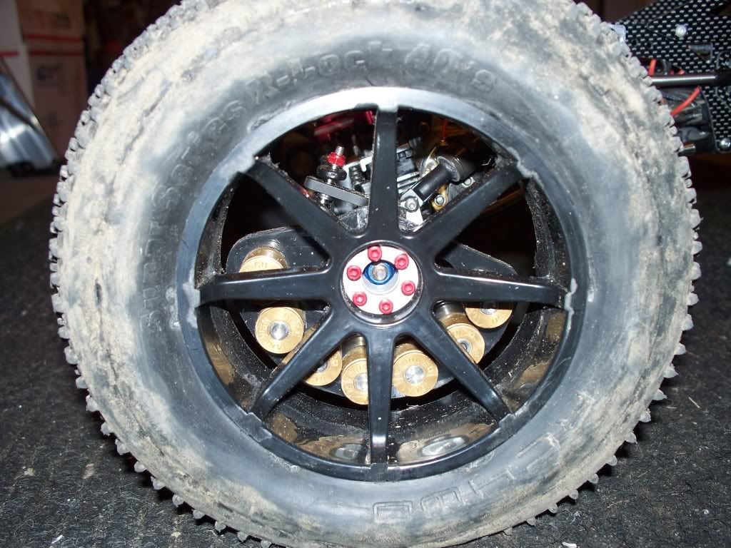

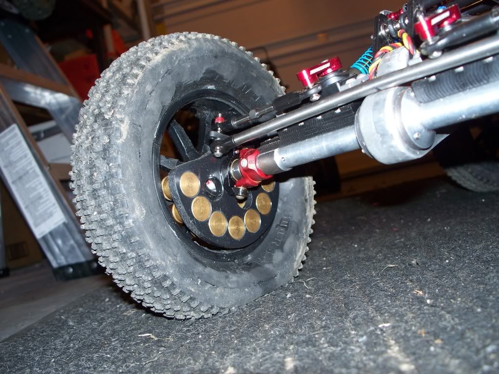

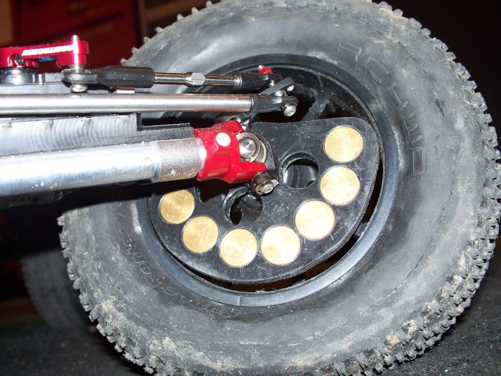

So I just got the knuckle weights done up. I was hoping to be in the upper 6lb range but I don't think I'm gonna be able to hit that unless I run less knuckle weight. Right now in these pics I'm at 6lbs 15oz all weighted up. I'm missing a battery mount and lipo as well as skins. So I will for sure be in the 7lb range rtr. Anyways all in all I'm real happy the way its turning out. Can't wait to get it out on the rocks.

nice work looks great. low 7's would be nice, with 14 oz on each side in front i am at 8lb 5oz
Ya I'm running a little over 7oz per side. So 14oz or 15oz total. I'm really not sure how much weight I should be running right now. I do have the weights out as far as I can get them as well.

I think your going to be right in the money on your weight. Mine is 7lbs RTR with 7oz of knuckle weight also. "thumbsup"
