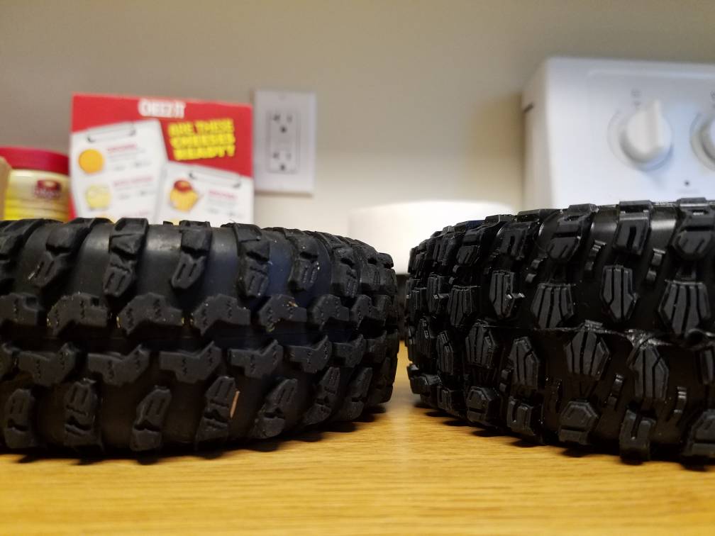

Wheel and tires - 2.2 RC4WD ROKLOX (5.55x1.69) with axial beadlocks which will be replaced with these brodozer wheels :lmao:

Looking good man!! Just got my AR60's on! We did some similar things to make it work haha. I went with 14.5" wheelbase for now. May tweak later.
& What size TSL's did you go with?
Love the taking out the trash pic btw haha.
Sent from my SAMSUNG-SM-G930A using Tapatalk
Damn dude that truck is turning out real Nice! I only did 15in cause that matched the bodies wheelbase. I ended up going with 2.2 proline hyrax with 6.0 crawler innovation foams. Soft front/medium rear. Also changed the shocks to 118mm front/120mm rear. Seems to work good just needs more weight
