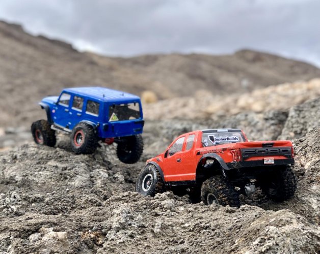

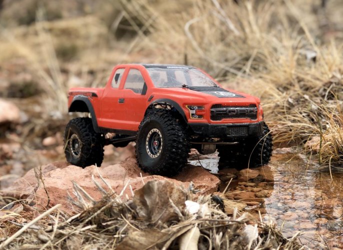

That’s about it. Here are pics of the finished build as it is today. Got 4 hours of trailing in Sunday and enjoyed driving it very much. Hopefully it will be a toyzuki come May. Thanks for the read!

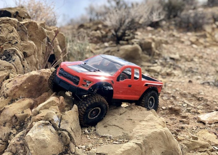

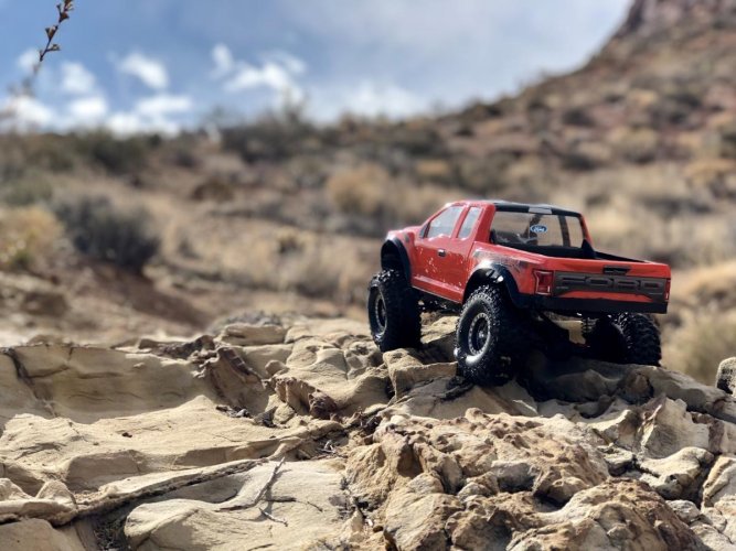

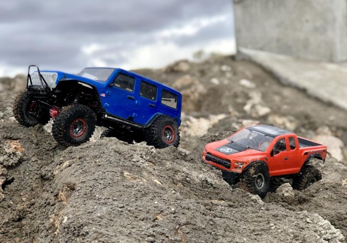

Suspension tweaks made a healthy difference and the truck is flexing and stable and predictable. Current set up is 10w oil and traxxas orange springs up front with 25wt oil and ssd springs in back. Here’s some flexy and tuck pics.
Also added the silver ssd diff covers for a little pop.

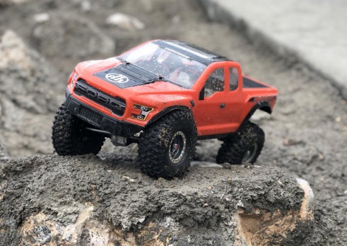

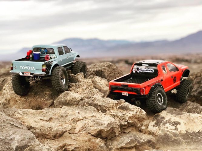

Finally had free time to put some work in on the truck today.
First order of business was a little more shock tuning after the plastic balls seemed to be limiting movement a little bit. One looks like it got damaged from over tightening (whoops). Changed them out with some metal balls and everything is moving freely.
While I was at it I outboarded the shocks a couple mm by adding a spacer to the lower mounts, and mounting the shock on the lower hole with the link. Still have to do the back but I need one more 3x25mm screw. Not sure if this will be permanent but giving it a shot.
Lastly, the Samix front battery tray and servo/bumper mount got installed. The battery lays down nicely now and the zippy pack 3s are pretty flat so it looks to be a good fit. Before the zippy pack was on its side and sat higher up.
Hitting the rocks tomorrow to see how all this works out.

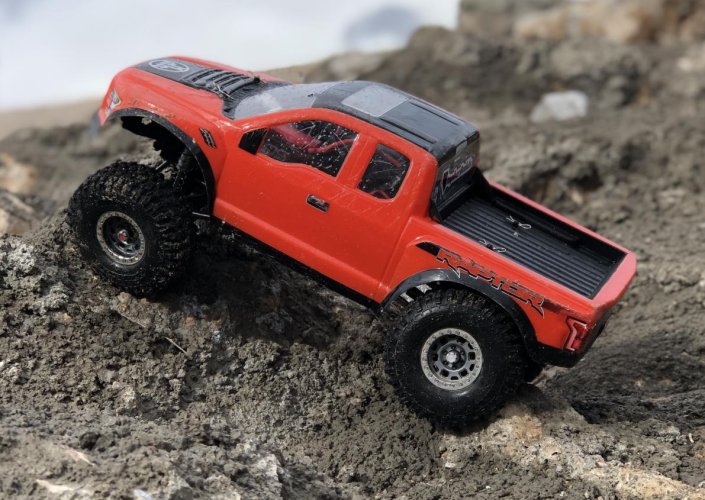

Got out today and had a great crawl, very happy with this truck to the point where I’m not sure I want to break it down for the toyzuki anymore, and may try and build a toyzuki from scratch over time.
Here’s a clip and some pics from today
