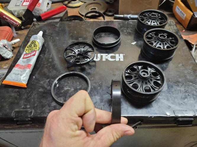

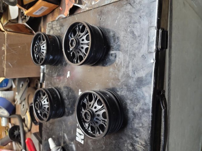

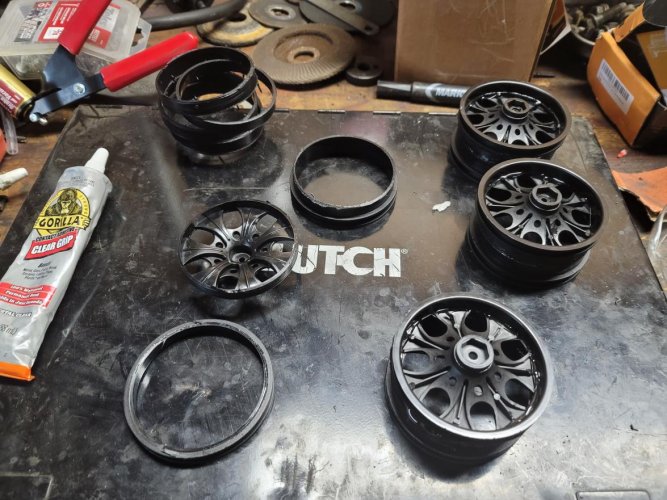

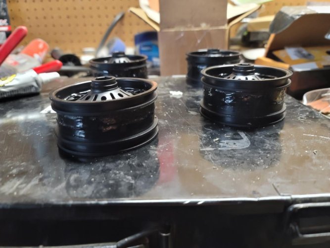

Shout out too egoaudio, those fatty tires are for the the mad torque which are like 1/8 scale, and man are they awesome I grabbed a set for the price and man after some modding they are amazing. I cut the wheels to make them have a deep dish so I wouldn't have to buy hud extensions, and narrowed them about 3/8 of an inch so the the side wall was more aggressive, then I removed the foams completely, and soaked the tires in WD40 over night to make them softer, they are hands down for the money probably the best mod to date, after I was finished with them anyways so great find ( egoaudio ). Big "thumbsup" P.S I ended up putting these on my sons box stock danchee, and I'm pretty sure his will out crawl mine now lol.
