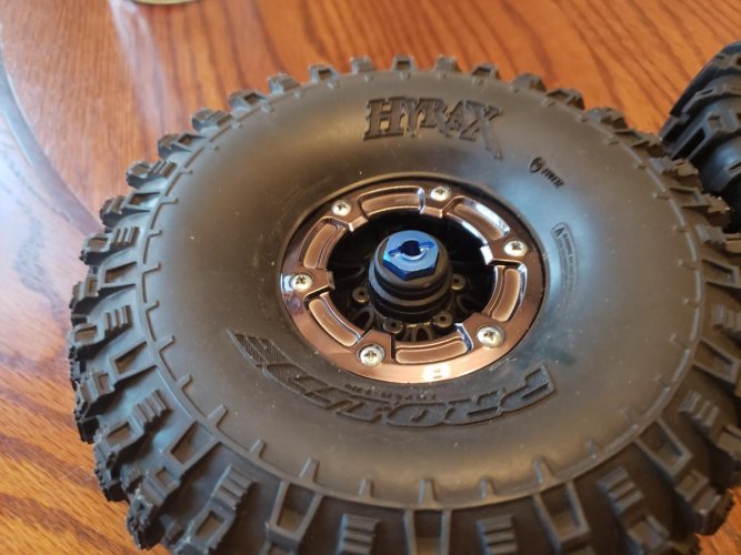

I think I might do the same. I just did the proline hyrax tires and added about 2 3/4 oz to the wheels. Picked up some sticky wheel weights from harbor freight and stuck them to inside of the wheel when I had them apart. I’m on the look out now for a metal MOA (motor on axle). I’m hoping I can find one that will fit! All the plastic worries me a little with the new servo!
Yes the wheels and tires on the danchee are the 2.2 size 100%. also here are side by side comparisons of a box stock wheel and tire vs my cut down wheel and with inflated tires. I cut 1/4 to 3/8 of an inch out of the back side of the rim, its easier to cut it from this side and you get more steering clearance and a wider stance this way. I then used longer strews to help secure the wheel and help alignment and straighten the wheel.
How much of a wheel spacer (mm) do you recommend to avoid rubbing body and links? Thanks!
charlieboyd65 If you just want to go with a wheel spacer for clearance ill put a link below to ones I have used and have had good luck with vs cutting the body shorter and cutting and shutting the wheels. If you use wheel spacers you will have to drill the wheel out to fit the new wheel nut. Ill put a link to a youtube video showing this process down below. Hope this helps let me know if there is anything else I can help with. I used the 12mm spacers because 20mm seems to wide to me, this is all imo.
