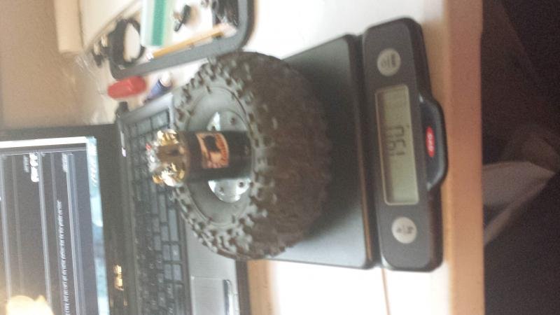

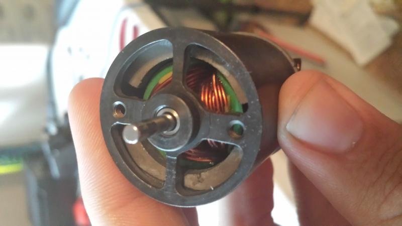

Brood 30t skewed arm Conflux with CB 20 (Cobalt) mags. A little heavier than normal mags but hey are so strong I couldn't get an accurate weight with it on the scale alone. Sorry for making you all read sideways. 190g
Eddie O is amazing to work with! He and I emailed back an forth for days so I would have just the motor I wanted. I will recommend his motors until the day I die.

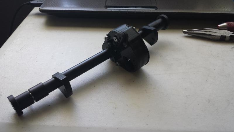

Rear axle buttoned up. Minus gears :-( . These are quite easy to assemble and every thing fits super snug. I still have to drill and do set screws for lock outs and link mounts.

Going to have ready for nats. drill the hole in case so you can remove motor and adjust gear mesh. Link mounts will be the last thing you do. great start lets see the chassis.:mrgreen:

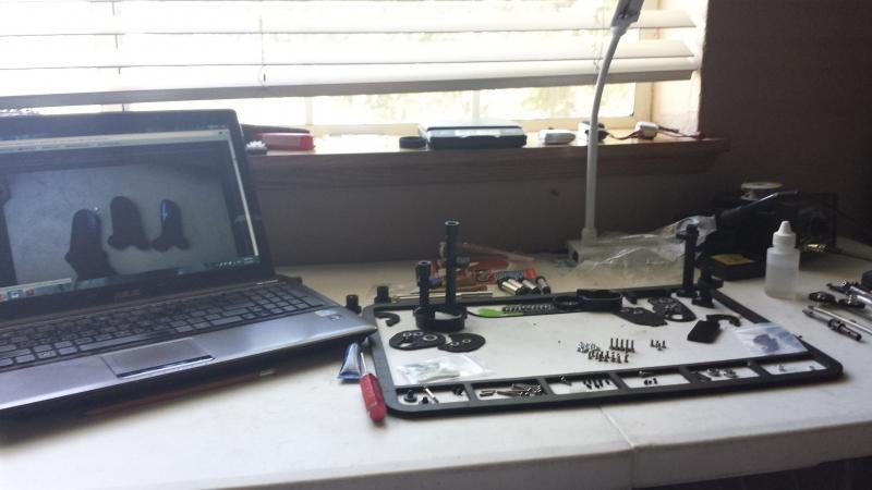

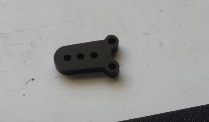

Moved on to the front axles. I want all of you reading to have as much fun as I am building. So I pose a question.
Form or Function?
