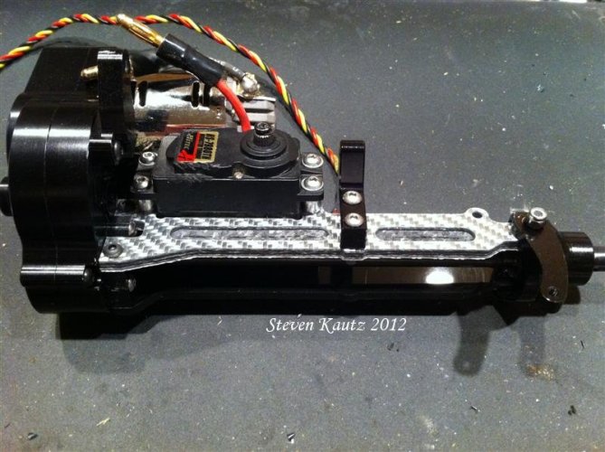

Got one side of the axle put together.

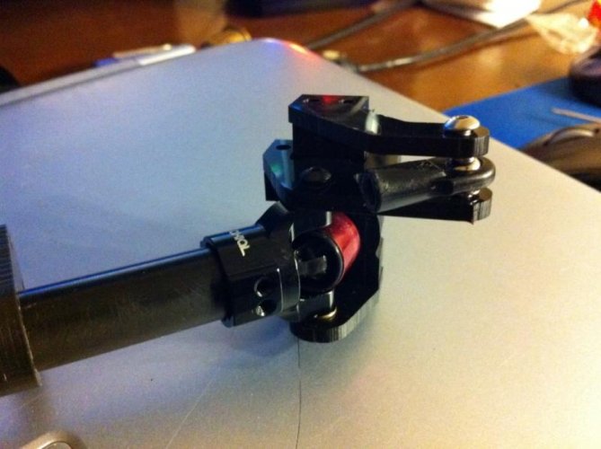

Picked up some of DLux's sweet delrin tubes and started designing some more parts for this thing.
I got the RC4WD lightweight knuckles, but don't really like how much material I will have to remove to get them to work. So....I'm just going to make my own knuckles. Pic shown is the current prototype. The horizontal plates will be carbon fiber for the final version. I have always had issues with bending the screw that hold the steering linkages on the servo side, so this is getting double shear for the lower connecting linkage. Should relieve enough stress to keep the top (servo) linkage in single shear and not bend the screw.
Also working on a simple servo mount to work with the new tubes. Nothing special for this thing, just a cf plate to bolt to the top of the tube.
