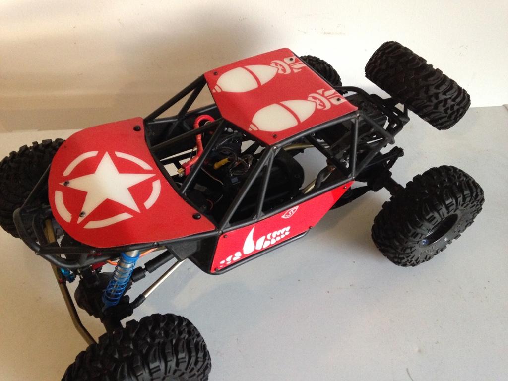

One more update today. I found time to do some terrible vinyl application to the body panels using my wife’s cricket materials.
It’s hard to get vinyl in around the body panels. Lots of heat and luck can do it. I originally did my RTR Bomber with vinyl to cover the ugly stock graphics.
We’ve got the Cameo Silhouette. I scanned the body panels into and then stuck lexan sheet to the mat. Used the cutter and multiple passes to etch the sheet enough to snap the panels out. Worked pretty good but you have to sand the breaks a little to smooth them out. If you wanted flat panels to experiment with. I did the same with my Bomber panels and then made some designs in vinyl. Stuck them to the inside and painted the panels. Removed the vinyl and sprayed another color to bring them out. Then sprayed a coat of black PlastiDip over that.
Wow that’s some impressive work! Vinyl can be a pain for sure; especially when the panels are nowhere near flat.

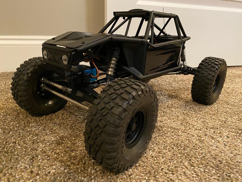

I’m not ready to paint anything so I opted for a quick wrap for this weekends big crawling trip. I went black in hopes that the camera hides most of the imperfections. I’m not too worried about it since it won’t be permanent.

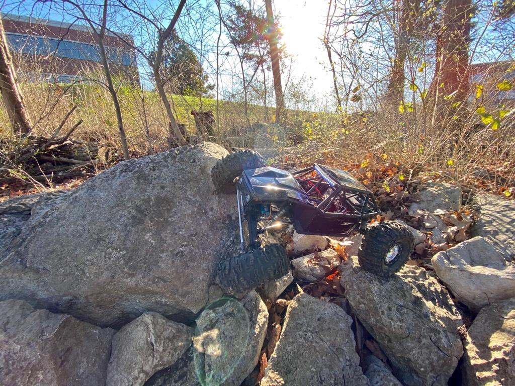

Did some crawling today. First time out with the Capra. She has her quarks but I really love the platform! Such a pleasure to crawl around with and definitely a solid geometry design.
I used today to feel out the new rig. Test it’s boundaries and find it’s limitations. I notice all the same things everyone else does with COG and shocks/traction. I think wheels weights and a little shock tuning are in order but aside from that I will just leave it alone for now.
