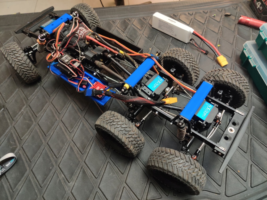

I reworked the middle axle setup, after trying some weird shit...
This is what I came up with:
Since both servos were going a different way I had to get some signal reversing modules (avoiding reversing the servo internally to make replacing on the trail easier). It seems to work fine, rear steer will be limited to 50% anyway due to tire clearance.
Made some rough inner fender, I'll tweak those once I'm happy with the suspension setup
Hopefully I can finally go drive this thing for the first time week end, and find out what breaks first :lmao:
Kinda rushed the bodywork to be able to drive it today as it will be pissing down tomorrow :ror:
Drove it for over an hour, nothing broke, climbs pretty well, 6ws with channel mixing is so nice.
Could do with a little extra weight up front, definitely needs proper shocks, not 100% happy with the color of the body and the high gear still feels way short compared to the AX2.

Got 4h of driving in this week, I'm starting to find issues and possible improvements
- changed the shifting setup for something more reliable and easier to service (almost went into a lake when the trans popped out of gear with the old setup :shock:)
- the tire foams are just gone at this point, grip is nowhere to be found :mrgreen:. New tires might happen sooner now
- motor is getting real hot. I need to work both of the gear ratios (i miss the AX2 and its huge gap :x ) and consider going brushless
Made some mirrors (foldable for narrow passages) and rock sliders since the last post
Got some bigger tires to fill those bigger wheel arches. They're the aliexpress kind, might not grip as well as the rc4wd but i can always upgrade later if I like how it handles with those
Still wasnt happy with the gear ratios, so I brought the good old AX2 back. Had to massage the shock towers a bit, but it fits :ror:
Drilled the box and made a longer axle for the fork to be able to shift from the spur side
Slowly getting towards a setup I'm happy with, but still lacks some front weight. I'd like to avoid adding weight, so I might experiment with underdrive/overdrive.
Don't mind the wire salad, I'll eventually sort it out when I stop moving electronics every month :mrgreen:
