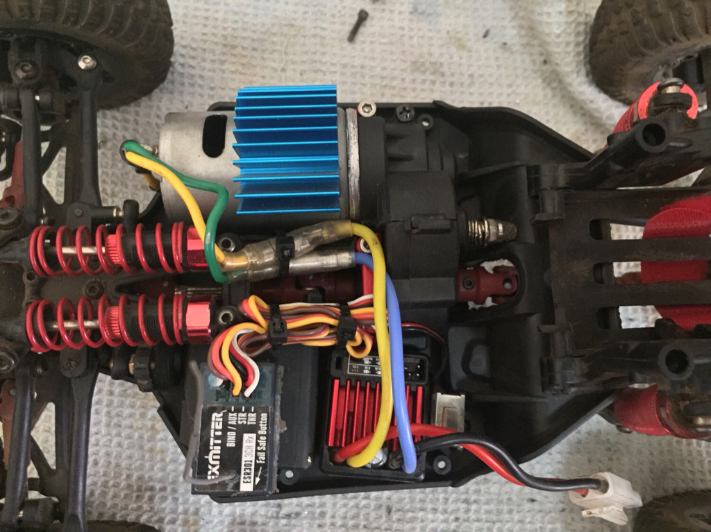

How's your fy03 running these days, Hugo? My friend and I just bought one apiece. I filed down and lubed the diff gears, shimmed the main diff gear, Loctited the 3 screws where they meet metal. Smallest pinion installed with Loctite and meshed. Slipper one half turn from full lock. Shocks adjusted as recommended. Fuel tubing o-rings between the drive pins and bearings near the wheel hexes. I left the light buckets since they can be replaced when they get worn down from roll-overs. Strapped the loose heatsink onto the motor using a zip tie the rig came with. Lubed the bearings. Lubed the c-hubs with graphite powder. Moved the steering ball to the inner hole, closer to the servo screw to give torque, slow it down, and prevent damage; still had to turn down the dual-rate a bit to prevent the servo from burning up when trying to get past the end points. Battery velcro'd down to keep it from sliding around. Probably some other stuff I forgot, LOL! Runs like a charm! Ordered some m2.5x20mm Hex screws off eBay for $1 to adjust the front suspension a bit. Working on installing a 5v fan on the motor.

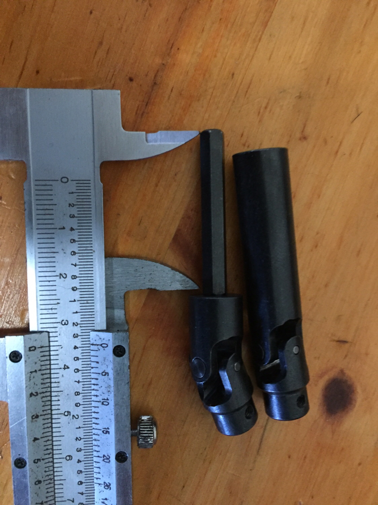

I have received the shafts in the meantime. They are fitted and its heavier but feels better on obstacles. Fitted an 20t pinion, a new servo and ordered some oil shocks which is still in the post. Also extended the upper links on the rear to fix the angle on the universal and fixed the toe out on the front by spacing the steering links with 3mm spacers.
Its dead slow with the 20t but unstoppable to the point that I feel the its going to eat itself with the 540 in it. The motor will probably break it before I do... just because it wants to keep on turning the wheels.

What rear driveshaft is that, and is it heavy steel or light alloy? Ideally I'd like to have buff lightweight plastic, but I think the outputs are too small for my Axial 10th scale stuff.

Its the 12428 upgrade shaft on Banggood. They haven’t shown stock on the Feiyue upgrade rear shaft in months. Its not great but it will do. When it wears I might order something beefier off ebay.
The heavy shafts helped the buggy with stability though.

So my eBay shocks rocked up. Filled them with oil and tried them out. The rears are perfect out the plastic, the front needed some attention. The stock springs were hopelessly too soft. I ended up cutting the seat ring off the FY03 shocks trying to get the initial tension of the springs to be lower. It seems like its working and I’m happy. No more bouncy China Buggy!
Also swopped the Mabuchi with the Austar 45t I bought for the D90. Used the 26t pinion that came as an extra with the kit. Speed is still perfect. Can go slow with no issues. Power seems good over obstacles.

I ordered the replacement parts and the stock 390 motor when I got home. Parts arrived in the week and got fitted last night.
Treated the diffs with some proper grease, locked the screws with stud lock and fitted the 26t stock pinion to the 390.
Running it FBR on the 1060 now. It will be the basher for my friends from now on.
Speed isn’t bad and the power still usable for some trailing.

The proper rear drive shaft rocked up. Nice part for the money. Now all the shafts are the same type.

Its been a while now and the 390 started to loose power. It actually came to a halt on the weekend. Lol. So we are back to a Mabuchi 27t! Its soooo much better! 26t pinion. I swopped the 1060 out with a programable Racestar 60A though. Its a horrible esc but with the very limited programming I actually managed to get the 540’s power delivery and brake set up way less aggressive than on a 1060. It doesn’t wheelie off the bat anymore but has decent top end. Should be ok on the diff pinions.
