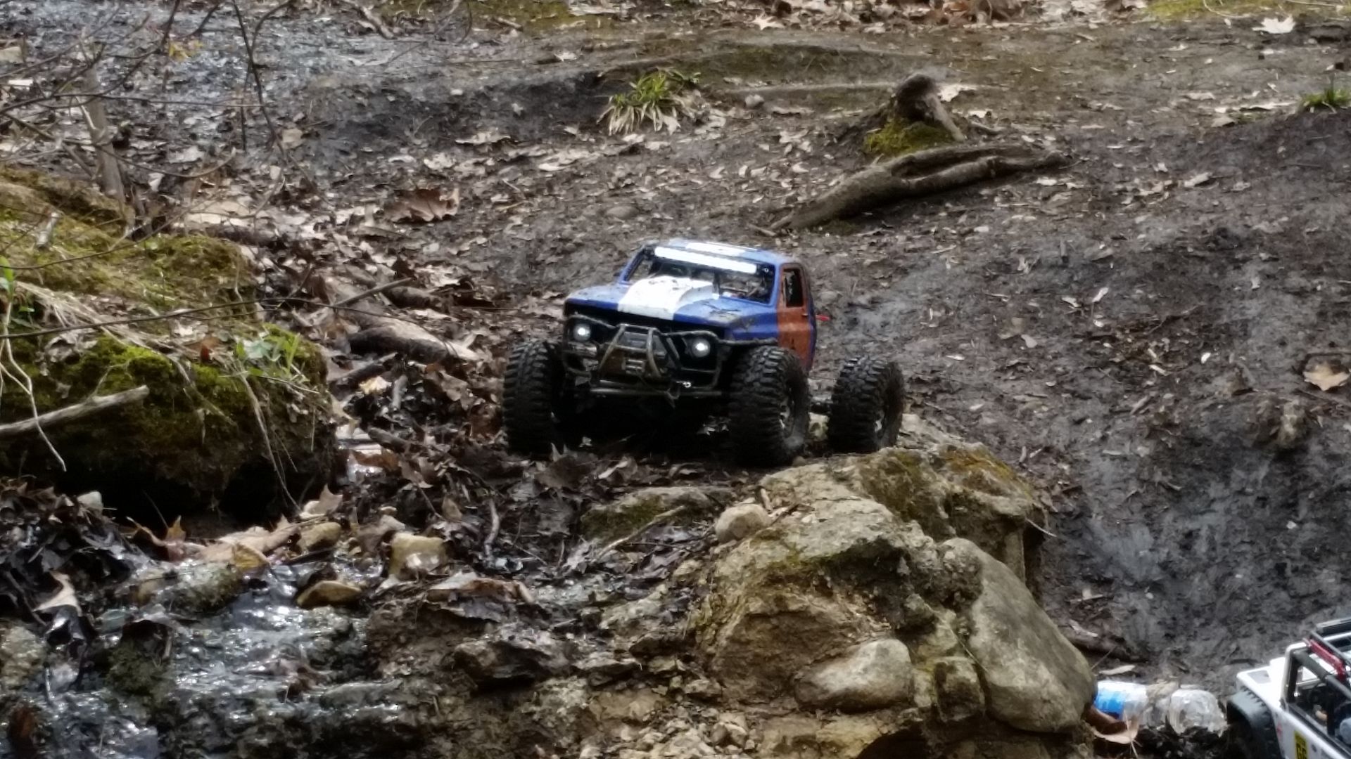

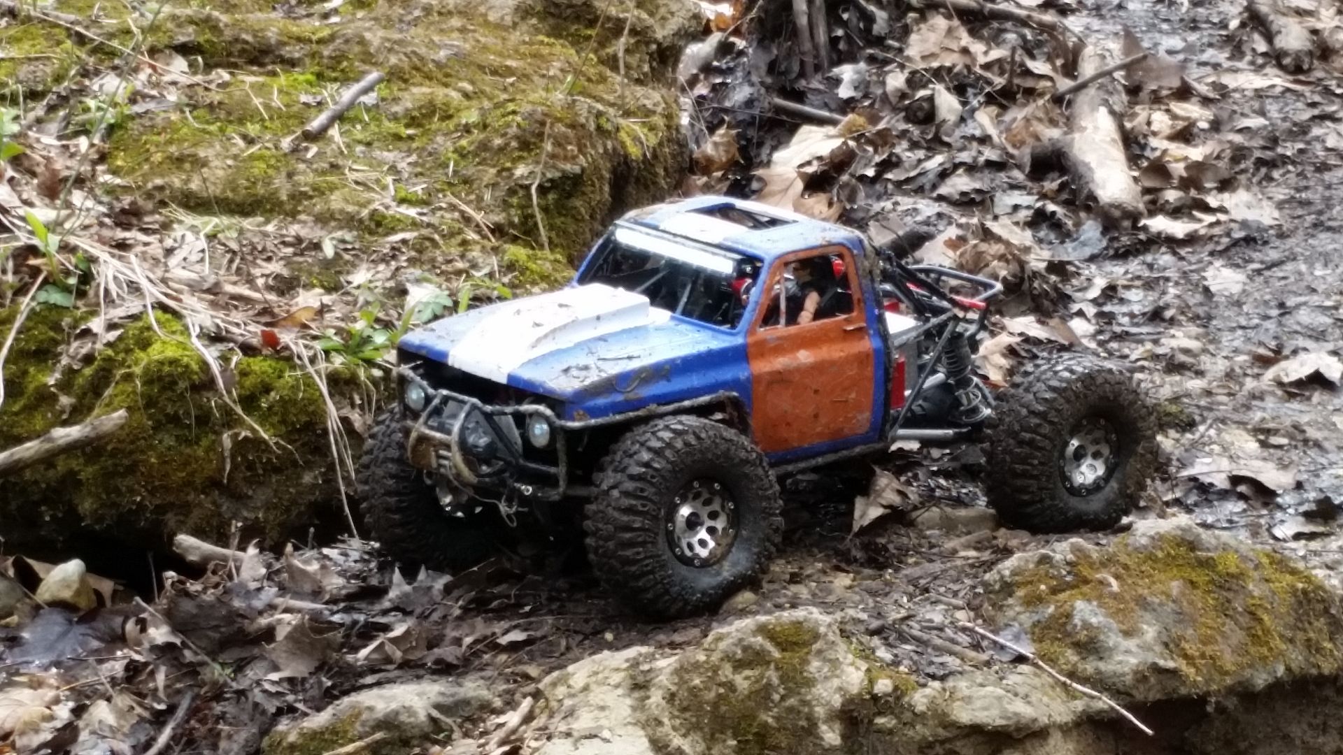

Clod Truggy time!
Action shots...
Very cool to see the Clod still out and about. I also like what you did with the winch mount."thumbsup"

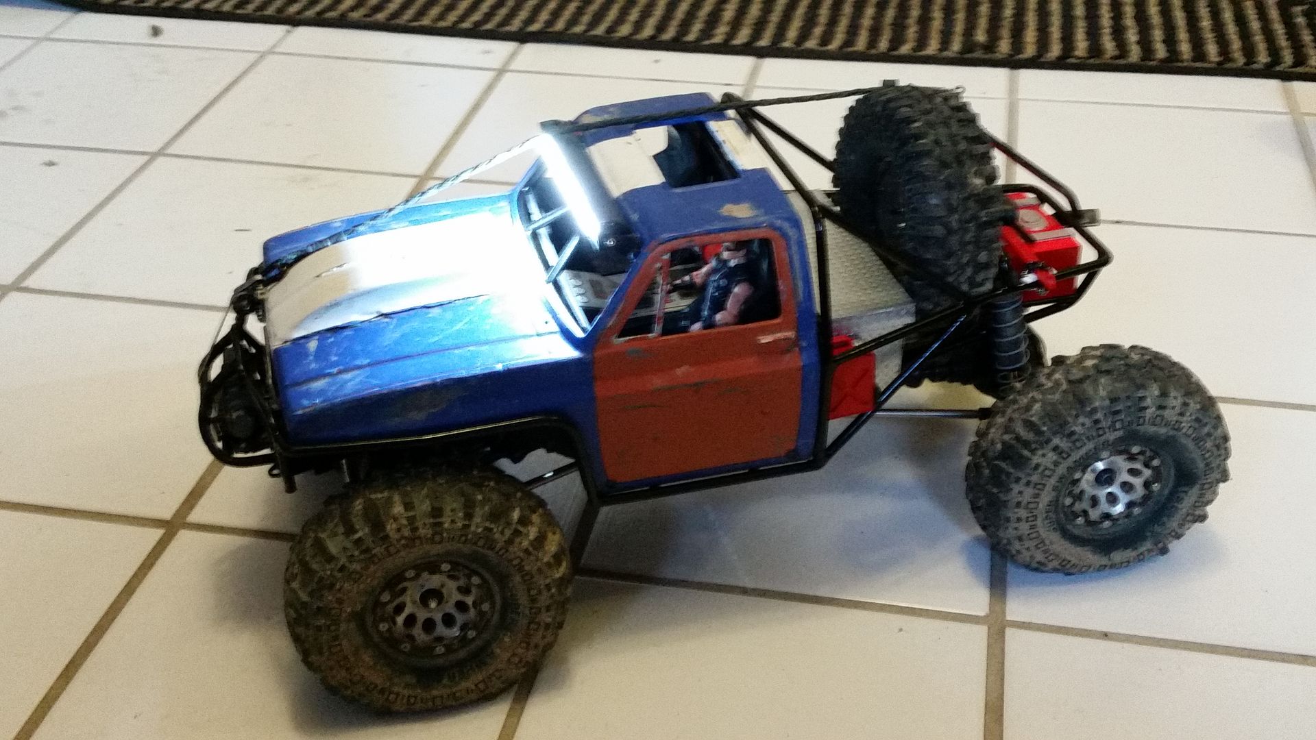

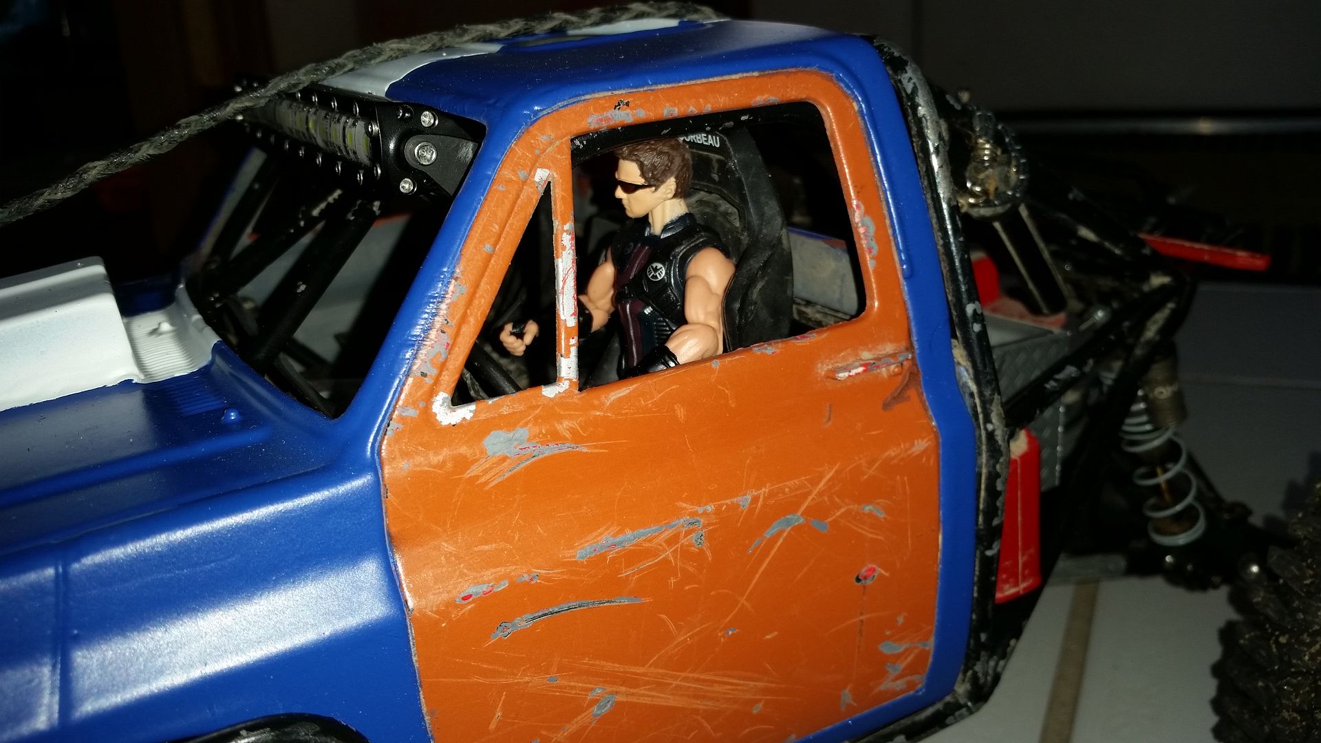

Well I revamped the Clod.
Now it has the following:
  • Vanquish Lightbar
  • XR-10 Width SCX10 Axles
  • Vanquish Chubs, Knuckles, and Lockouts

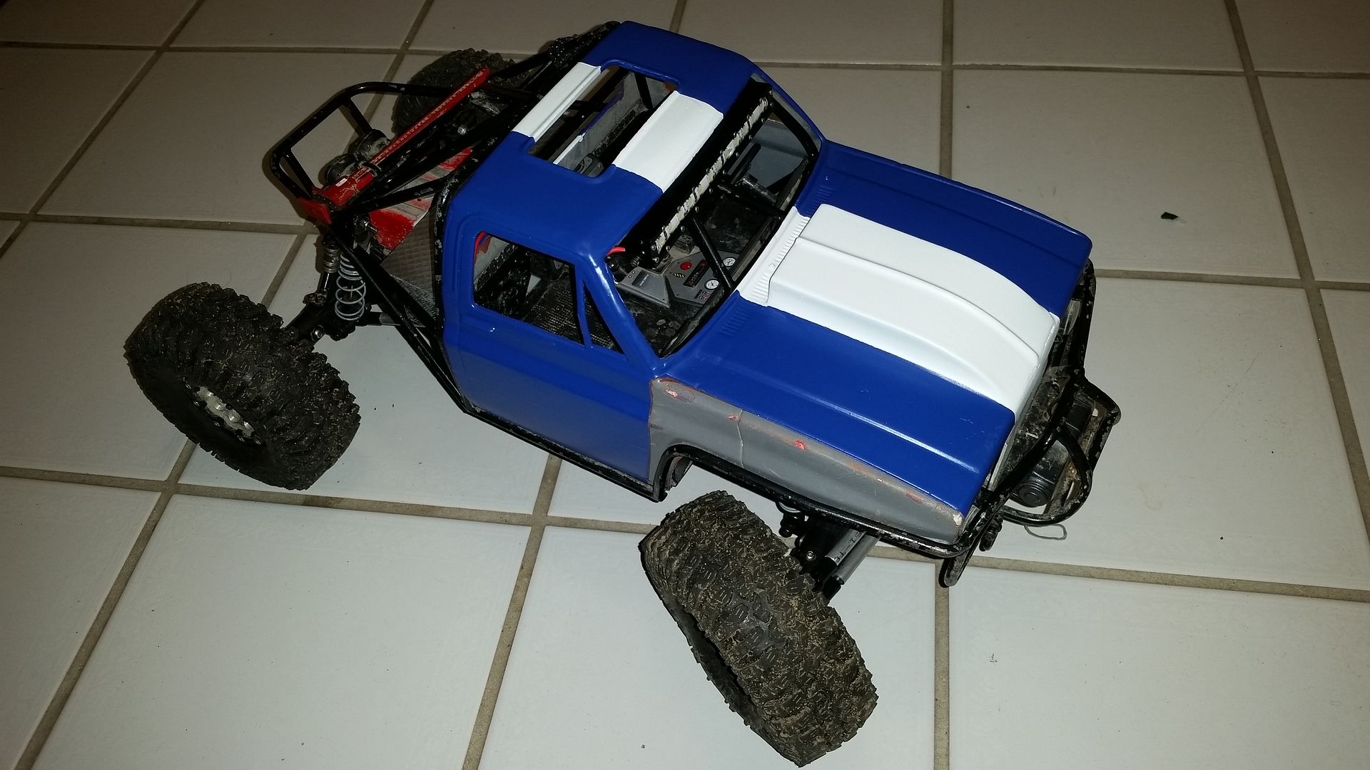

Revamped the layout of the eletronics, moving the battery from inside the cab into a 'tool box' that was built to contain it. All the electronics were moved into the cab where I was putting the battery.
This has lead to bit of a trade off. With the battery in the cab I was only able to use 1300mah 3S batteries, which did limit the run-time when doing more of a G6s, etc. With the switch, now I can use 2200mah batteries and no longer need to remove the cab and the interior to switch out batteries.
The downside is that it does bring up the CoG a bit. However, it also shifts the CoG backwards too which was always an issue I was fighting with the truggy, especially given the short wheel base.
So we'll see how the trade-offs work!
