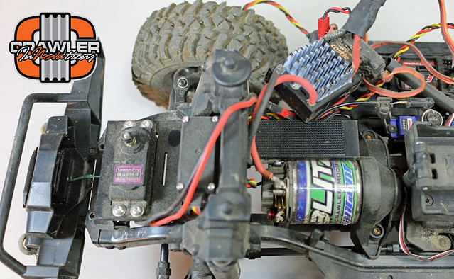

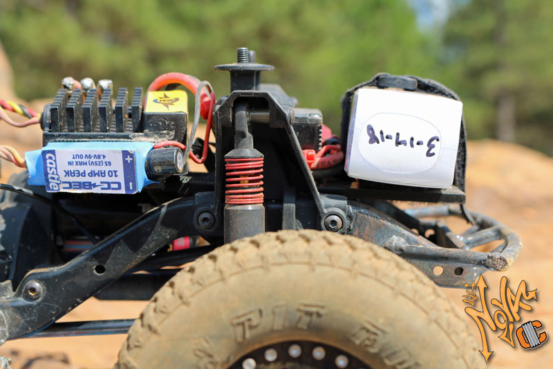

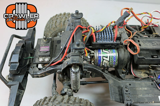

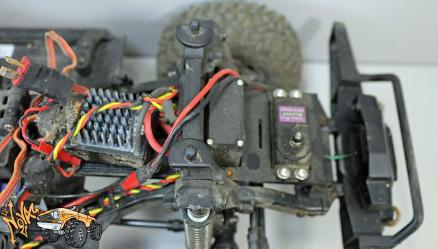

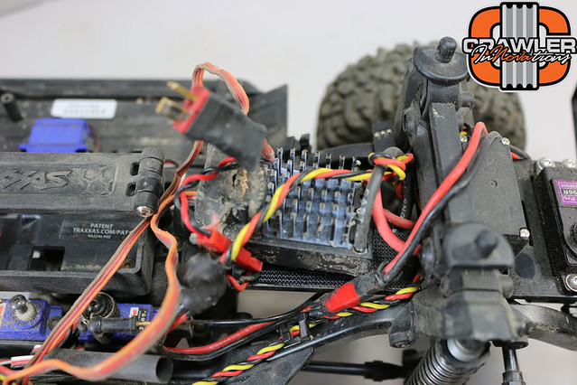

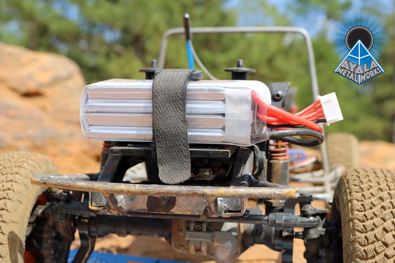

CI acquired the 2nd TRX4 so that it could be used with our Traxxas TRX4 Front Electronics Tray; P/N CWR-5015 pictured with a servo winch installed:
Installed electronics in the 2nd rig as pictured are:
Hitec 5645MG servo
Castle Creations Sidewinder ESC
Castle Creations 10A BEC
35T brushed motor

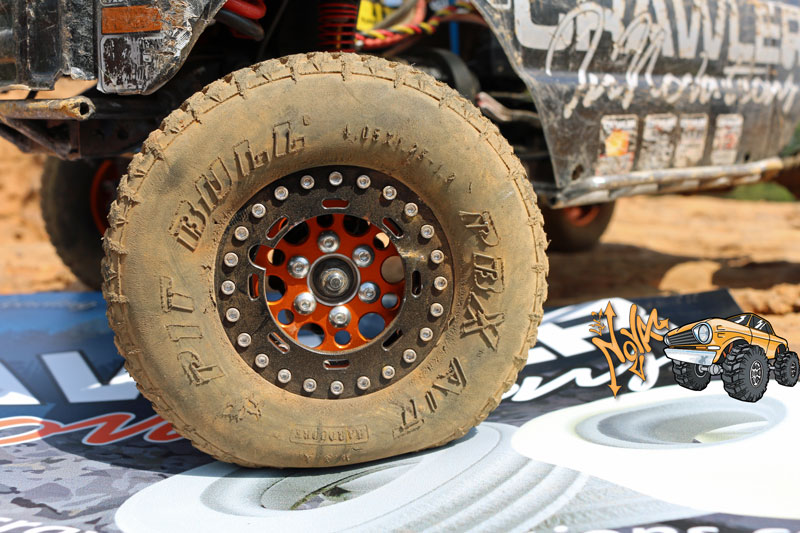

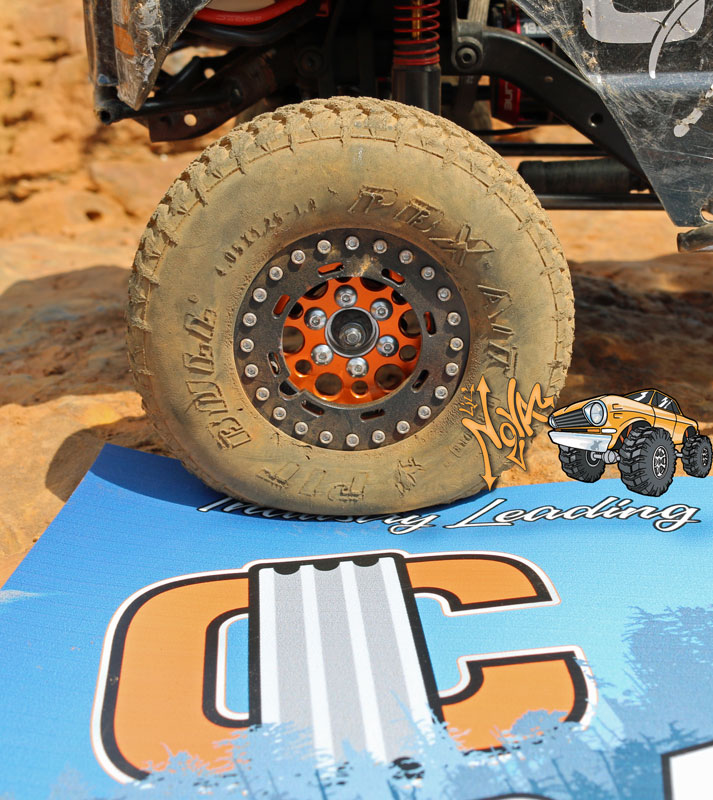

Vanquish Products - 1.9 OMF Bead lock w/ IBTR rings
Pitbull Tires - PBX A/T Hardcore
Crawler Innovations -
Lil Nova 4.0 Standard / Medium Outer CWR-2092 Front
Deuce's Wild CWR-3006 Rear

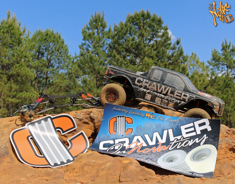

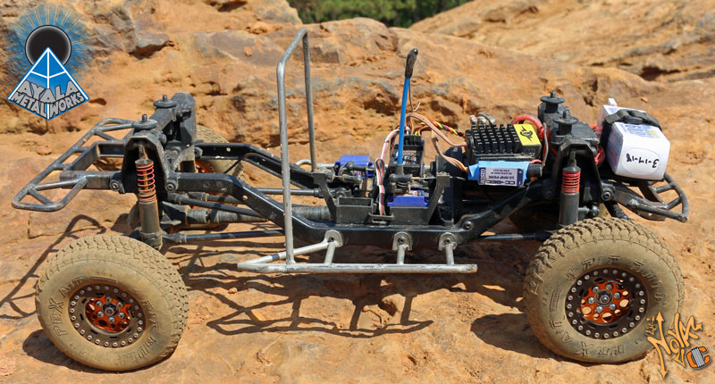

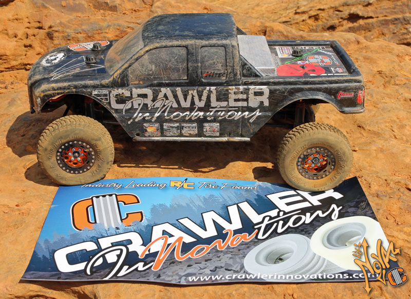

Same truck, no real updates to report other than the wheel tire and foam change. On to some current pictures taken at Barnwell Mountain ORV park.

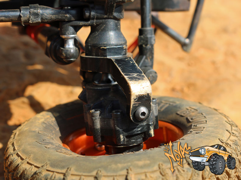

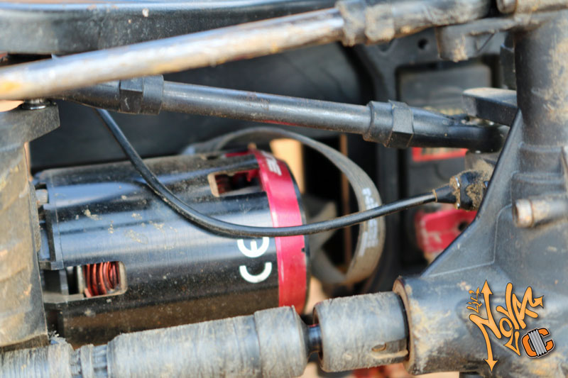

The brass parts are holding up well:
The TRXFERD pictured with "The Formula" a 2.2 competition truck build:
Gavin on the rocks at Barnwell Mountain;

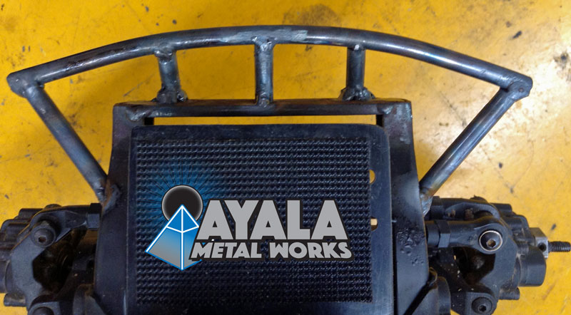

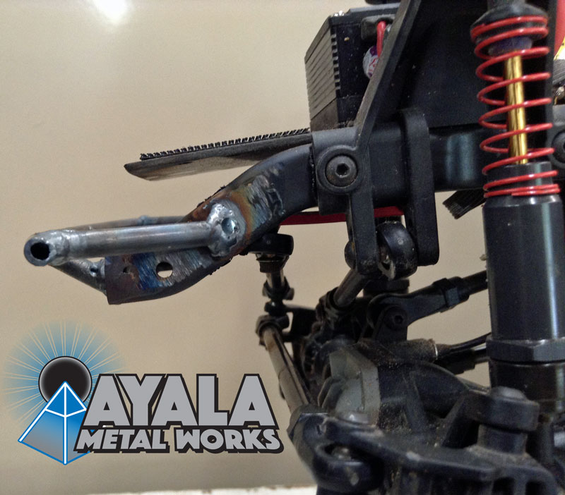

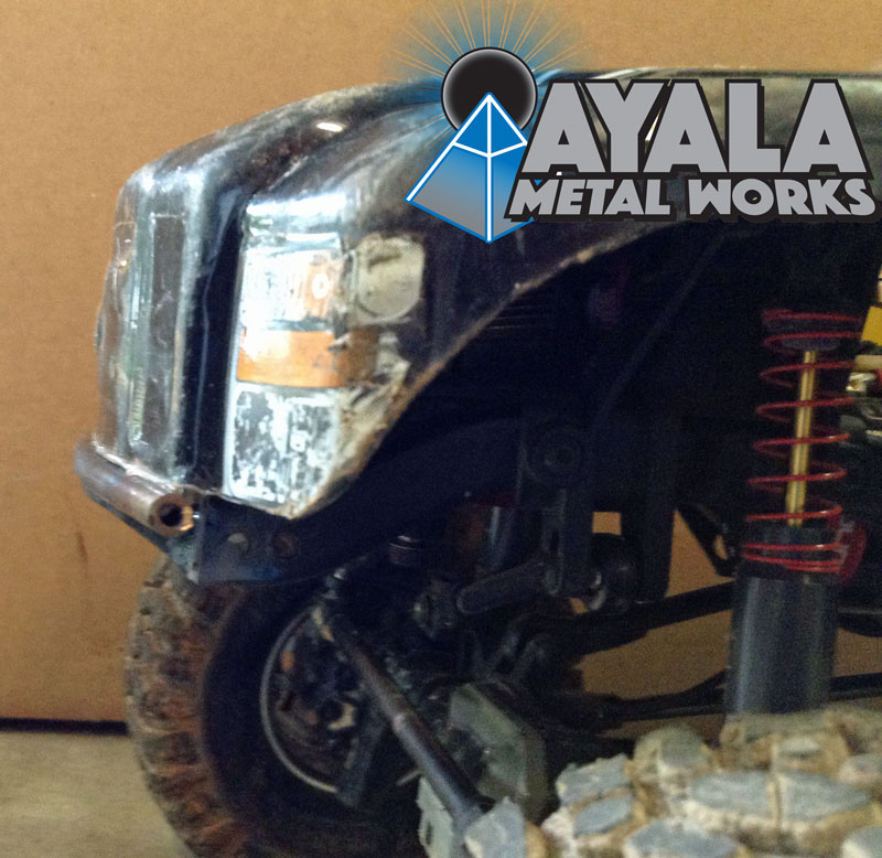

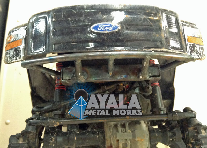

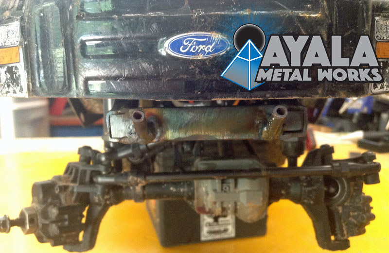

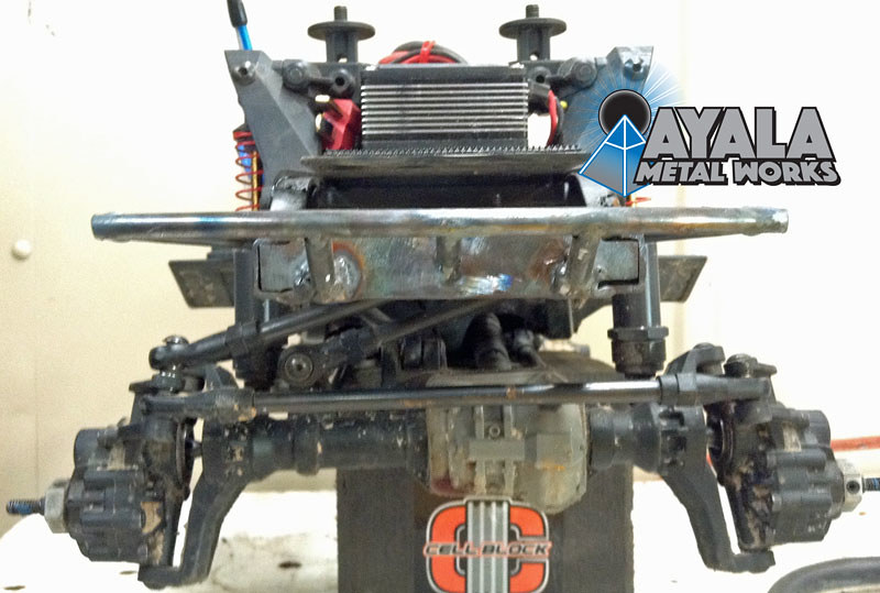

Pictures of me building the front bumper. The first bumper I made out of 1/8 rod with a flat bar notched into the frame and TIG welded. This bumper didn't last long.
The second bumper I made out of 3/16 DOM tube with some 3/16 rod. I reused the flat bar just cut off and ground the old 1/8 rod bumper off.
I curved the next tube to the body line.
More
The center bar support is 3/16 rod and the 2 corner bars are rods as well. The rest is 3/16 tube.

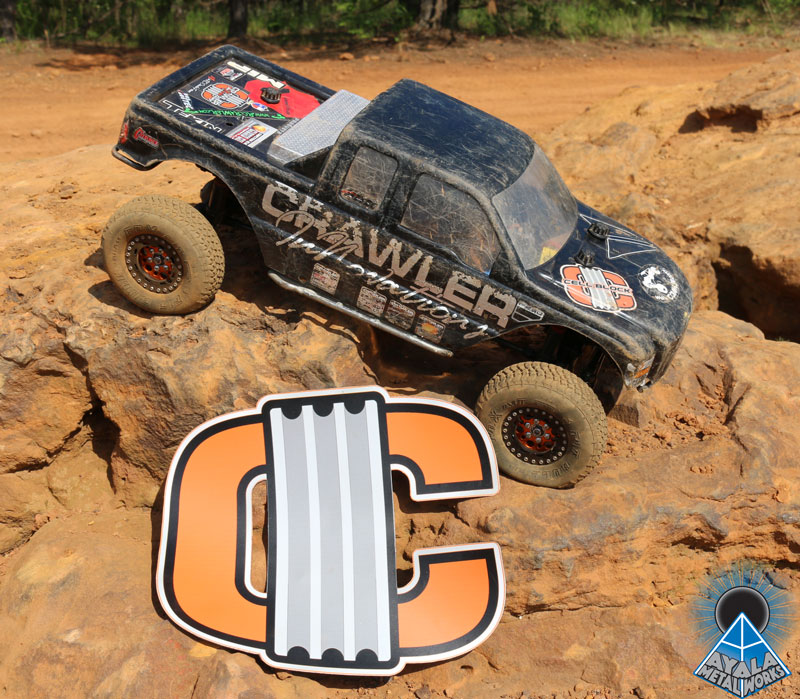

I am behind on updates for this TRX4. Over one year later and it's still together and running. I've never kept a RC vehicle this close to stock design before. Some upgrade parts arrived yesterday and some new CI stickers have been added to the body.
That wheel and tire combo sure suits the big Ford truck body - tho' I would have left the stickers off the roll-down side windows, personally... ;-)
Thank you on the wheels and tires. Unfortunately the tires have been a disappointment in terms of performance compared to the Pitbulls we regularly use. I will be removing the tires soon, especially since I've busted some of the stock gears and have the machined versions to replace them with.
As for the stickers, after 25 years in the hobby, this is a toy truck. Scale has become the new term for modeling and that's not my interest. I drive and build rc toy trucks to push their performance to the limit to learn what is possible. And besides, if I don't represent my own company and brands, who else will?

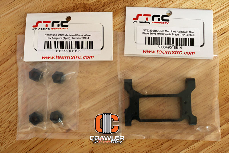

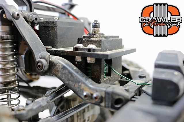

After breaking several of the original thickness trays just before the steering servo, and talking with a couple customers who had as well, a change in the thickness has been made.
*Updated*
New Version
Now Shipping
*5/9/2019*
New thickness of 3/16th / 0.1875" / 4.762 mm !!!
These still install using the original Traxxas servo hardware. At least the hardware that came with our TRX4's both worked with these.
