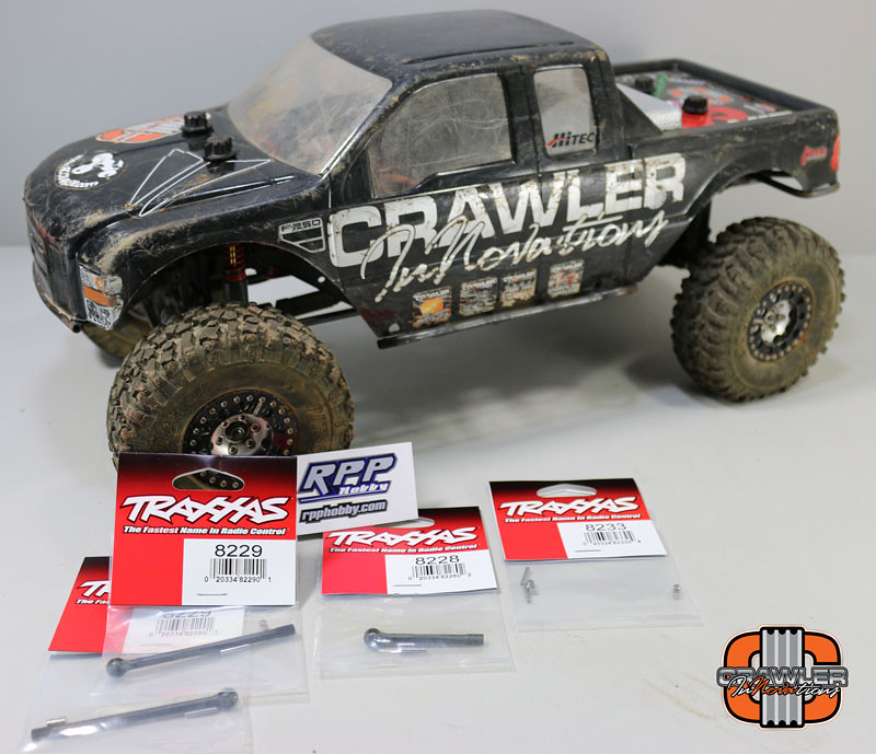

After two months of use, I finally broke my first part on the TRX4. It was from driver neglect on course and the truck took a hard fall that partially broke the right front axle shaft. One side of the CVD machined end broke off, the opposite side was still connected allowing the truck to run. Thankfully RPP Hobby had the replacement parts in stock.

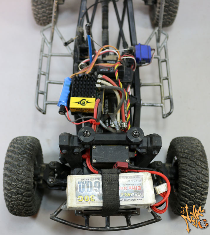

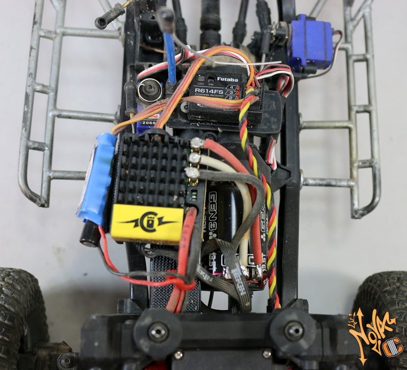

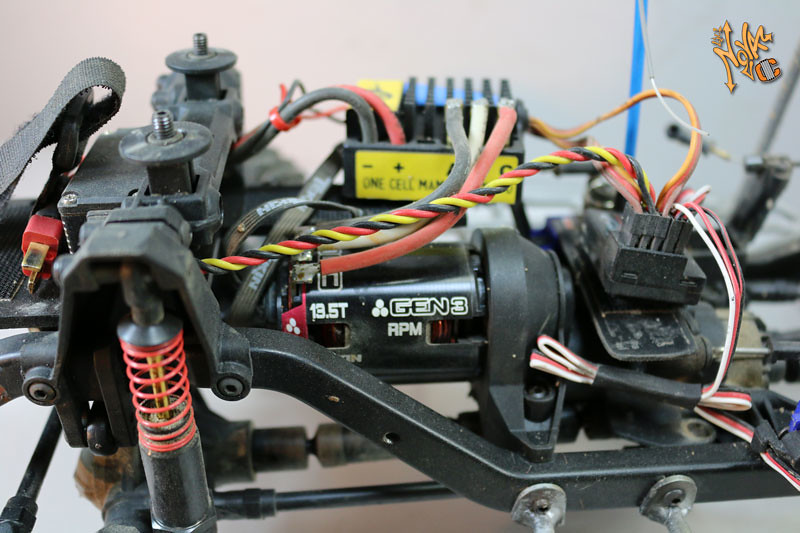

The stock electronics lasted the first day. Once the brushed motor gave out, I parked the TRX4 for a couple weeks. I was distracted with repairing my jeep among other things. When I did finally get back to the TRX4 a few weeks later, I removed the factory electronics. I installed:
Castle Creations One Cell ESC
Castle Creations BEC
Tekin Gen3 13.5 sensored brushless motor
Hitec 7954 steering servo
Futaba 4PK tx & rx
4S Lipo
I still have the factory micro servos installed. I only have the Two Speed transmission and front axle servo working. The rear axle servo is locked to keep the axle locked.
This combo has been fantastic and the TRX4 has been my personal "go to" rig. As the previous post mentions, I just broke the axle shaft last weekend. That's a lot of run time on 4S. I have been very impressed and pleased with my TRX4. Mine is far from stock though. The stock shocks are terrible. I removed mine for a set of Traxxas 3.5" Big Bores with Mini T springs. The suspension cycles so much smoother and is much more controllable. Also ditching the factory body for a simple lexan body has been enjoyable. More to come on this rig.

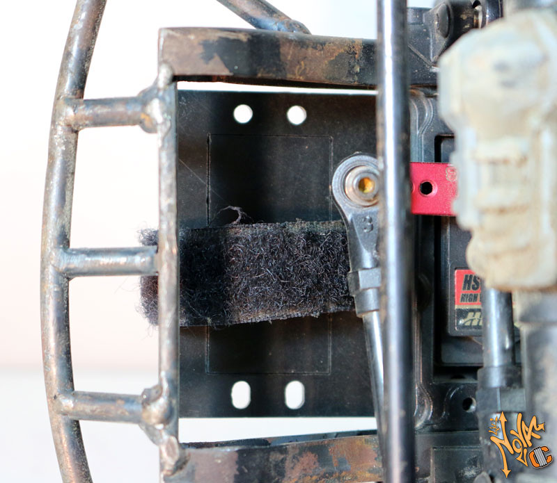

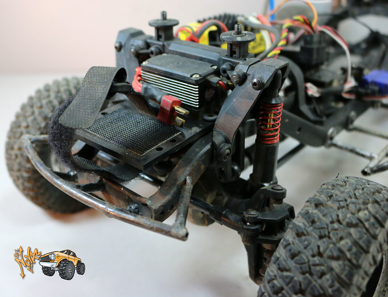

Crawler Innovations bolt on electronics tray for the front of the Traxxas TRX4 scale crawler. The tray is cut from 1/8th black delrin for strength and durability. The purpose of the tray is to move the electronics to the most forward location to increase front weight bias for competition RC rock crawling. The front part of the tray can serve as either a small battery mount, or the knock out plate can be removed to allow for a standard size servo winch. The electronics plate is cut to accept a standard Velcro battery strap. The rear of the plate extends towards the transmission along side the motor to allow for esc or receiver mounting. This electronics plate installs by removing the factory servo screws, feed the steering servo lead through the opening in the plate, and then re-install the factory bolts. This product is made in the U.S.A.
One Tray is $14.95

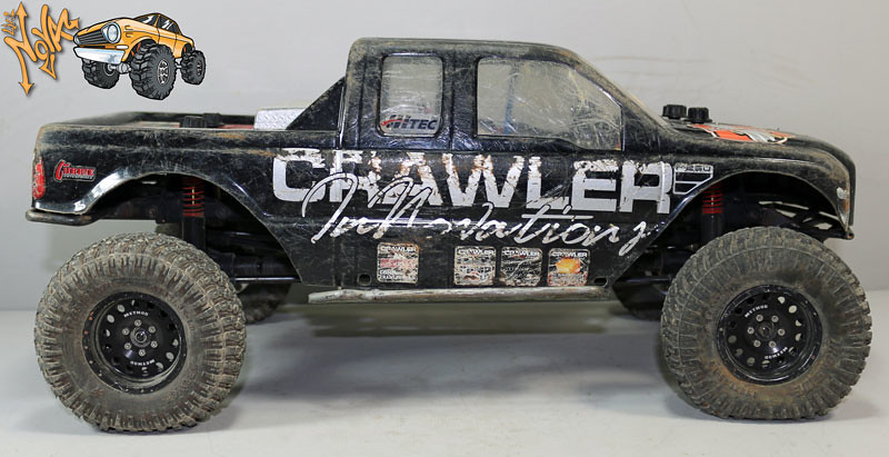

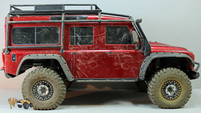

An over due update on the unboxed TRX4. I see no real reason in creating a new build thread for this truck, as it is the same vehicle from post 1. It will be neat to see how long this car stays together and what directions it takes in the future. It's current conditions:

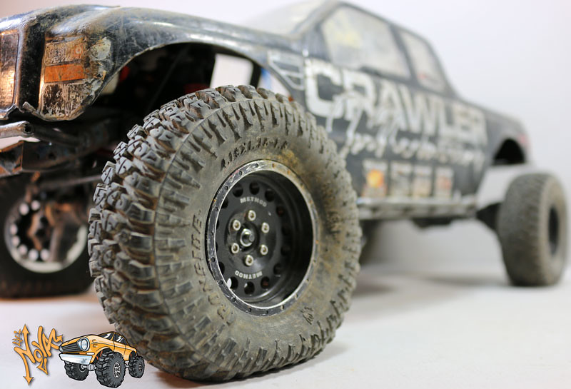

Vanquish Products / Incision Method 1.9 MR307 bead lock
Pitbull Tires 1.9 Braven Tires
CRawler Innovations Lil Nova Foams:
CWR-2092 Front = 4.0" / Medium Outer
CWR-2093 Rear = 4.0" / Firm Outer
Traxxas 3.5 Big Bore shocks P/N 2660
Jeepindoug Mini T spring Cups
Losi Mini T front spring set
Jeepindoug 5mm ball studs

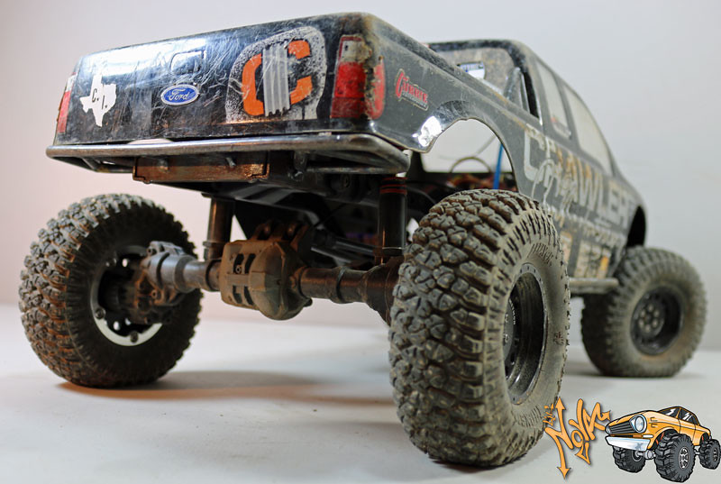

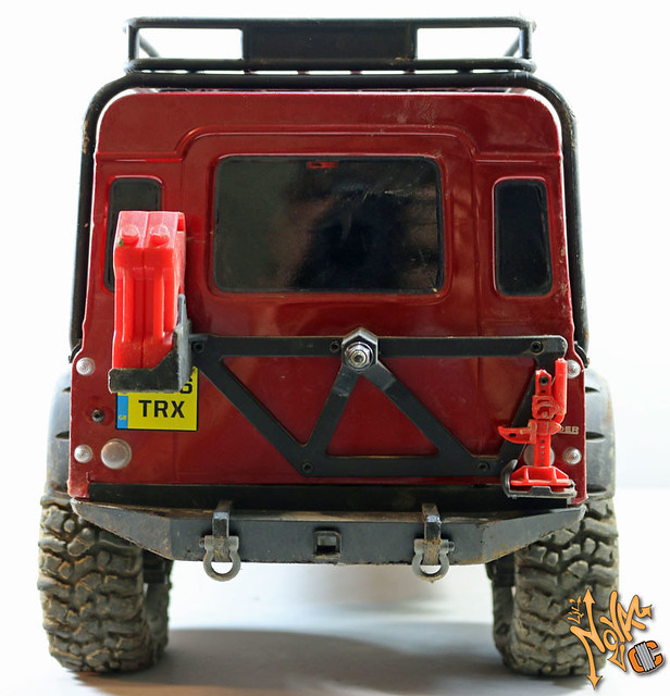

The rear bumper was created by my son Gavin of Ayala Metal Works:
Futaba 4PK tx & rx
4S Lipo
Crawler Innovations TRX4 Front Electronics Tray CWR-5015
My son Gavin of Ayala Metal Works created the ultra simple and strong front bumper:
Another view of the electronics:
A better view of the Jeepindoug 5mm Ball Studs:

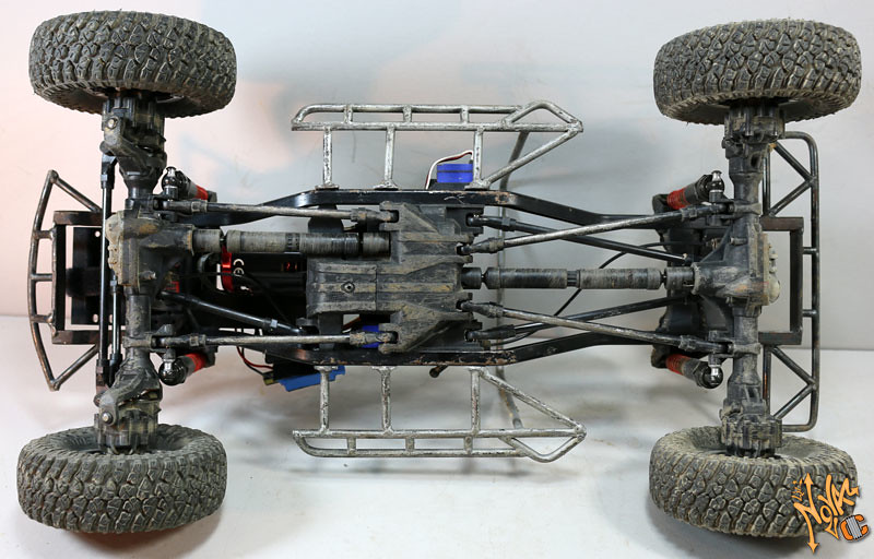

Underside view:
This view is to show the underside view of the installed CI electronics tray:
Value Hobby 4S 1600mah lipo battery:

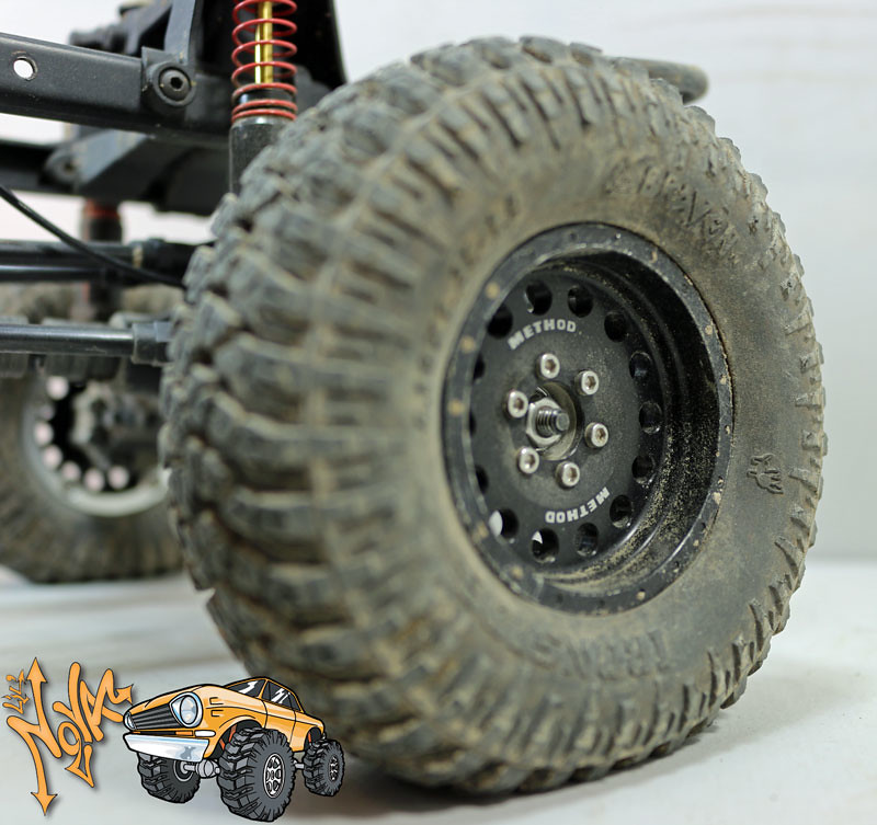

More wheel, tire, and foam goodness.
Crawler Innovations Lil Nova Foams:
that little 13.5 probably screams on 4s.. can it handle? lol. id say that's a well used trx4.
This TRX4, or "The Ferd" as Gavin & I refer to it as, is definitely my "go to" rig. It's extremely durable and always running. As a person collects rc's or builds rc's as the years go by, it's easy to have a collection of not running rc's. When one breaks, just grab a different one and carry one. Especially if a person has limited free time to actually run them. Also, high performance RC's require maintenance, and if it's not done, the parts fail. So far this TRX4 just keeps on going and since it does, it's time for upgrades.

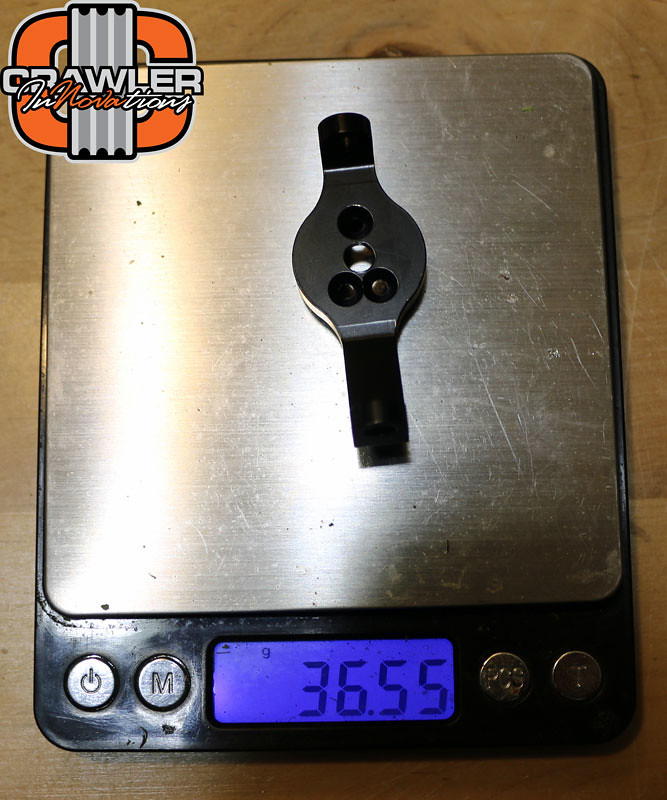

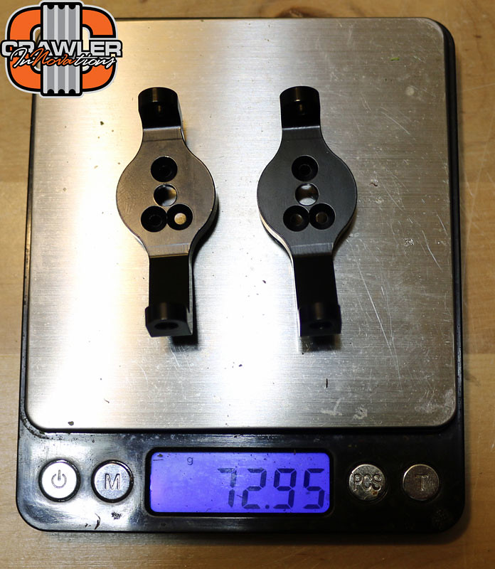

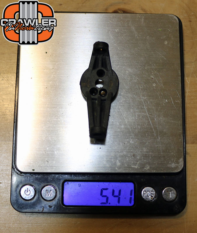

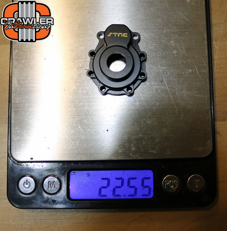

Brass Portal covers and Brass Axle C's;
The weight of the factory plastic;
The weight of a single brass cover;
Both covers together;
Factory plastic axle c weight;
Single brass axle c;
Both of the brass axle c's together;
I have it geared down. I want to be able to technical rock crawl with my TRX4, then switch into high gear with the ability to do donuts at will. The rear axle is locked while the front is select-able for better and controllable donut action.:mrgreen: I have used this combo for nearly a decade now. If you search my early build threads, the Tekin 13.5 on 4S with a Castle Creations MMP controller has been our standard electronics set up. Not only for crawlers, but for drifters and on road cars as well. The drifters and on road use 3S instead, but they run for hours on that combo when geared correctly. Thanks for the comment"thumbsup"

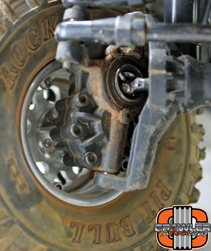

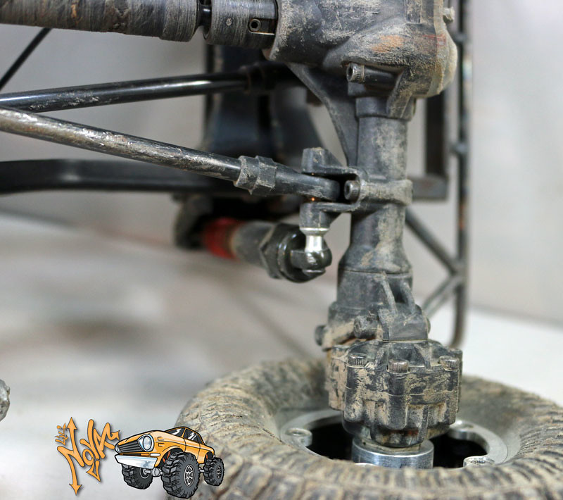

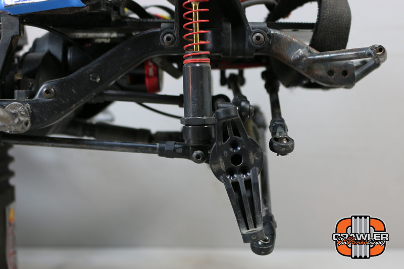

Something to be aware of... not all "bolt on" replacement parts are made the same as factory specs:
Factory Traxxas C, notice the positive caster and how much the top of the C is leaning back toward the rear;
STRC Brass C, notice it has less positive caster and has less of lean towards the rear of the vehicle at top;
Factory Traxxas C, notice the positive camber and how much the top of the C is leaning back toward the rear;
STRC Brass C, notice it has less positive camber and has less of lean towards the rear of the vehicle at top;
Interesting. Good info! "thumbsup"
How has that affected performance?
Thank you.
It has been hard to tell if it has negatively or positively effected the steering. The addition of the brass weight made a noticeable improvement, so much so, that I think it might be masking any effects of the loss of caster. I only have about an hour of drive time on the car with the new changes, so maybe after more drive time, I will notice it.

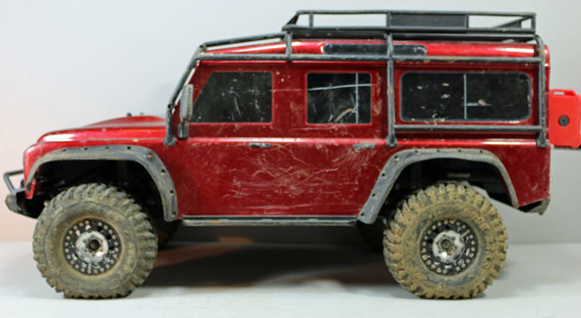

CI traded for this second TRX4 sometime ago. It needed some assembly and electronics. Here it is next to The Ferd;
Pretty straight forward;
Vanquish Products 1.9 KMC Enduro XD222 bead lock wheel
Vanquish Products KMC Enduro 1.9 beadlock ring black anodized
Pitbull Tires 1.9 Rock Beast original
Crawler Innovations 4.50" Lil Nova Foams; Comp Cut;
P/N CWR-2025 front; CWR-2026 rear
