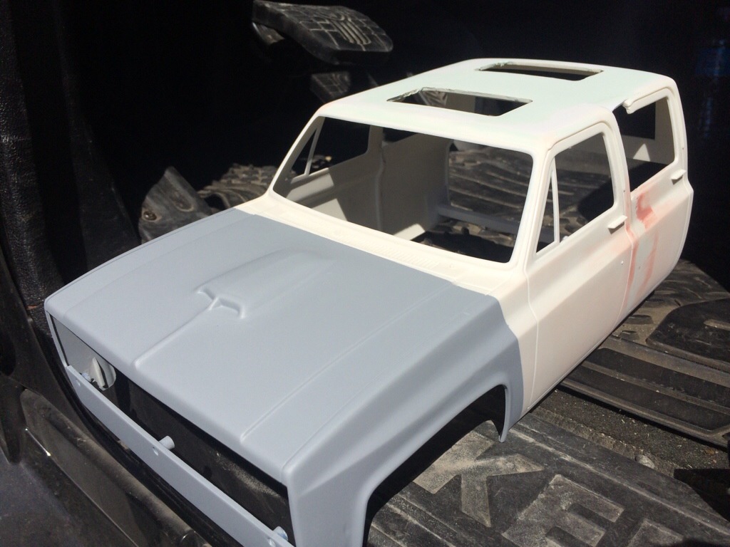

So I'm moving right along with the new cab. I got the cab back done,
, and now I'm working on what to me is the hard part. A friend of mine that builds custom rifles brought up using a newer version of JB Weld.
I sets up quick. It's sand-able. It's bonds very well to plastic. And it's extremely strong! So i decided to give it a try!
. We'll see how it does. I did use it on the cab back around the edges before I put the bondo on. I'm very happy with how it came out!

No, I got that too! LOL! It does take a little more effort to sand it down. If you wait a few minutes for it to get semi hard, then you can use a razor blade to cut through it and shape it a little better before it sets up. That will cut down on sanding time. There are 2 benefits that I see over Bondo for the first coat. The first is obvious, it's a lot stronger. So not only are you filling gaps, and in this case making a shape, but you're also creating a bond. The second is that when sanding it down, it's just as hard to sand as the plastic so once you get down to where it's even with the plastic, they sand down together. In most cases, Bondo sands down easier than the plastic so if you sand too long, then you have a dent in the Bondo that you'll have to fill again. This stuff is not a replacement for Bondo! I only used it for the initial coat! The JB Weld will also not shrink like some of the fillers that are out there when it's painted over!

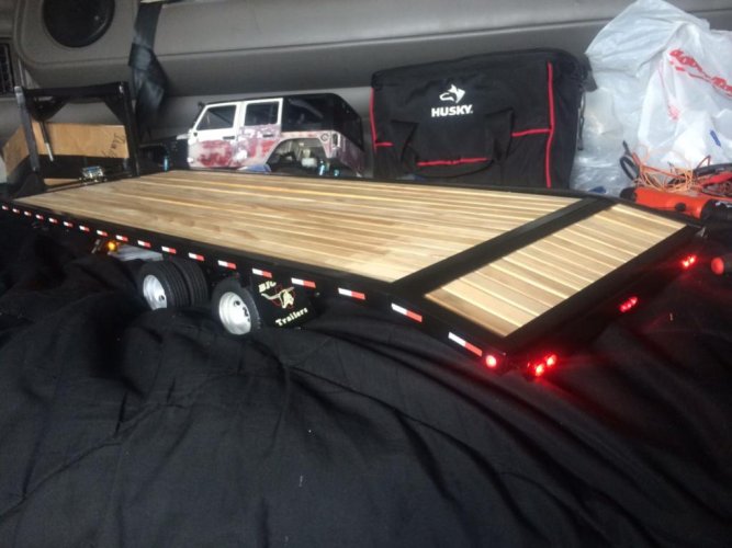

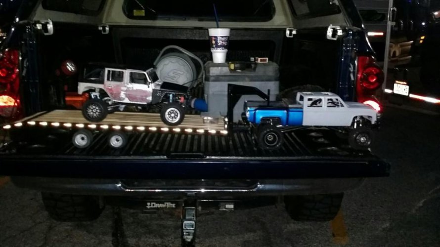

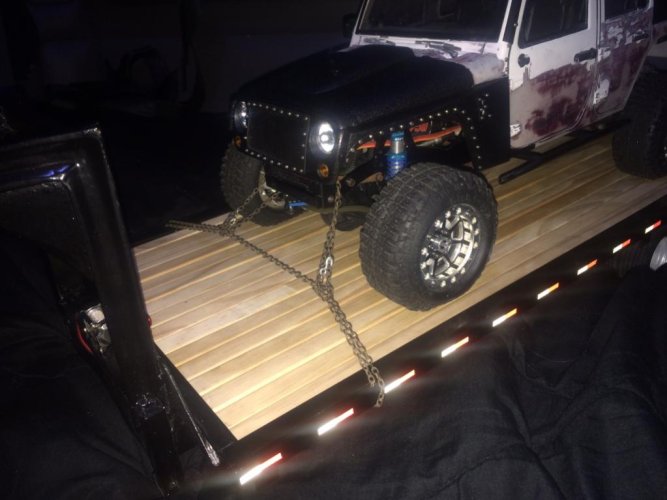

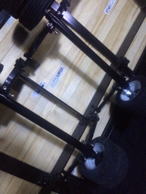

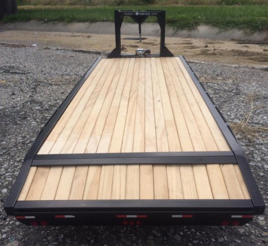

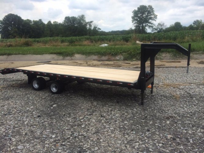

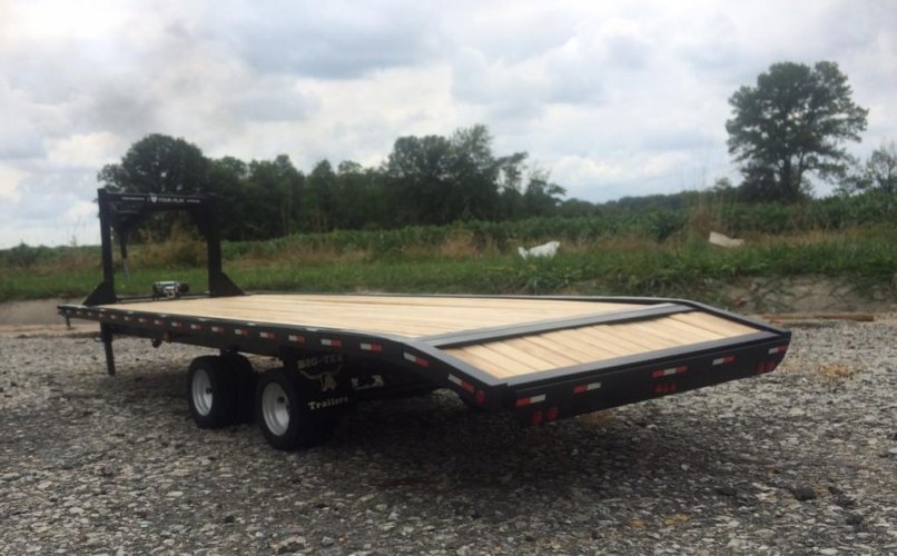

Hey everyone! This isn't really an update on the dually itself. I'll admit, I've gotten sidetracked from it by other projects. This update pertains to something that I've wanted sense I started this build. I finally got my gooseneck trailer! Huge thanks to travis reynolds for the work! He was patient with me and did an outstanding job!!! So here it is!

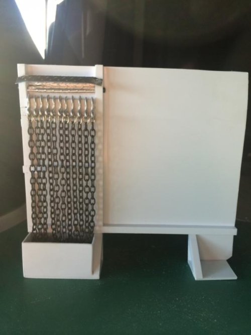

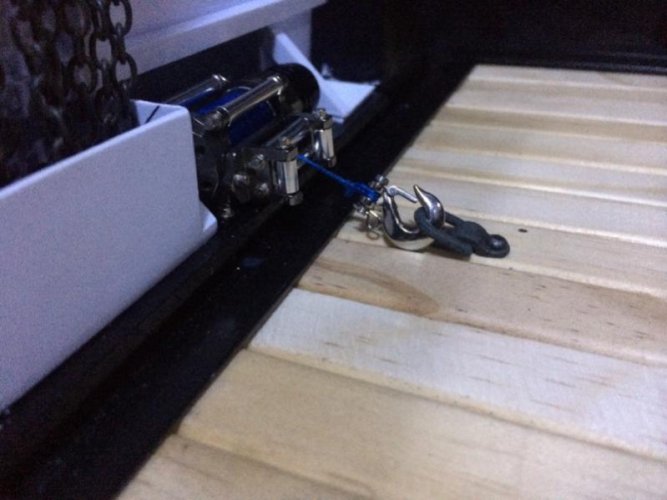

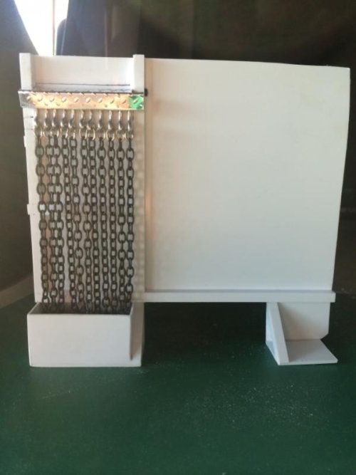

I've been playing around with the gooseneck and adding some details to it, some of which haven't seen done by anyone else. I got all of the lights installed and wired up. The winch and lights run off a battery under the trailer. I want to figure out how to link into the truck though for brake and turn signals without a big group of wires between the two. I have an idea for that when I have some extra time. I've also started on a chain rack. I looked at pics on the net of a bunch of different real ones and then just took it from there. I even made a cover out of scale diamond plate to lock the chains in. I still need to build my chain binders, as seen a while back in this thread, and I will figure out a way to hang them on the rack as well. I'm thinking I'll paint the rack black and I'll have some more of the diamond plate as accent.
