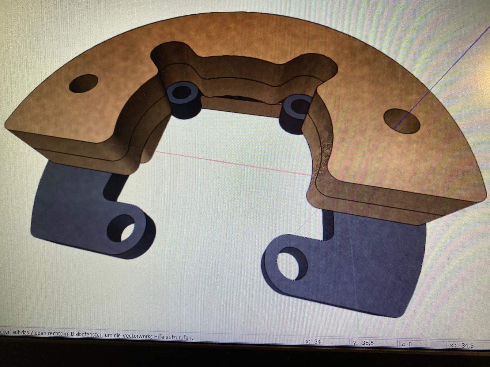

i ordered the new savöx servo with 8.4V and 50kg steering power
i will build a plate from 2.5mm carbon for this strong servo
