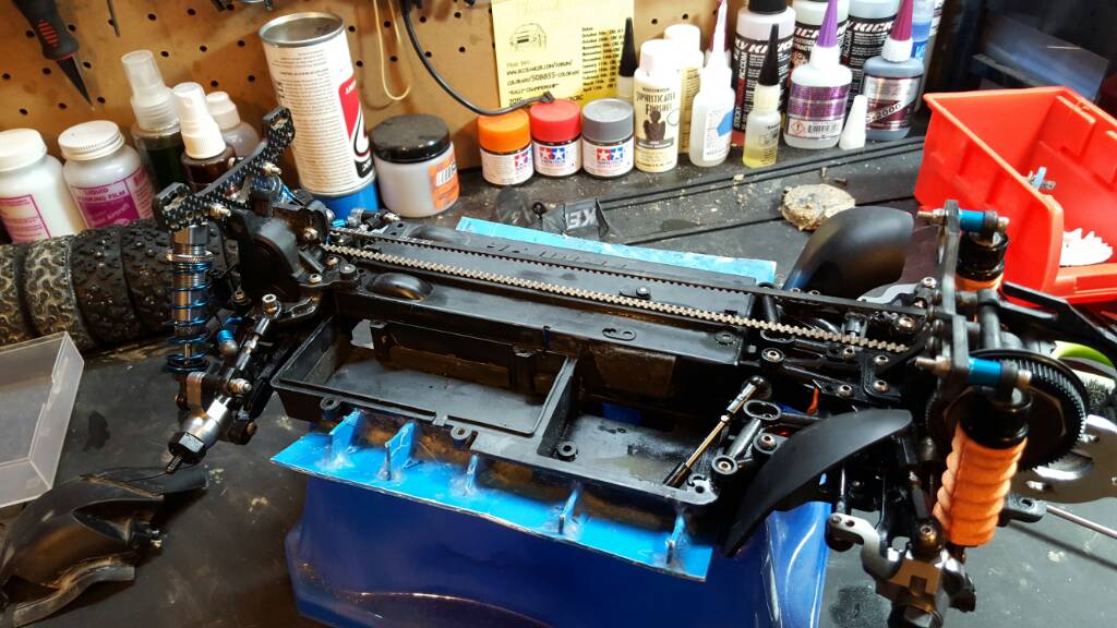

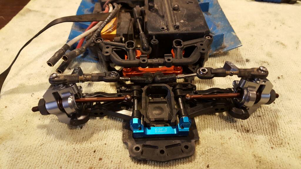

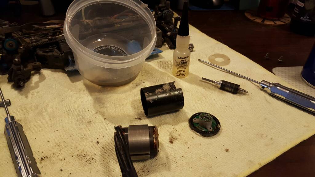

Rebuilt my motor. I've been running this Holmes motor for a while and I'm happy with it.
The first race is tomorrow... I did what I could to get the car fresh.
new belt
new holmes 3300kv sensored WP motor (something isn't right with the motor I rebuilt... It's always nice to have a spare!)
new savox 1257 servo (replacing the original servo)

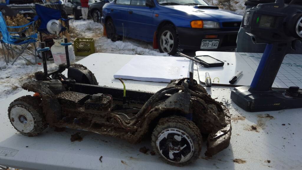

Today was the 3rd race of the season...

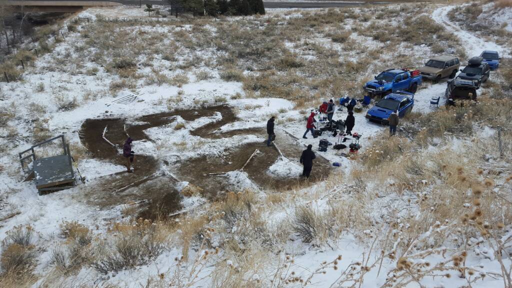

This is our new track... It's above the old Hoon470 track.

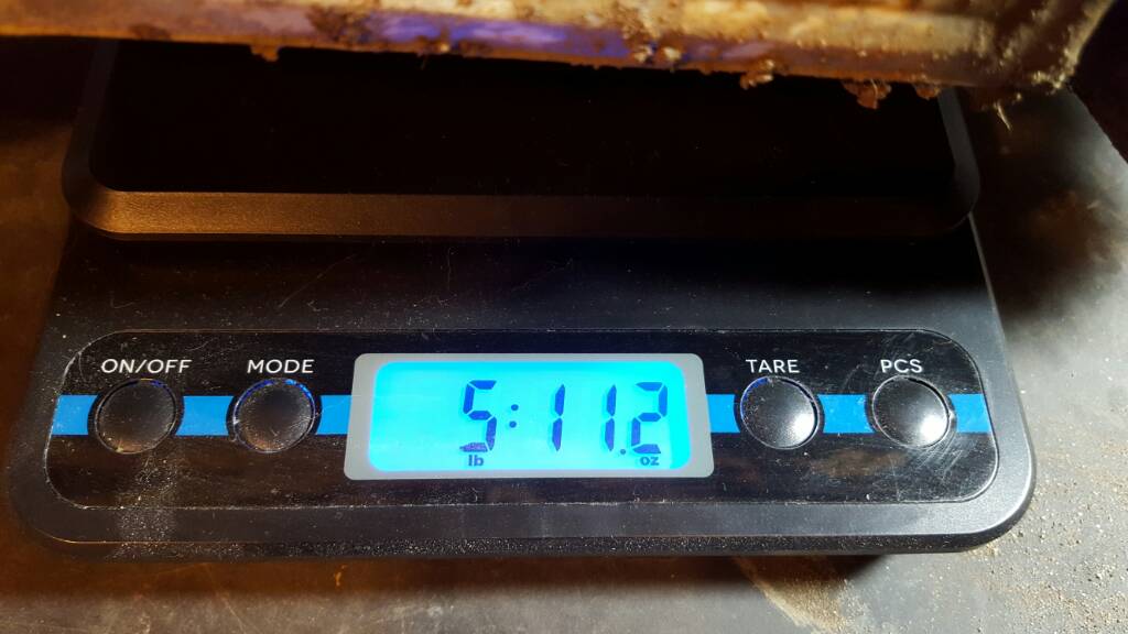

Weighing in after the 3rd race...

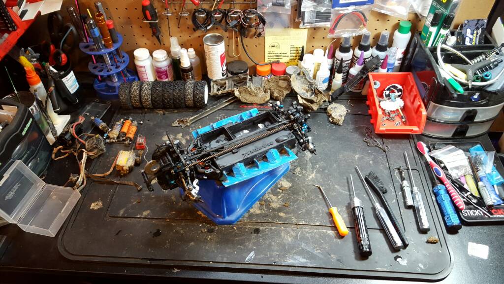

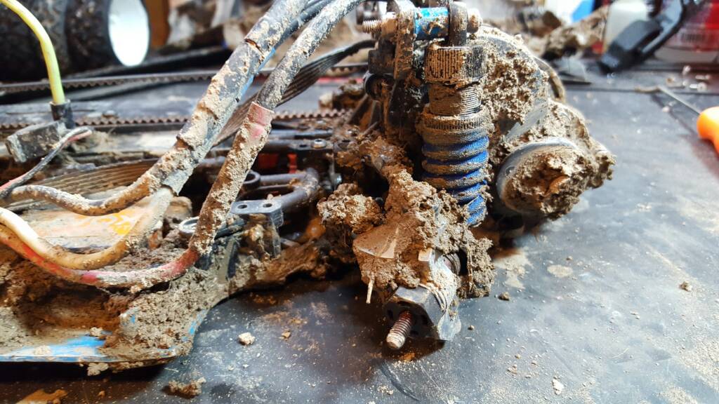

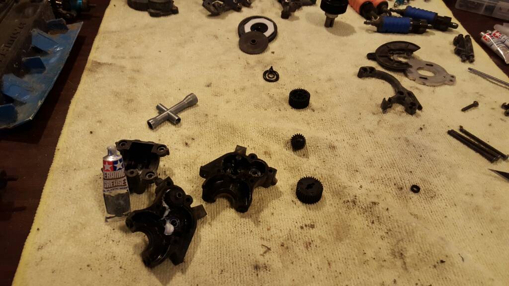

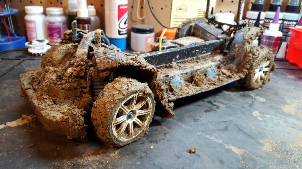

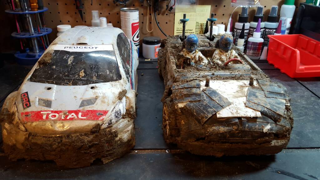

So do you do a complete disassemble and clean each time it gets that dirty (eg post 192-193)? What do you clean it with? Just water?
If it's dirty enough, I do tear it apart. Sometimes though I just pull the electronics, take some of the chassis apart, then give it a bath and dry in front of the fireplace. I often use a spray can of wd40. Usually before events (a couple days before) I lube all the ball ends/hinges/etc with banana lube (nothing special, just what I have around). In the winter months I tend to rebuild a lot more than in the summer.
