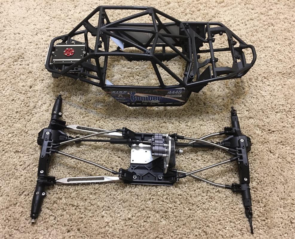

Currently doing a custom build and need some help with my setup. Running a SCX 3 gear transmission with 56T 32pitch spur. Rear axle 43/13 diff gears and Front axle 36/14 diff gears. What size pinion/brushed/brushless motor options would be the most beneficial to keep motor temps down with this setup. I am set on using a Holmes Hobbies motor with a Hobbywing 1080 if brushed or a Mamba X if brushless in this build. Using a bomber chassis/AR60 axles this will be more of a go fast fun rig, with occasional rock crawling as well. Thanks in advance for any help provided.

Thanks for the help so far, tires will be 2.2 in size with stock OEM Bomber wheels for now. Not stuck on the 56T spur but I’ve already got the 56T spur from Robinson Racing which is the slipper setup made for the Slash. Transmission is built with SuperShafty parts and Incision gears. If its beneficial to change to another size spur gear for current setup I’ll get another. Pic below is what I’ve got so far, parts just mocked up right now. Weight I’m guessing maybe 7-8lbs with battery. Motor I want to use if brushless is the puller pro 2700kv standard when I can find one, or if brushed the 21T Torque Master Expert. Just don’t want to end up burning motors if gearing ain’t where it should be to keep temps. normal. Will be using 3s or 4s lipo for battery pack.
