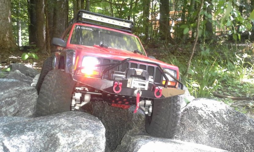

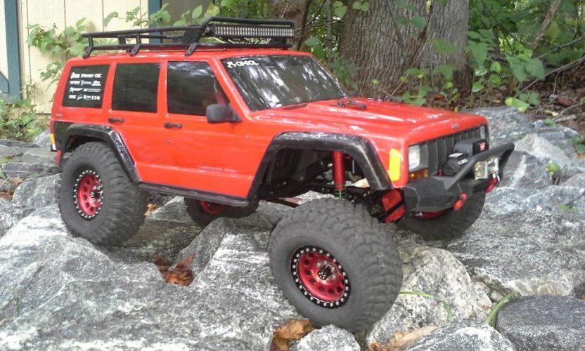

I'm running a axial jeep Cherokee body on mine only thing needed was the taller body mounts for the rear. I also have the bowhouse battery tray so turned mount around and moved holes for rear mount back. If interested you can pm me or text me at 5308643863 for pictures ect
I also have the Axial Jeep Cherokee body on one of my TRX4s and it is a very nice fit and requires surprisingly little modification. If you want a 69 Blazer body Traxxas is due to release a new body 69 and 72 Chevy Blazer versions in August.
