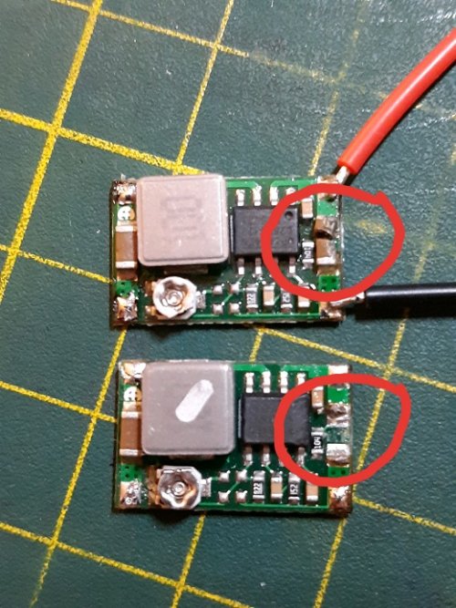

Yes, the BEC is cheap so I don't expect perfect performance. On the one I'm currently using, I'll check the voltage output periodically to see if it remains stable. I'm sure that there is a better micro BEC option out there but it seems hard to find. If I find one the same size, but has better quality, I'll buy it and give it a try.
Right, you must check the voltage prior to use! When I first checked mine it was set to around 3v but yes, I think it could be set higher from the factory and, as you say, could be dangerous.
Also, something to be aware of is that these mini BEC's come with some defects. Among the ones that I received a few came with resistors that were either missing or broken as shown in the photo. I didn't even notice the defect until after I had applied power so do be careful.

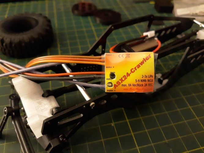

Arrived in TEN days from Germany. Amazing!

I am very interested to try out the ASX24-Crawler esc on the SCX24 that I will be putting together for the wife.
So far, my Tegu's will all be powering brushless, but none of them are up and running yet, so I cannot give my thoughts yet.
Honestly:
You won't feel a big difference to the Tegu with brushed motor during driving.
But: See my last posting ;-)
What I really like in the ASX24: It fits perfectly under the electronics-tray; perfect place to mount, even if you use stock-SCX24 electronics (V1 !!!).
Walter
Honestly:
