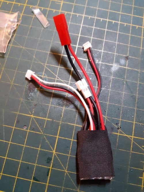

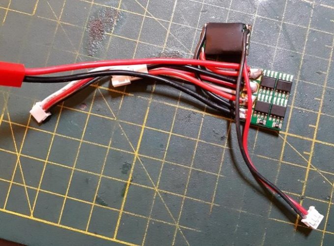

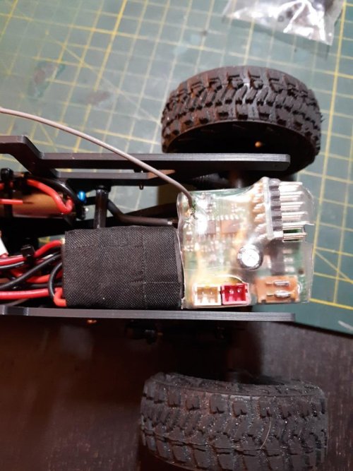

Walter, thank you for the detailed analysis of this "awesome" ESC! I hooked up one of my 6RW's with a BEC and nano receiver to my Warthog build yesterday. I'm very happy so far and I'm definitely looking forward to swapping it out with their new Crawler ESC. Till then I'll be enjoying the 6RW.
Photos of the ESC and BEC bundled together, side by side with a de-cased blue Axial stock ESC, and for scale with a postage stamp on top. (The leads are: ESC, BEC, Motor, and power.)

Good to hear you like it :-)
If you did already hook up the AS12/6 with BEC and like it... not really a big need to change to the new ASX24.
OK, it is a little bit smoother, switches f/r faster, ... but the main advantage for most people (not me - I love soldering ;-) ) is IMO, that it is ready to go, no soldering work necessary, no BEC wiring...
But of course you will/would love the ASX24 even more.
