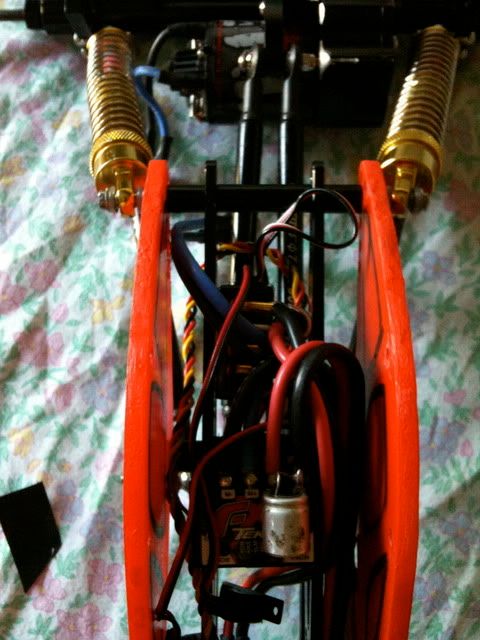

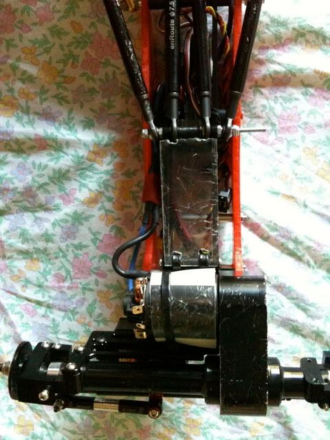

Here it is my idea for the new berg tracer "thumbsup"
2 - Tekin fxr
2 - tekin 45t
radio Spek DX6i
hb Rover and sedona (soft) on enroute wheels v1 (380 gr full weight) soon will make a set of vanquish
running proline dual stage on the rover and nova in the sedona ( proline r really good as soon as the temperature isn't really hot, then become too soft and lost grip, instead the nova's foam that don't change with the temperature
servo hobbico cs 170
lipo 2 s 1800 mAh 40c
I designed the orange chassis and soon will have it laser cutted in a 3mm inox ( in the photo you can see a derlin bad cutted prototyoe :ror:) i designed it to have a servo coverage and soon will make a BTA steering too.
Critics and consideration are really welcome"thumbsup"

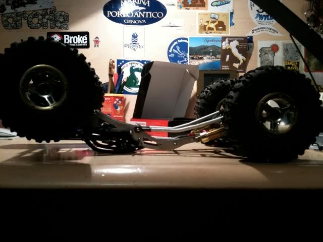

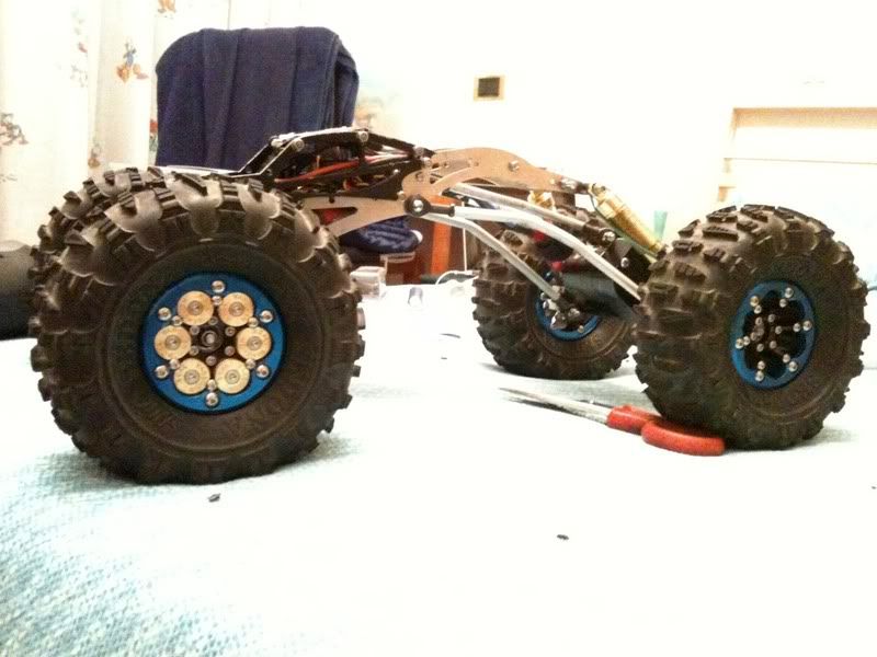

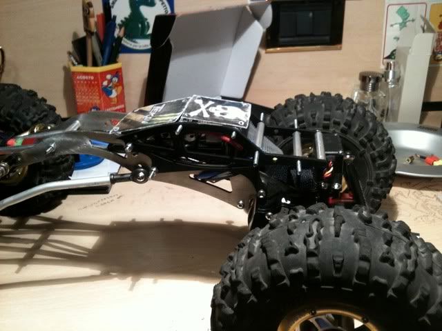

Here there are some photo of the newest mod, the black chassis is a my personal design
wow. crazy looking man. hows it drive?
Well it's a bit difficult to get over some vertical really vertical, but with the right usage of the radio with the mixed channel is really a great model with a 10cm of GC:ror:

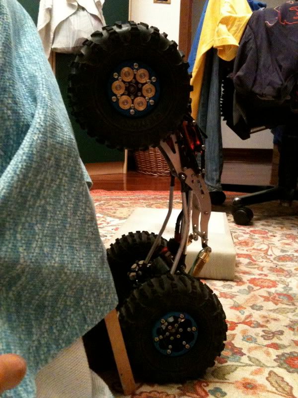

here we go again...... after my 1st comp sunday placed 5th ;-) i got my vanquish awsome rig:twisted:
Some equilibrium exercise for my Berg "thumbsup"
sick looking chassis you built there! I love it
