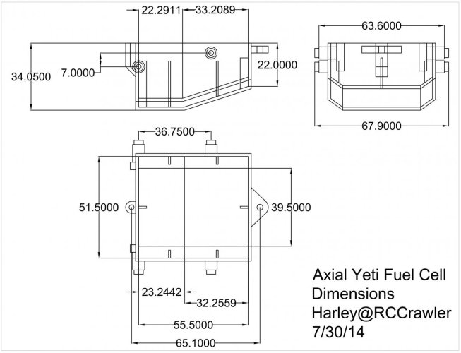

Could someone measure the fuel cell box from the yeti,I was wondering the dimensions of it.
