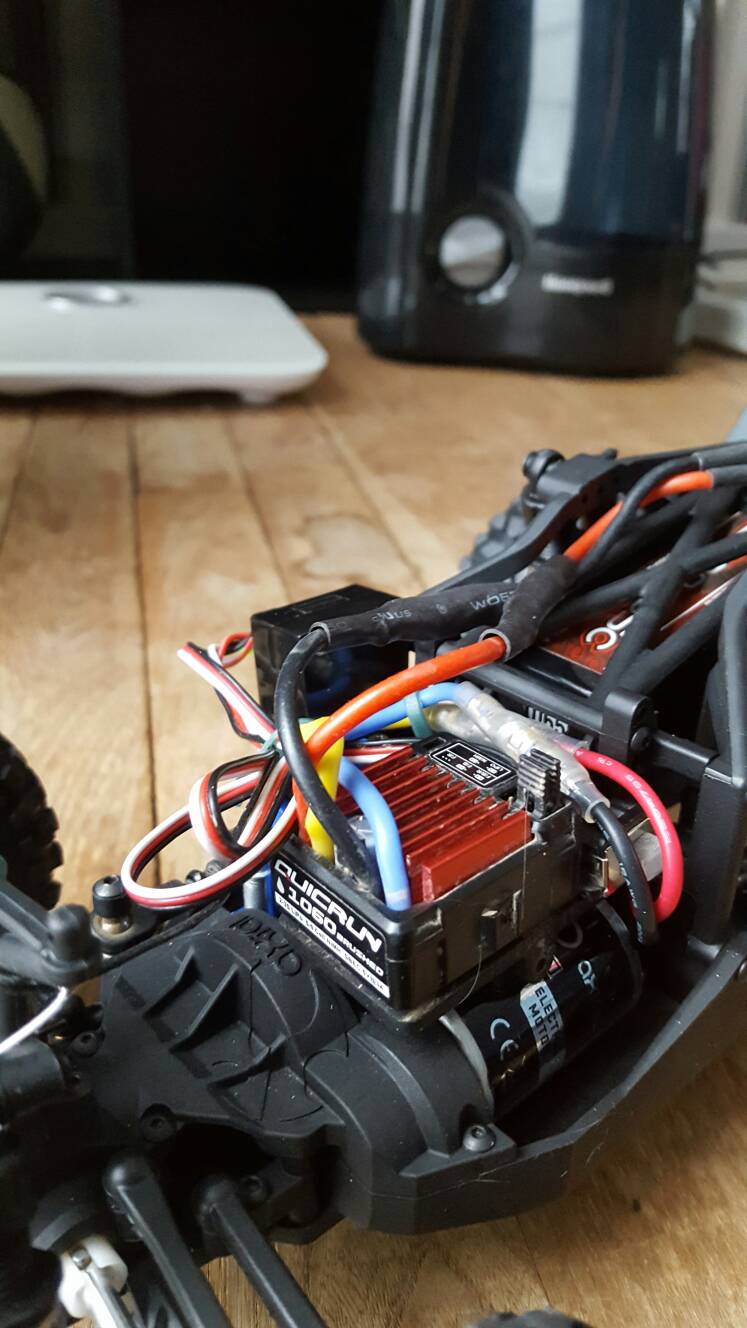

My servo setup ..Up right , works awesome still need to trim power wires cos parts where out of my other truck that now is brushless. Also need a balloon over receiver to waterproof it .
PS run a servo sever ,will fit one later but now I have a clicking noise in the servo after a crash lol but still works way better than not working at all with crap stock electronics.

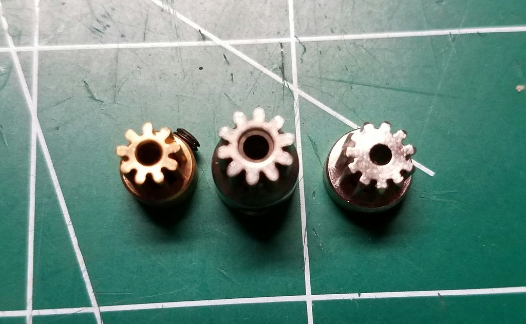

Switched to a spare brushless setup from a losi mini 8. Found a great pinion for 2mm shaft motors- unfortunately it came with a motor, not sure where to get it separately. It's the same pitch as the stock pinion.
It's the 9t on the left. Stock center, the right one is a losi mini .5m pinion.
Here's the motor if anyone is in desperate need for the pinion. The motor might not be bad on the jr, didn't try it though. It's a bit smaller diameter.

I've had that pinion a while, looks like it comes with a 10 and 11t now.
I don't use this for poking around or pseudo-crawling, but jumping stuff and zipping around my track so I'm not concerned about cogging. But it felt great in my basement, not much cog with the 9t pinion.
