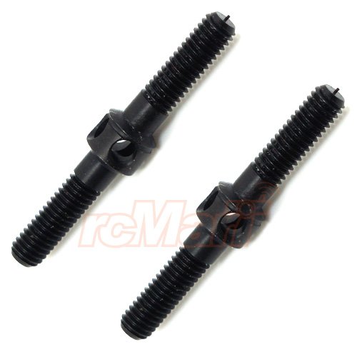

I don't think that is going to work cause of the diameter of the center of the turnbuckle it needs too be thicker than a 3mm tap, plus I only have a cordless drill, no drill press to center and accurately drill the hole correctly
I found these Overdose heavy duty 3mmx30mm turnbuckles with a hole in the center, they might work with what ever threaded rod will fit the hole to attach a ball end so every thing pivots
