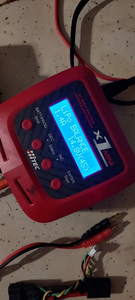

I use the hitec chargers. Ive got 2 of the hitec x1 n they work great. Only reason ive got 2 of the single chargers is i got a good deal on them. Id like to get the hitec x4, then i could charge/discharge/storage 4 at a time. Them my boys could have the ones ive got now.
Ive got multiple connectors for the chargers as well. Deans, xt60, trx, n a jst type (the 2 pin red ends). The plug into the charger with bullet ends. I use the balance connector extensions vs a balance board, so ive got a pile of wires layin close by lol. Ill get u some pics here shortly of wat i use
Heres one of the chargers n the different plugs ive got

The hitex has balance, charge, storage, discharge, n it stays at the same batt setting it was last used for. Or u can set the memory for each battery u have n just flip thru them.
I think the hitec is also ac/dc capable, just needs the dc adapter for it

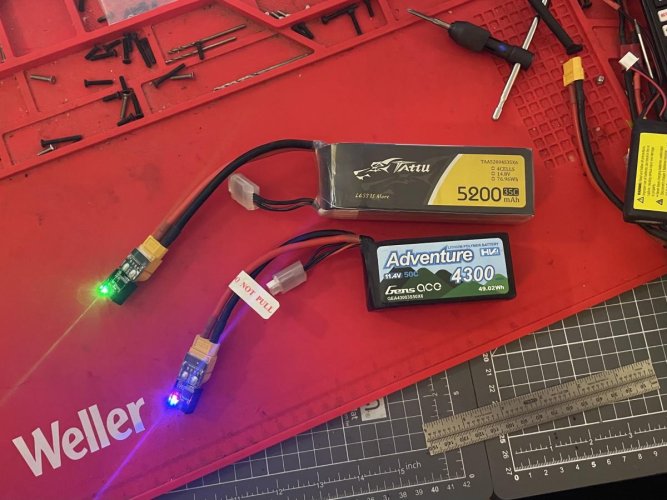

It looks very rudimentary. Do these have a safe cut off to prevent over discharging? If so I'm in!
Sent from my SM-N986U using Tapatalk
Yeah, they cut off at ~60%.
They sense the voltage (green for 4s and blue/red for 3s in this case), and adjust the discharge rate to be as fast as safely possible. The heat sinks never get more than warm to the touch. They can explain how it works better than me...
"With the advanced algorithm and built-in temperature sensor, VIFLY StoreSafe lipo battery discharger can intelligently adjust the discharge speed according to the battery voltage and unit temperature. It ensures the highest discharge rate in an appropriate temperature range."
Plus, you can leave it plugged in and it won't over-discharge (which is important for my forgetful ass)...
"The StoreSafe will stop discharging when your battery reaches storage voltage and then goes into an ultra-low leakage current so the unit can be left for long time without over-discharging the battery. Just plug in and leave it alone."
