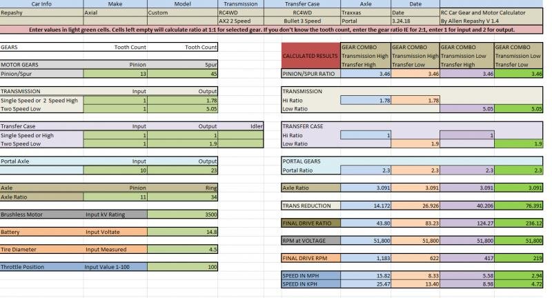

I have made a bunch of upgrades to the calculator to accommodate most any crawler setup.
2 speed Transmission
2 speed Transfer Case
Portal gears
Input the gear tooth counts or gear ratio and it will calculate all possible shift combinations available.
I would enjoy some feedback and feature requests.

Here is a mockup build showing the potential with a 2 speed transmission, 2 speed transfer case, and portal reduction axles.

I created a side by side comparison version of what I am calling the "RC Drivetrain Configurator" and think it is a much more valuable tool than the original version so I will continue to develop this version.
I have added a bunch of calculations that show differential factors and change percentages, as well as a visual check to see what values are different in your sheet. Here is a screenshot of the new configurator comparing a Bomber with differences in pinion and motor kV that result in a similar top speed.
