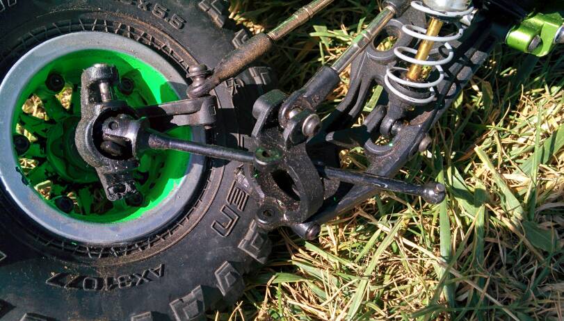

took the little monster on vacation, 2 weeks test driving on great locations.
But it was over after 3 days
First day, i had a light slide on a wall, the rear upper link broke at the axle ballpoint.
to continue my test drives i use superglue for repair, don't do this....
it holts up for a little time, but unfortunatly it broke again on high speed. and cause of this the right front hit a wooden pole. here is the result....
cause of my hinge pin mod, the weekest part gave up the steering knuckle broke. so no more test drives.
ordered Vanquish titanium rear upper links, vanquish steering knuckle and as a goodie front shock tower from vanquish.
i have now installed in the rear
ssd diamond wide axle, vanquish rear upper links, trailing armes are still kit version with plates.
i have ssd trailing arms on the way cause i bet this will the next part breaking
i choose the ssd cause they use rod ends which are easy to repair.
front still stock instead of the new steering knuckles
took a few packs during the weekend threw, and [emoji3] nothing break [emoji106]
