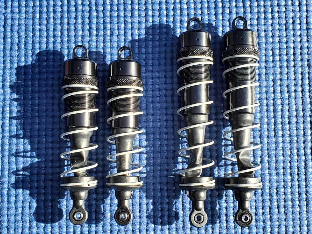

They went together fairly easily, and are built in the same manner as almost all other shocks...with one noticable difference - instead of using C-clips to hold the pistons to the shafts, they use 3mm Nylock nuts. Also, these are bladder-style shocks, but you don't seat the bladder onto the top of the shock body, and then screw the cap on...you press the bladder all the way into the shock cap, and then screw it onto the body (personally, I prefer bleeder-style caps, but I haven't been able to find any that fit the JQRacing shock bodies...but, more on this in a sec).
As I mentioned, I prefer bleeder-style caps, so I ordered Associated 16mm bleeder caps from Amain. However, when I attempted to screw them into the shock bodies, I discovered a serious problem - the diameter of the threads on the caps were larger (by approx 1mm) than the diameter of the threads on the shock bodies. Unless I'm able to find bleeder caps that fit the JQRacing shock bodies, I'll have no choice but to use the JQRacing caps & bladders (yes, you're allowed to laugh at "caps & bladders"). So...if anyone happens to be familiar with the JQRacing shocks, and knows of any (preferably aluminum) bleeder-style caps that will fit, I'd GREATLY appreciate hearing from you.
Having completed this shock-ing experience (tho, I have yet to fill them with oil, as I'm currently undecided on oil weight), here's what they look like:
These are 16mm (ie. the internal diameter of the shock body) shocks...but, as you might have realized, they are a bit longer than your typical 1/8 buggy shocks. In contacting JQRacing, they have me two reasons behind this...although they don't include any parts to "back up" the first reason.
For reason #1, there's two parts. First, they suggest/recommend adding limiters to the inside, which, in turn, shortens the extended length of the shock...but, they neither include any limiters, not do they provide any suggestions as to how much to limit the shocks. As they put it, "We leave the amount of limiting the shock to the individual, as each person may want to limit their shocks to a greater, or lesser amount." This does explain why they don't include any suggestions as or even a 'starting point'...but it doesn't explain why they don't include any limiters in the packaging. Second, it moves the piston upward from the bottom of the shock body, so that, when there's wick compression, there's no 'suction' trying to hold the piston down, as there's already a small amount if oil below the piston. Now that I'm adding crawlers to my collection, I can say that the first reason does make sense...based on others on the crawling side of this hobby, I've done this to the first two crawlers I've built (did I forget to mention I've already built a second? It's an SSD Trail King Pro).
As for reason #2, this is a bit more "interesting". Evidently, they also rate their springs slightly differently...they still use 'soft', 'medium', and 'hard', like everyone else, but all are softer than others' with the same "strength name". Additionally, when installed on the vehicle (including their own vehicles), the shocks are expected to be compressed slightly more than other shocks, which, in effect, "increases" the stiffness of the shocks...but, at the same time, allows full-extension much easier, and more smoothly, than "traditional" shock design. I guess, a better way of putting it is that their 'soft' is like 'extra soft', their 'medium' is like 'soft', and their 'hard' is like 'medium' (competitive buggies, evidently, have no need for TRUE 'hard' springs springs)...thus, once compressed, the 'soft' is actually soft, the 'medium' is actually medium, and the 'hard' is actually hard. Does this make sense to everyone reading this? If so, great...and, if not, go back to the beginning of the paragraph, and read it again. Just so you can see the difference in extended lengths, I've placed the stock Rustler shocks next to the new JQRacing shocks:

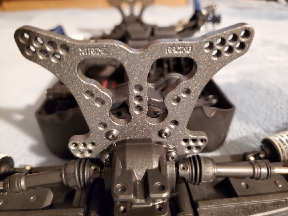

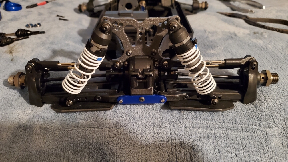

If you look closely, you'll notice that these towers provide 7...yes, I said 7...shock mounting positions for the front, and an even more amazing 9 positions for the rear (it needs to be noted that 2 of those rear positions are somewhat lower that the others, and would require shorter (ie. front) shocks to be used. I won't be using Threadlocker on the shock mounts until it's determined which holes will be filled (no, not THOSE holes...the holes in the shock towers...get your minds out of the gutter).

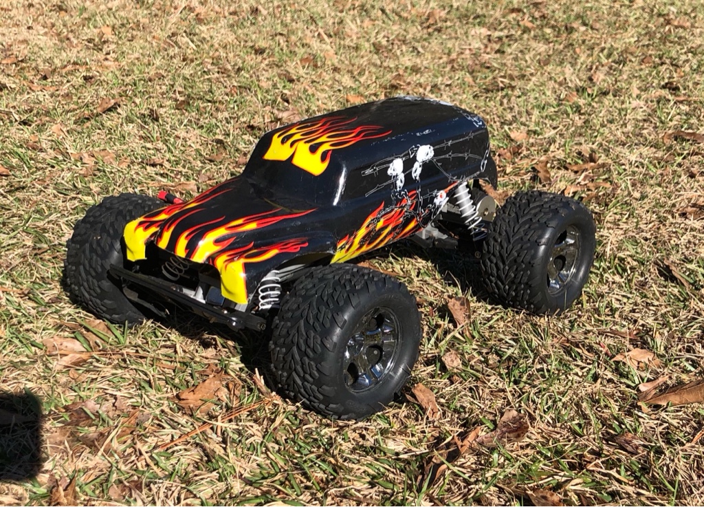

I bought a 2wd Stampede slider off of fleaBay a while back. Happened across a set of Stampede-ish wheels and a Chinese Grave Digger body. Put a 3660 2600kv sensorless motor on 3s and this thing really moves.
For the price point, these sliders are a good deal if you’re like minded with boxes of spares pulled from everything else. I’m thinking of doing some sort low slung Rustler/Jato/Slash parking lot basher on foam tires next.

Before I get into today's installment, I should mention something I forgot from the previous installment...the Traxxas aluminum C-hubs & rear carriers.
These are carry-overs from my Rusty-Frankie project. To get rid of the 15mm axle extenders I was using (because of the 2.2" wheels), in order to still use the same wheels, I replaced the C-hubs, steering blocks, & rear carriers, with 4Tec 2.0 parts. Thus, the aluminum C-hubs & rear carriers were free to jump ship...and they happened to land on a Predator. Just, don't tell Arnold.

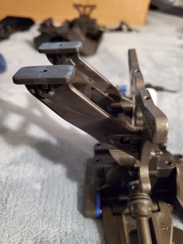

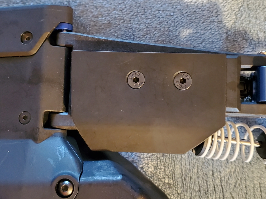

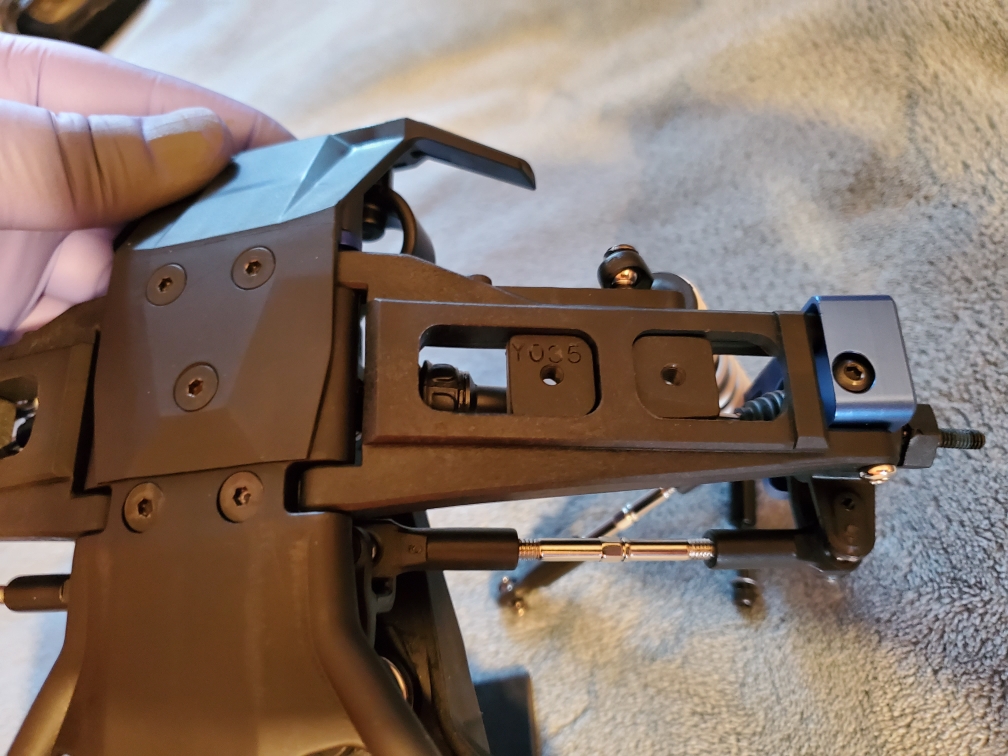

Next up...something to protect the underside of the A-arms (after all, you know how rough those aliens can be on their vehicles), in the form of some A-arm skids from TBR (that's 'T-Bone Racing, for those who might be wondering, who also provided the chassis skid on Frankie).
Technically, these are for the Slash 4x4...but, as with most Traxxas vehicles, almost anything designed for one vehicle can be used on certain other vehicles. I did have to make one minor modification. If you look at the two pieces for the rear, you'll notice I cut off the inner corners. This is so they don't hit the chassis just in front of the rear bulkhead.
To install, you first insert a rectangular piece over the middle A-arm crossbars, and then attach each skid using two flathead screws (included in the package).
Once installed, they look like this:
Honestly, kit-bashing is not only loads of fun, but can produce incredibly-rewarding (or completely disastrous...lol...yes, I've had a few) results. I first started kit-bashing, with plastic model, about 40 years ago. One of my most "interesting" was taking 4 different space ship models, and turning them into one larger space ship. I can't remember what all four were, but I do remember one of them was the lander from the TV show 'Space: 1999". Unfortunately, I never got to do my "dream" kit-bash: buying 2 large-scale Lamborghini Countach models, and turning them into a 4-door stretch Lambo limo.

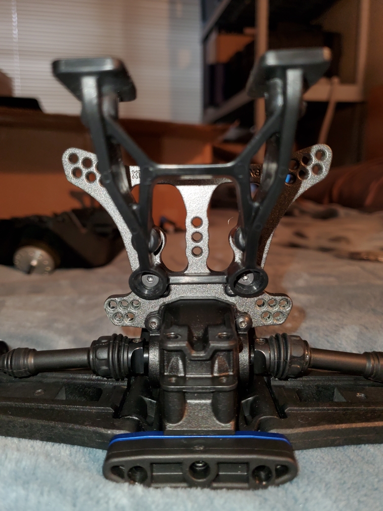

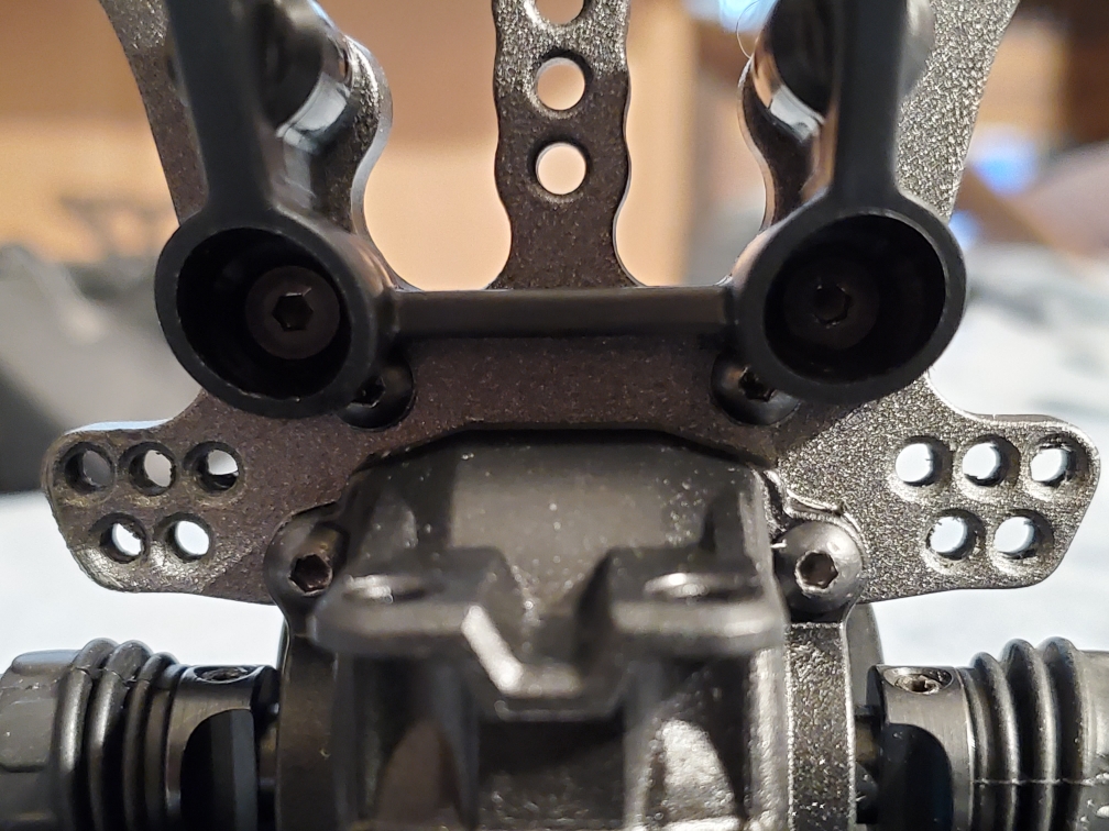

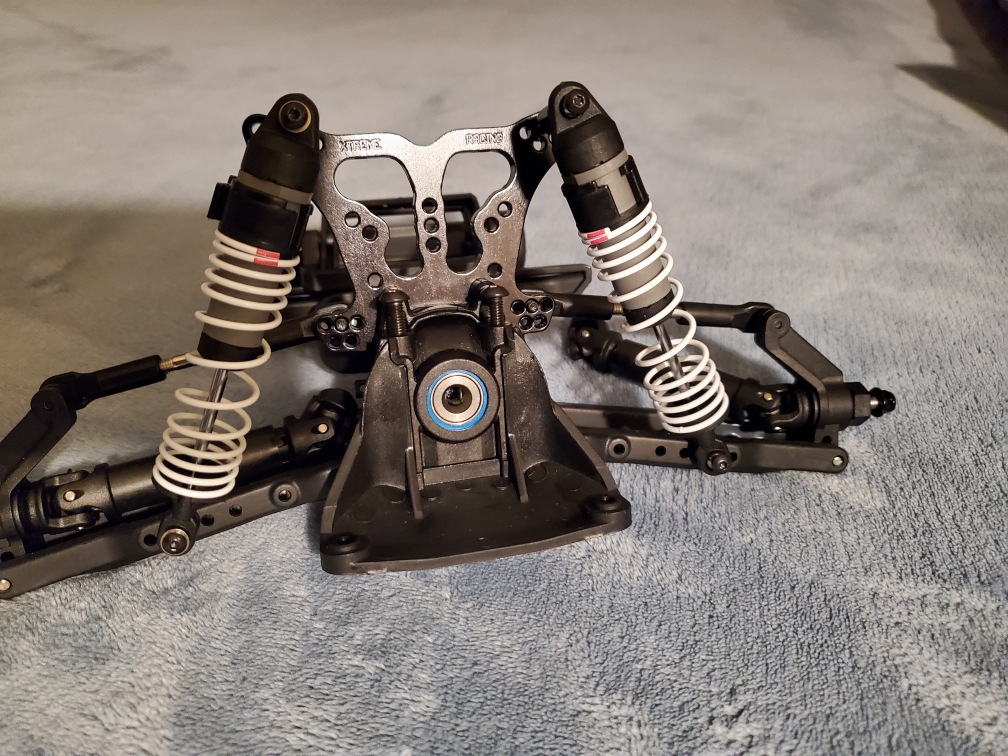

All joking aside, today started off with something fairly simple...reattaching the shock towers. This should have taken all of 1-2 minutes, but ended up taking several times longer...because I'd forgotten where I put the screws. So, actual install time was closer to 10 minutes - 8 minutes to find the screws, less than 2 minutes to screw them in.
Note to myself: In the future, remember where you put things.
Now, where was I? Oh, yes, the shock towers. Seeing how they look, color ideas for the rest of the vehicle are starting to converge. Next up was to install the wing mount, which repaired removal the rear bulkhead from the chassis. While the top screws screw (say that 10x fast) in from the front, into locknuts placed inside the wing mount, the bottom screws must go through the wing mount, through the shock tower, and into a couple of locknuts. Unfortunately, when I first attempted to install the wing, I realized that the spur gear cover was preventing the nut driver from reaching the holes the screws were sticking through. Thus, I said, "Off with the (bulk)head."
Of course, then I ran into my next 'problem' - the screws for installing the wing mount...or, to be more specific, the lengths of the screws. After some attempted measurements, and the few "false" lengths, I finally determined that I needed 14mm buttonhead screws for the top, and 12mn flat head screws for the bottom (plus the aforementioned locknuts). Looking at these two photos, you might have an idea of how difficult (or impossible) it would have been too install the wing mount without first removing the rear bulkhead from the chassis.
Since we're doing a bit of a 'lineup', here's a side profile view:

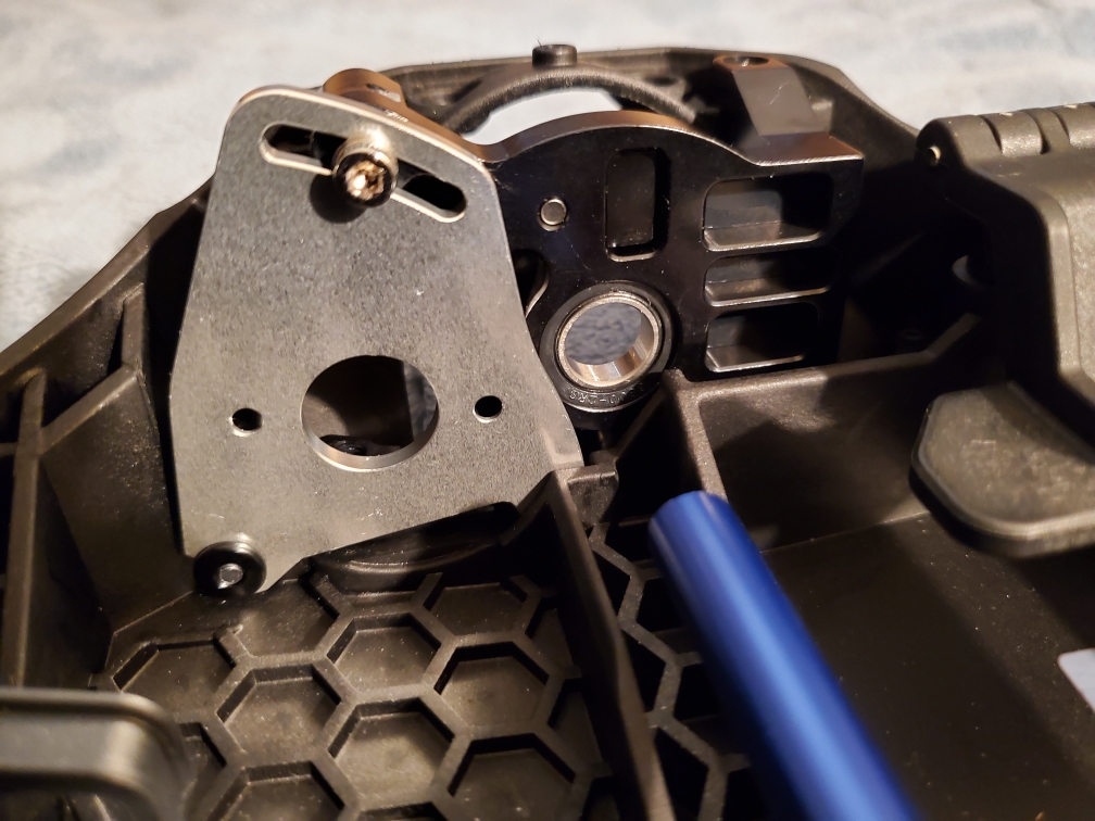

Since I had the rear bulkhead removed, I figured I might as well install the new Hot Racing motor plate & King Headz motor mount. Undo a screw here, a few screws there, inserts a bearing, in reverse the two previous steps, and the task was accomplished.

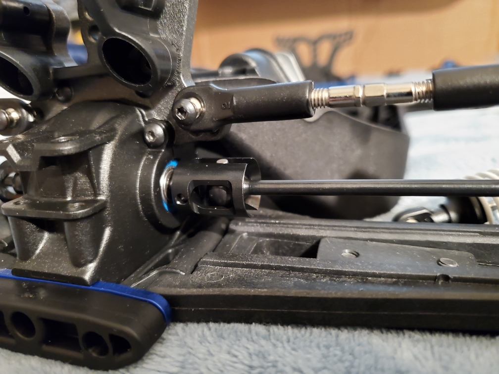

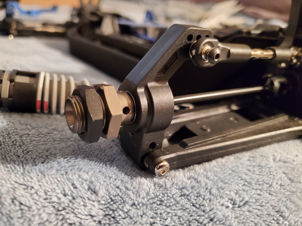

Finally, it was time to work on what I really intended to get done today - installing the Tekno M6 driveshafts, and 17mm hex adapters.
Both ends are extremely easy to install, but, the front can be a bit time consuming. Doing things out-of-order, as I'm quite good at that, I decided to start with the rear, and work my way forward. From start to finish, I probably had the rear end complete in about 10 minutes.
Moving to the front, things would have proceeded quicker, except that I had a last-minute change of plans - I decided to remove the aluminum C-hubs, and replace them with the original plastic parts. This meant pulling down my Slash roller, and swapping some parts. Had it not been for this change, I could have left the C-hubs attached to the A-Arms. With one other exception, the front could have gone together almost as quickly as the rear.
Unlike the stock Traxxas steering blocks, the Tekno steering blocks have wider "arms" where the steering links attached. Tekno includes shims (3 for each side) to fill the gap, as well as longer screws. The instructions say to place all 3 shims on top of the steering link. Unfortunately, accomplishing this proved more difficult then I'd expected. In the end, I had 2 shims on top of the steering link, and 1 below. Honestly, I don't think this will cause any problems.
