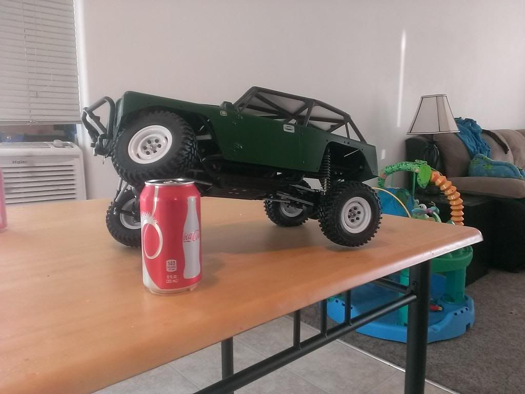

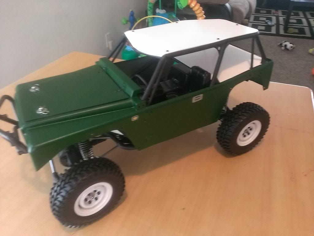

So what would u suggest running for my 1.9 wraith it weighs about 7.5 lbs and has 11.25" WB I'm running a panhard with cms up front and 4 link in the rear right now it has 1.9 rc4wd mud thrasher tires and the foams they came with on gmade vr01 beadlock wheels the 1" width should b fine but my tires only have about 3.85" OD and are about 1.5" W what do y suggest I get here are some pics for reference of my rig
I do not make a foam that short. Sorry. The public demand has been for bigger tires and foams for them.
