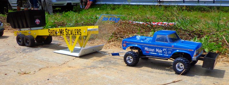

Here's a shot of the truck posing with my sled.
As for the weight, I have a cut & rounded block of steel that weighs just over 2lbs and fits great in the box. With battery and weights, the truck weighs right at 7.98 lbs
