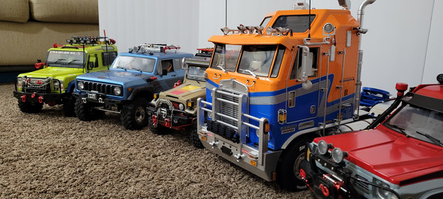

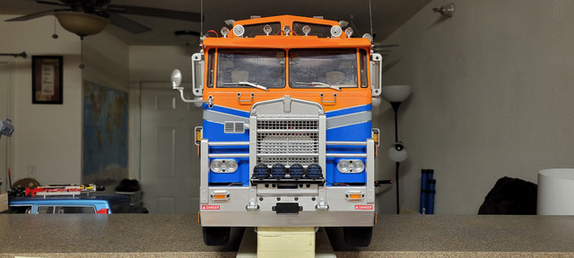

This is turning out to be a beautiful rig. Looks like a professionally made injection molded let.
Nice work! Keep up the amazing work.
Sent from my LM-V600 using Tapatalk
@ smc-93 and durok...thank you guys, im just so relieved to finally finish this build coz im already itching to start the next one....but i still need to paint the trailer...and another 4 wheel build....by the way, i only used acrylic paints from michaels/hobby lobby using an airbrush and finish it off with a couple coats of rustoleum gloss clear...stripes are vinyl sheets...and...finally, here she is...
